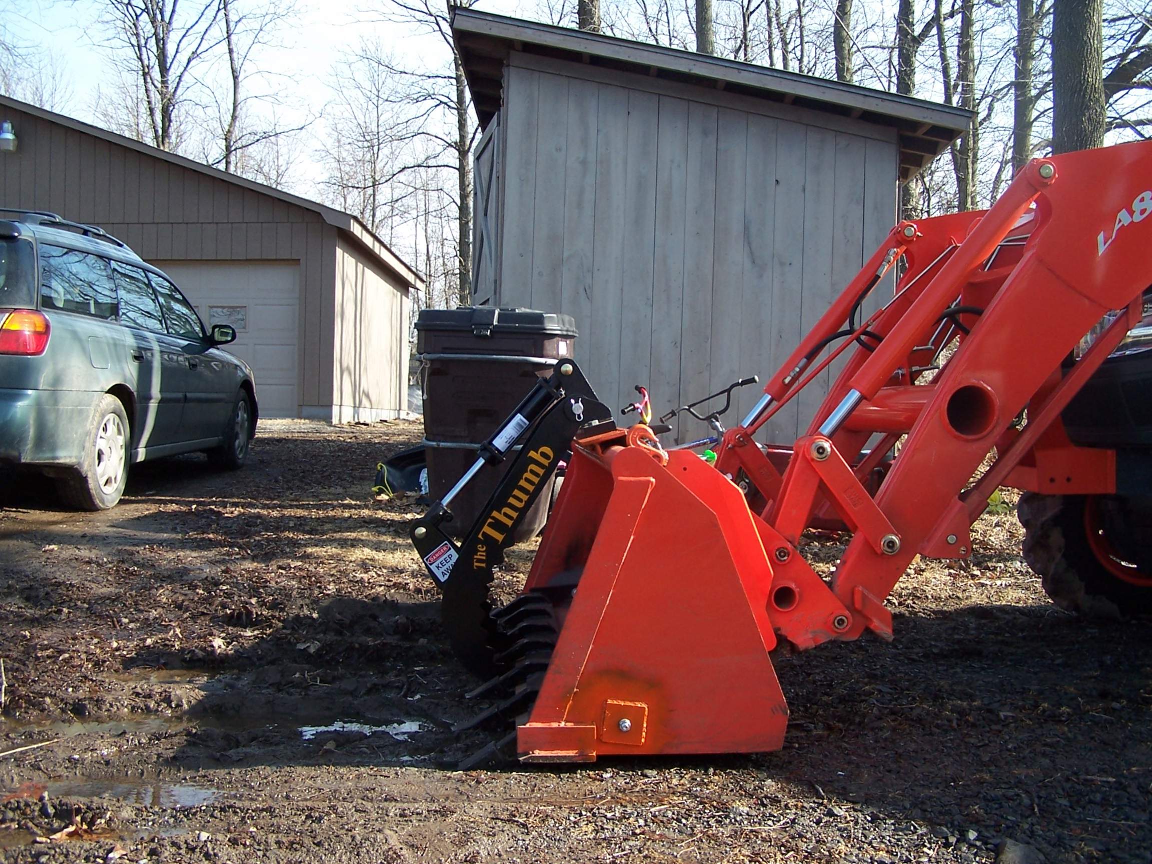

Looking for advice on a grapple bucket for kubota L3940 bucket is LA724. Thinking of W R Long. Need something sturdy will use for moving rocks (some pretty large) and moving log lengths to our bandsaw mill out back of the house. Am new to writing but have been reading for 2-3 years and gotten good info. ty

Check out the "Green's Machine Thumb",that with a tooth-bar works for me.By all means use the W.R.Long third function valve.Stay away from the Kubota factory valve.They have a problem with it,several threads here about this valve.
   / Looking for a good grapple bucket suggestion for a Kubota L3940. #3
Picture of mine.Saves some weight compared to a full grapple.
