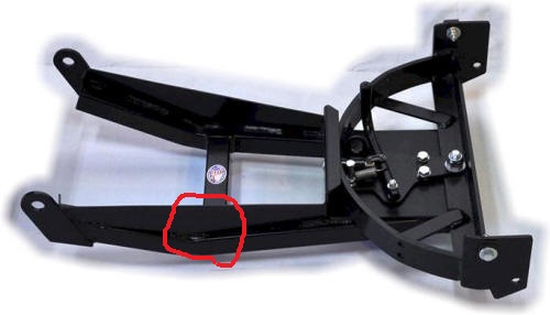

It's an Eagle V plow in this video...their big weakness is the push frame...my RTV 500 didn't have any problems with it but the Gator is so much heavier and pushes so much more weight that I bent 2 push frames last winter....I got tired of buying new ones and ran it bent to finish the season.

Thanks for the video and information...definitely about the pusher frame of the Eagle. Did it bend at the same place both times? And, if so, where? If I got with the the Eagle system, I could beef up the pusher frame.

Each time it bent in the area circled in red
