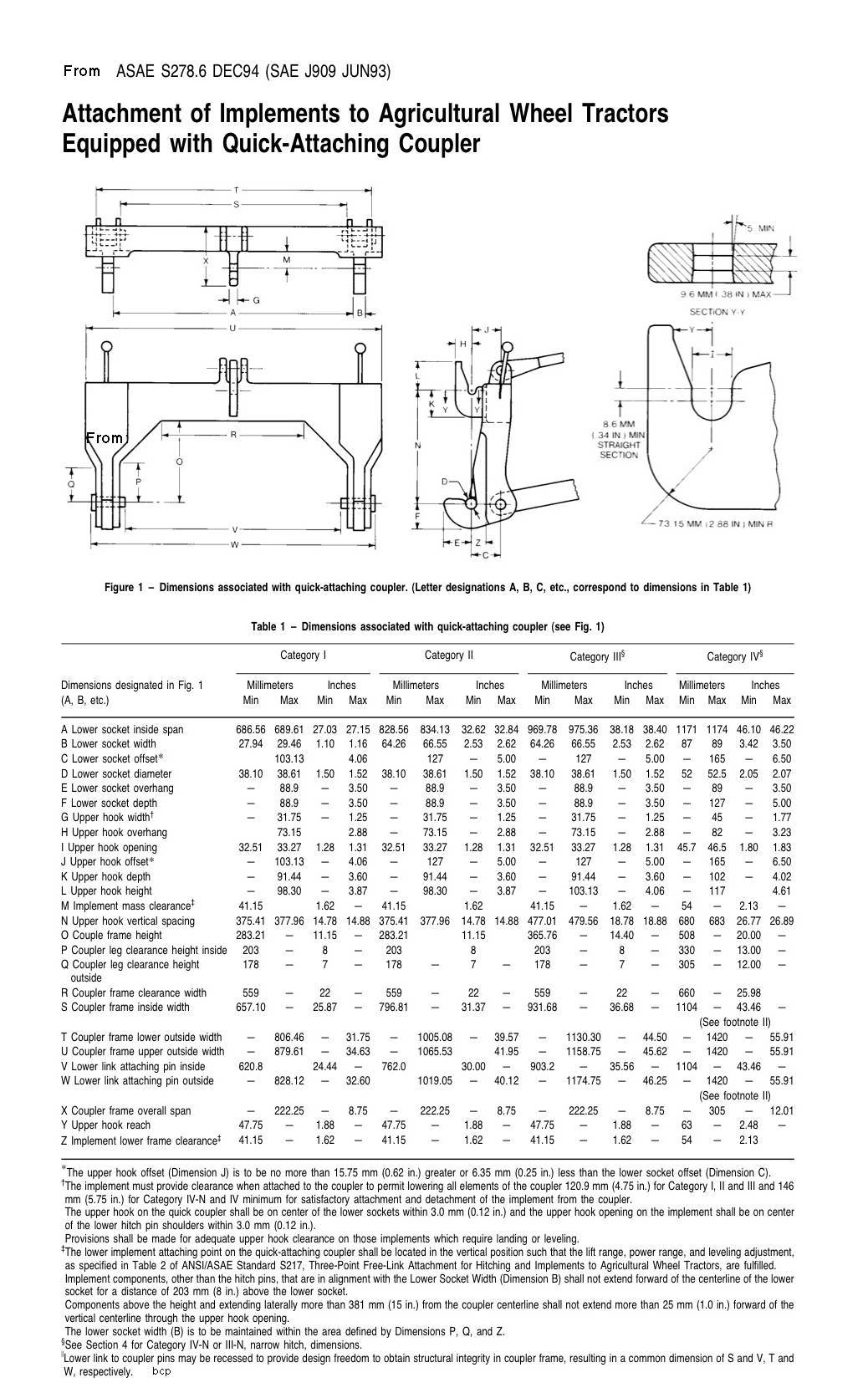

Cat 2 quick hitch hooks are about 5 1/2 inches farther apart than Cat 1.

Cat 2 quick hitch hooks are about 5 1/2 inches farther apart than Cat 1.View attachment 690744
Bruce
Ok, I understand this. My tractor has a Cat II/I 3-point hitch. The lower balls are Cat II sized and the arms are adjustable in width to do Cat I or Cat II implements. They also extend a couple inches for easier hitching, but that's a different story. Do I go with a Cat I or Cat II style quick hitch is the question.

If you expect to be using Cat 1 implements, you should plan on a Cat 1 QH. However, you have to be sure that it will attach to the tractor 3 PH. I've heard of some folks having a problem with the lift arm balls not fitting into the QH.
