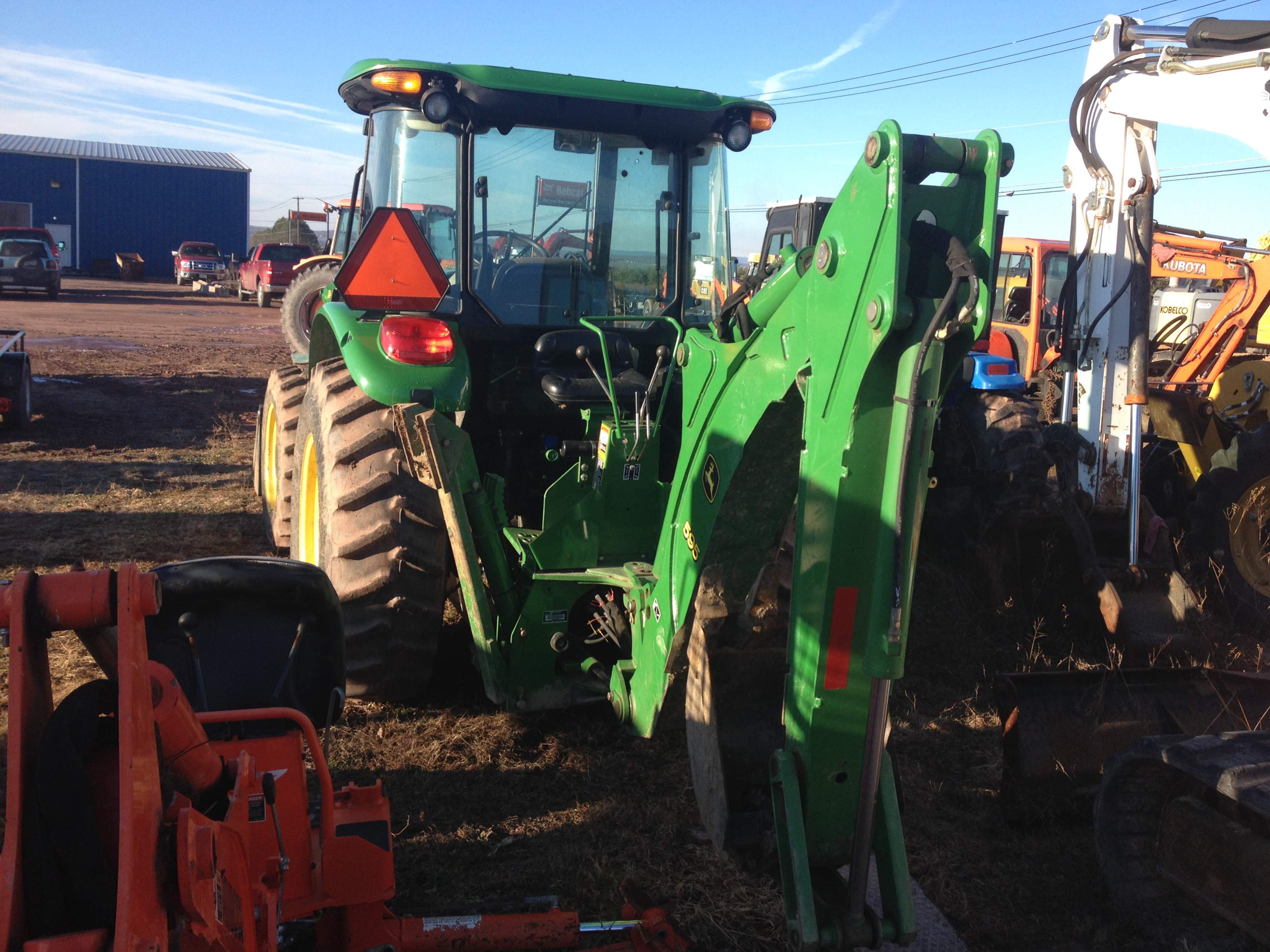

Just got this nice used 5083 in if anyone's interested
