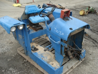

Looking at Buying this New Holland TW20 Cab Platform for my project.
   / Looking at Buying this New Holland TW20 Cab Platform for my project. #1
CorvairGuy
Member
Nov 24, 2010
41
Prescott, Ontario
Small John Deere Garden Tractor we brought with us. Want to and need to buy a farm tractor and some attachements. Hope to build a Corvair Custom Hydraulic Tractor with a gas heater to move boats around and use in winter.
However, I like to see the size of the full tractor, with this platform, before I fully comit to the purchase.
Doing searches for used TW20 for sale; I have not been able to find anything like the one in the picture below. The ones I see have curved rear fenders and not flat ones.
Is this a TW20? (or did they mark it wrong)
Does anyone have a picture of this tractor?
Do you know what year it might be?
Also do you have any idea what something like this is worth? (they want $1,500)
Thanks, Tony

Complete TW 20's that run but have one issue or another are not much more!
   / Looking at Buying this New Holland TW20 Cab Platform for my project. #4
Looks like a Ford 7000 or 9000 platform. I've never seen a TW-20 platform model.

Yooper1, I tried those links. However, I'm only see curved fenders.
The one for sale is showing flat... I'm still searching - but not having much luck. I could be wrong. But from the size of those fenders on the one I'm looking at - the tractor might be a mid-size and nowhere near as larger as the ones I'm seeing. Which are the same ones on your links too.

Slowzuki, You might be right on the Ford 7000.
It is the closest thing to it.

5000 or 7000 row crop the 8-9 thousand 86-96 hundred and tw's had white fiberglass finder that was rounded. that platform is not worth 1500 u can buy a salvage 5000-7000 rowcrop for a bout 2000 to 2500 for the whole tractor

Yes it could well be a TW ..I've seen lots of TW15 open station in africa with these fenders
   / Looking at Buying this New Holland TW20 Cab Platform for my project. #10
A 4 cylinder flat deck platform (7700 or similar) wouldn't have a hole in the cowl for a brake oil dipstick. Neighbor had a TW20 2wd open station tractor bought brand new from the store where I now work.
