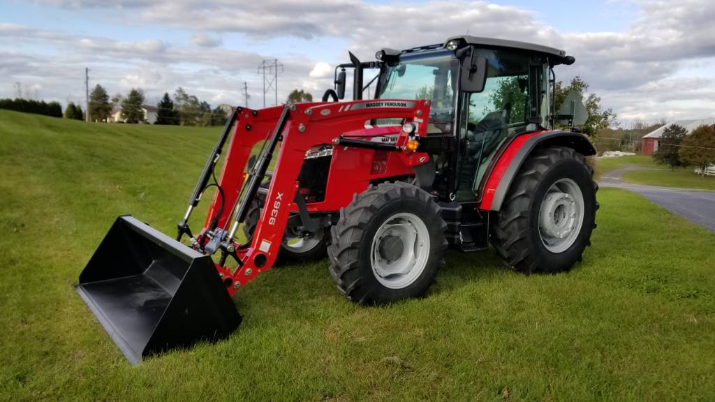

Look at a Kubota M7060, Case 75c, New Holland Powerstar 75, and a Massey Ferguson 4707. All great machines. Buy the one that impresses you. I looked at them all and Bought the Massey Ferguson 20181024_163604.jpeg20181026_120043.jpeg
