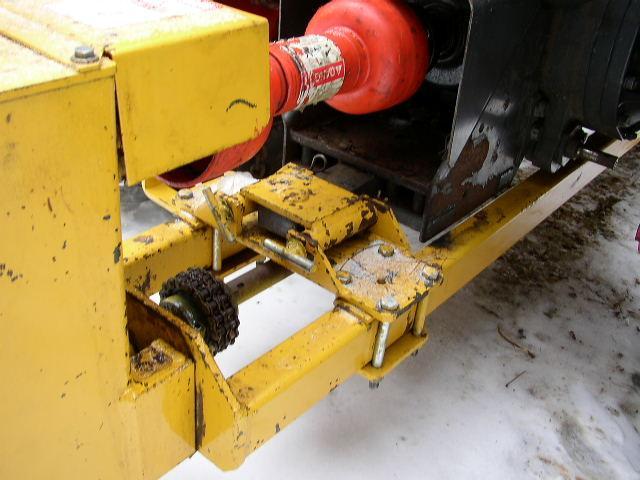

Snowblowing generally does not soak up a huge amount of power so the efficiency hit of a wet kit is tolerable - there should be plenty of power left to do the job. Besides, you can always slow down or take a narrower bite if the snow load is unusually heavy. Other things that affect it are hydraulic line size - bigger is better, oil type being used - viscosity is less temperature-dependant with synthetic fluid. On the coldest days, running it a bit with no load will warm the oil a little and performance will be better.
Front blowers are very nice to use - especially for long driveways. On mid-to-larger tractors without mid pto, the drive options for front-mounted blowers are either shaft drive (see Erskine pic) or hydraulic from the rear pto, using a wet kit.
