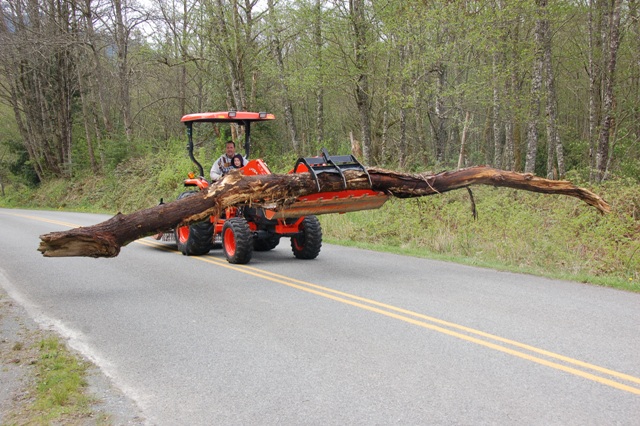

You might also want to consider a grapple on the bucket if you plan to move any trees around. I attached a picture from this site so you can get an idea of what I'm talking about.

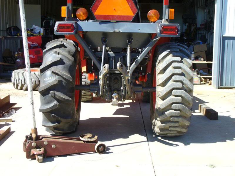

Consider R4 tires instead of R1 tires if you'll be in the woods at all. The R4's won't have as good traction but they will be MUCH more puncture resistant. In either case you may decide to add tire chains depending on how muddy your conditions are. I attached another picture from this site with R1's on the left and R4's on the right.

I sure would like to get the grapple in the picture. Any idea how/where they are available.:thumbsup:

I have to agree with BlueGill - I also have a L3800 and own 18 acres of woods and trails. So far - it has done everything I have wanted it to. My soil is sandy and the R4 tires seem to work out just fine in both Summer and Winter here in Michigan. If you're going to get a Loader - get the Hydro trans - it's great. Also pay the extra money for the quick attach loader bucket. It makes switching FEL attachment VERY EASY. Good Luck....
