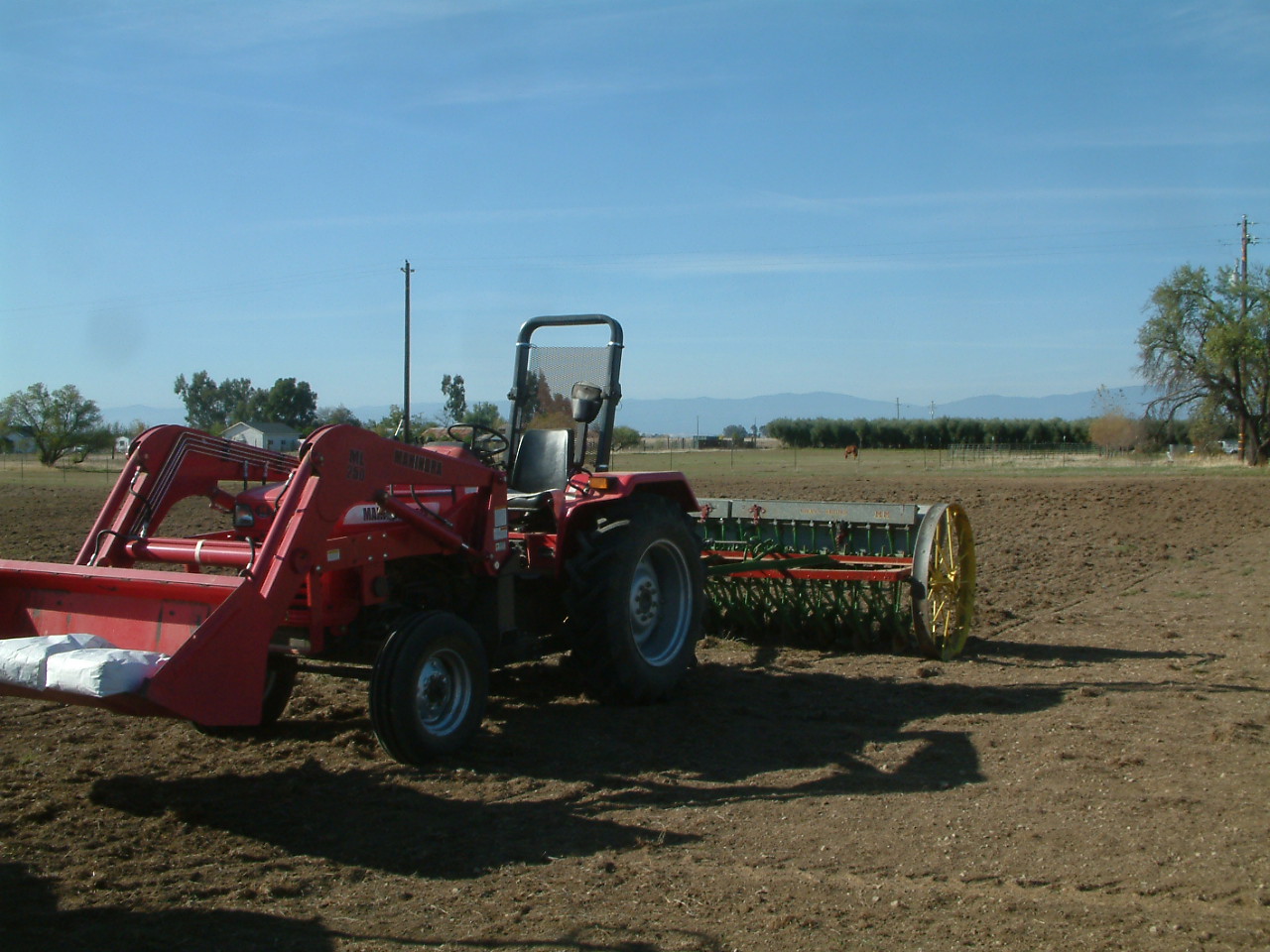

My Minneapolis Moline P3-6 drill (10-ft wide, 20 drops, 6" row spacing) had a pair of grass boxes for planting small seeds (grasses, alfalfa, etc). You can see those two small grass boxes attached to the front of the larger boxes for larger seeds (oats, wheat, etc) and/or granulated fertilizer. I bought two of these old steel wheeled drills for $275 from a neighbor and used parts from both to make one working drill. Took several months of part time work to clean up the rusted parts and make the drill look pretty.
Normally, this arrangement plants grass seed in rows. If you want a solid stand of grass instead of rows, you can modify the drill as shown in this photo. I moved the grass boxes to the rear of the drill and added a pair of two-bounce seed chutes to distribute the seed in a line rather than in 20 rows.

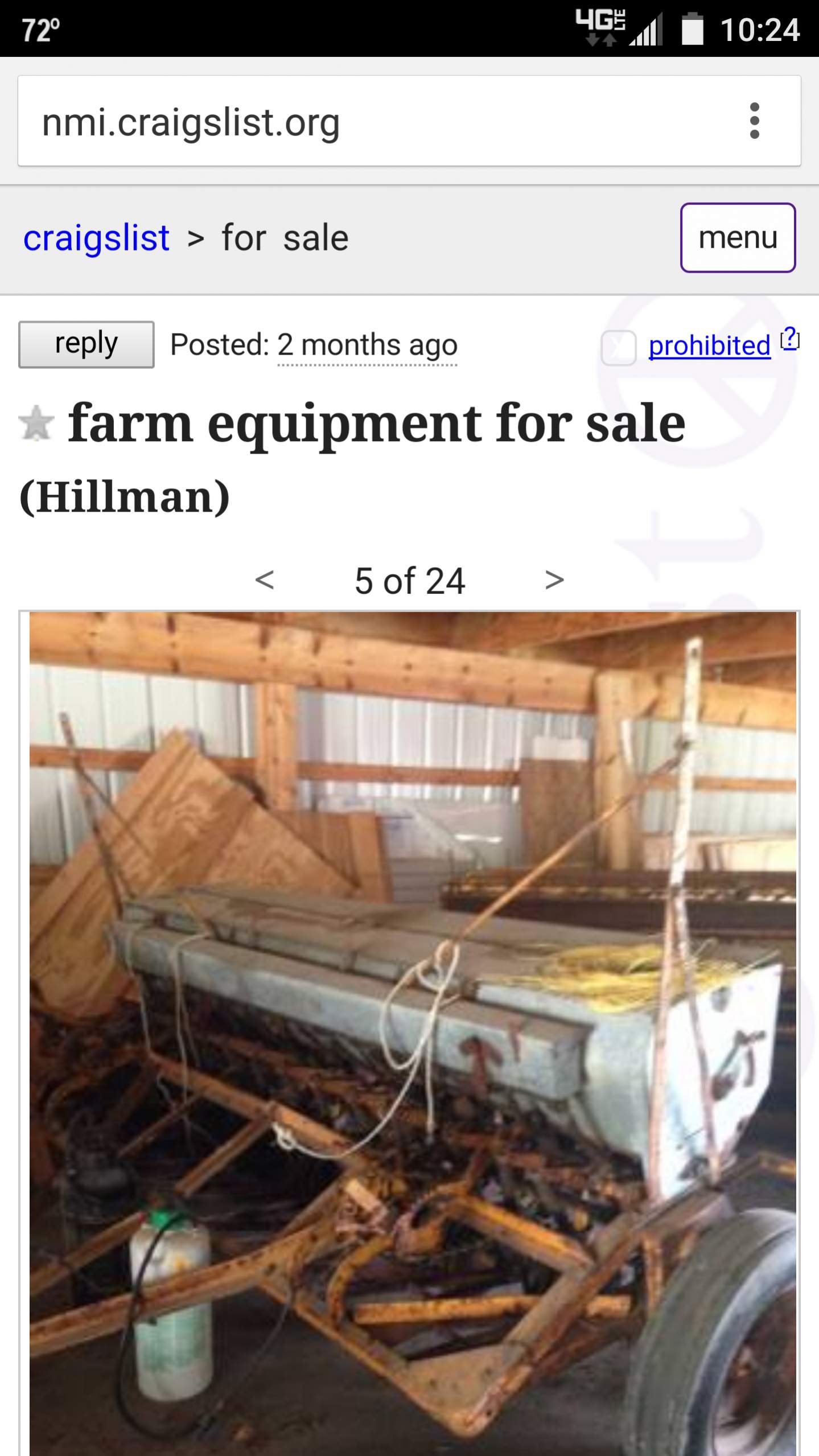

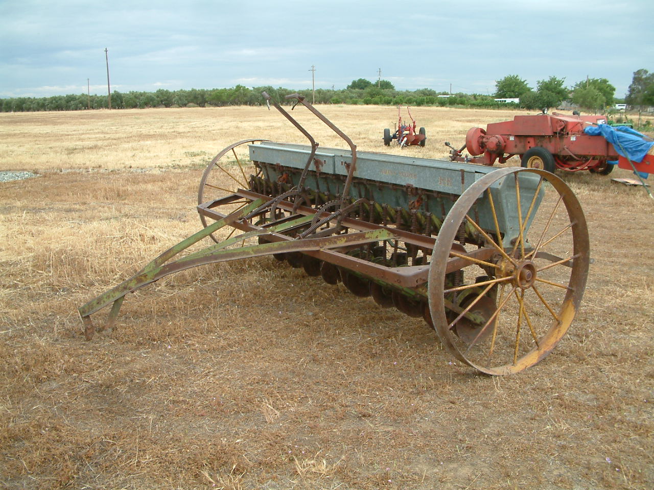

Thanks for the reply guys I appreciate it. Here's a picture of it.

Looks OK. It's stored in a shed--less rust.
There has to be some way to lift the disc openers out of the ground while making turns. One of the old Minneapolis Moline drills I bought had a pair of trip clutches for this task. Pull the ropes once and the openers lift out of the soil. Pull them again and the openers drop into the soil.
The other drill had manually raised openers. I modified that one by adding a hydraulic cylinder to raise the openers.
I can't figure out from the photo you posted what kind of lifting gear that drill has. I'd check this out before buying.
