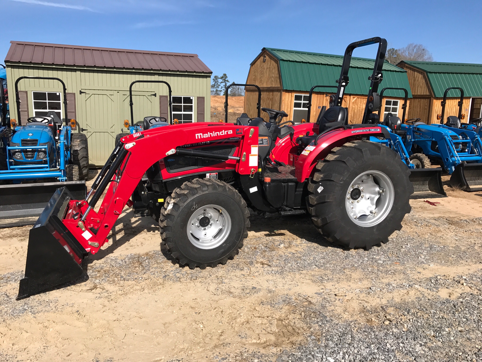

Mahindra 3550 would be perfect for you. I have about 35 acres that I'll be doing the same thing will be and this tractor is my choice.
