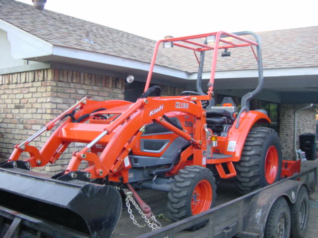

I did one of these to prevent that kinda thing. Will add an aluminum cover in the near future.

When you put that aluminum top on your FOPS, remember it will reflect engine noise back at you and magnify the volume. Put some sort of sound deadening material on the underside of your roof. Also, one of the folks on TBN cut a "moonroof" into his canopy at the front edge so he could see OVER his bucket when it is in the fully upright position. He inserted a heavy plexiglas panel for protection. Just a thought.

I did one of these to prevent that kind of thing. <font color="blue"> </font>
I looked at your photos a while back and was actually thinking of you while blindly seeking my severely mangled glasses and wondering if my hand was broken!
