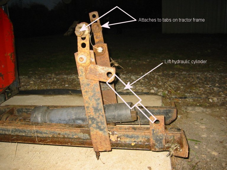

I'm new, so be patient. Hope my pics post (they're in photo area). My son and I pulled it out of the weeds this weekend but not installed. You may be able to get an idea of the setup. I'll try to answer any questions you or others have about it. First photo is front end lift setup.
   / Look Ducksjunk - Snowthrower Re:195D post

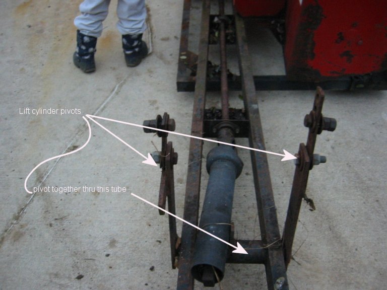

#2
This is another view of front showing the lift arrangement. Those are my helpers boots.

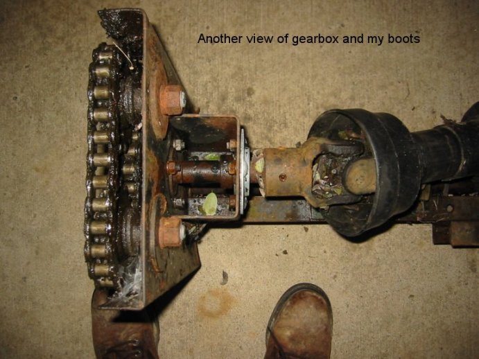

This is the gear/chainbox. It also shows the stud that is bolted thru the drawbar. It hangs but is able to wiggle somewhat so nothing breaks when it lifts. It only lifts about 6", but thats enough to clear most things. If not it gets thrown out the chute (Tim Allen ARR ARR).

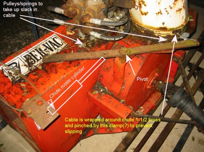

This is the hydraulic pivot stuff for the chute. The hydraulic hoses and valves are just laying on top of things right now. They mount to tractor (soon). I don't think you will need all the leaves and rust to make yours work. It's old, rusty and beat up (from previous owner) but I keep everything greased and lubed that needs it.

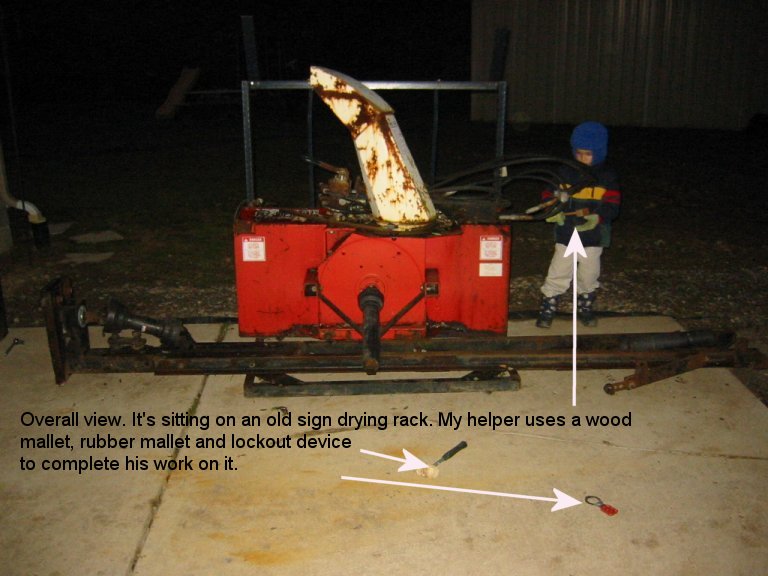

This one is an overall view to give an idea of the size. Can measure anything you need, just ask. My helper hopes we don't get snow too soon, this is going to take some time.

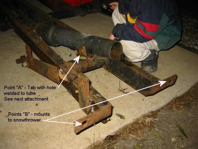

You have to reference point "A" and "B" on this photo and the next one to see how the frame attaches to the snowthrower. It still may not be clear. My helper has his wire brush in hand but isn't sure where to start.

   / Look Ducksjunk - Snowthrower Re:195D post #10
Thanks for the photos! This is a pretty neat setup. You only showed one photo of the gear/chain box from the top. I'd love to see one from the rear, showing the relative sizes of the gears. Do you operate this thing at 540 rpm? I'm just curious about the rpm of the lower shaft and impeller.
