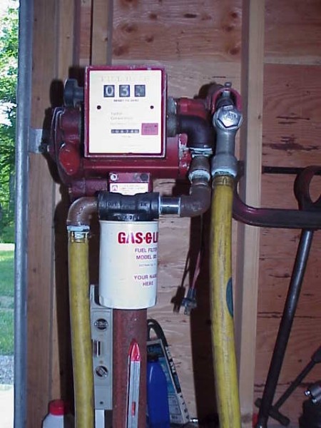

   / Long term fuel storage #4
Here is what I use and I have not had any problems at all. It isn't very elaborate, but it works and that is all that I care about. I don't use a Mr. Filter since I have the fuel filter on the dispenser pump. If I wanted fancy, I would swap out this plain Jane dispenser for the fancy one that I have in the garage. That one looks more like a fuel dispensing pump since it is red and white, and square all over. It even has a skirt to hide the pump stand. /forums/images/graemlins/grin.gif /forums/images/graemlins/grin.gif
