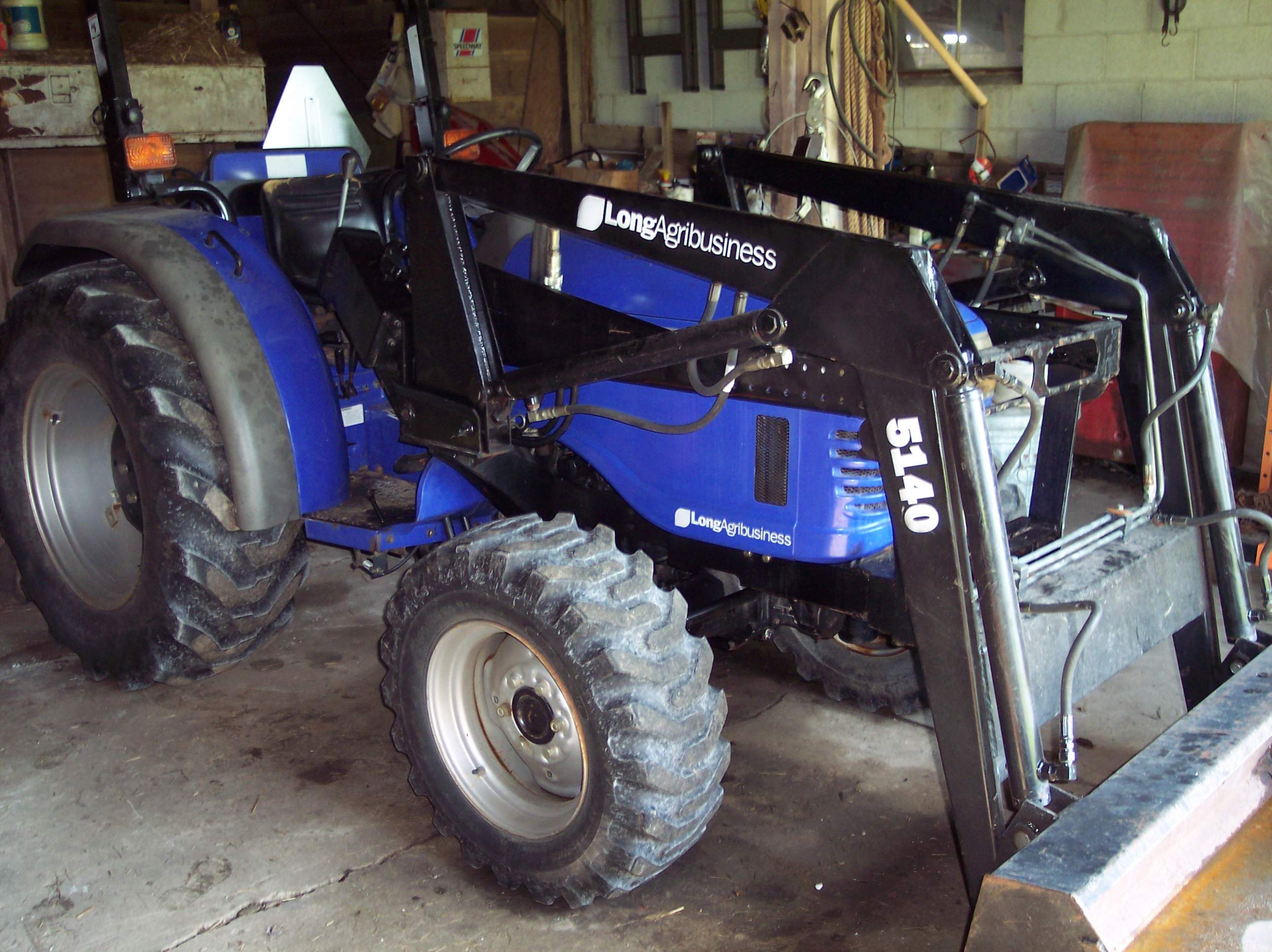

I've got a Long Agribusiness 360 DTC (now called Farmtrac ?) made by LG with a 5140 FEL that started losing hydraulic fluid through a leaking hose recently. While using it this weekend, it began spraying out with every move of the bucket - time to get it fixed. Found the culprit, tightened the fittings, stopped the leak and need to service the hydraulics. Now comes the problem.

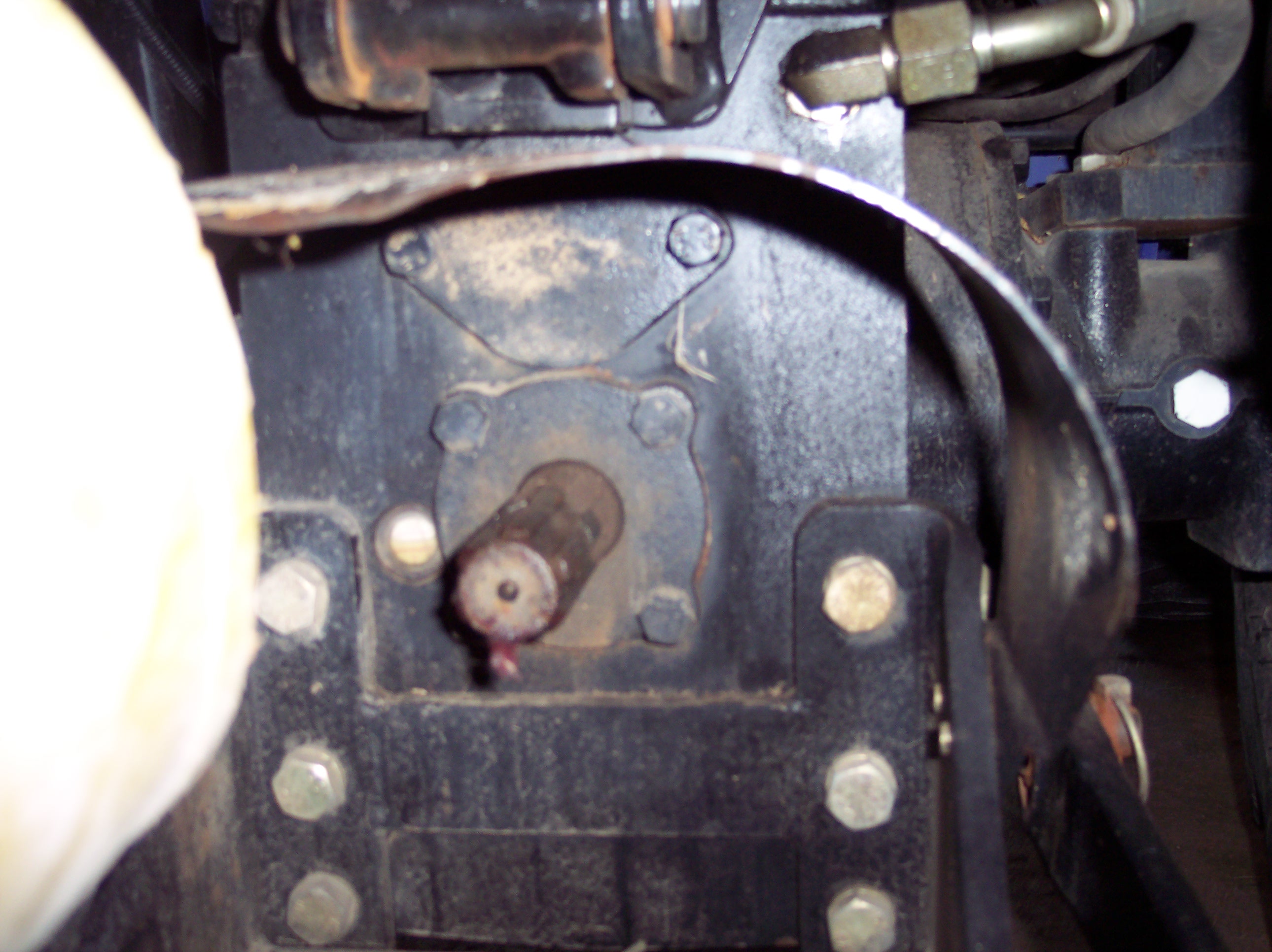

Still not confirmed through anything other than second hand info, but it appears to service the hydraulics on this particular tractor (see photo), you have to disconnect the return line above and right of the PTO (see photo - sorry for it being so out of focus), and use the sight glass to the left of the PTO to determine level.

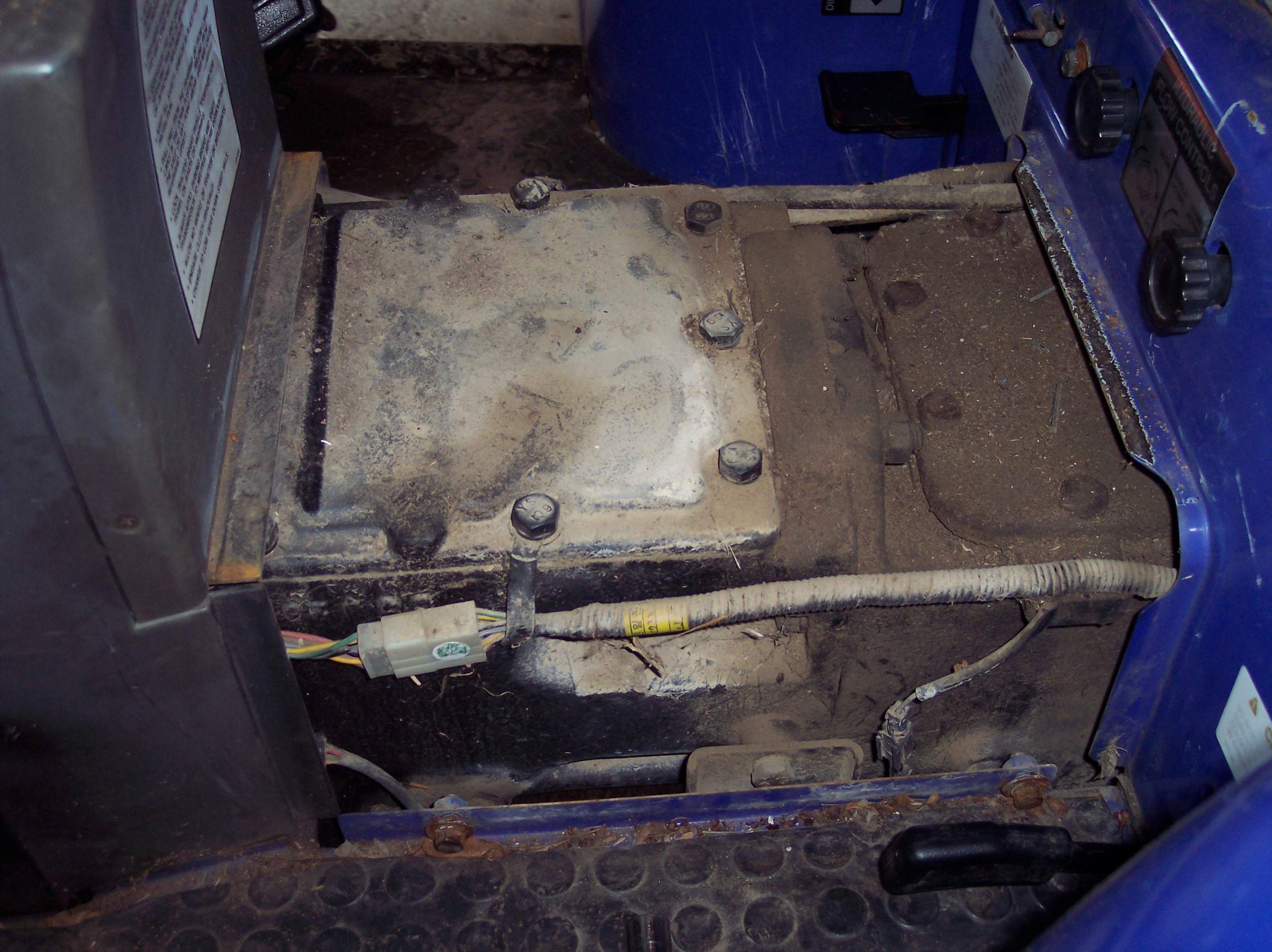

There is no dipstick nor any way to service the hydraulics on the raised portion between my feet (see photo with cover removed).
Bottom line, I didn't lose as much fluid as I thought I had. Everything is working like it should, and I am still happy with this machine compared to what I had in the past.
