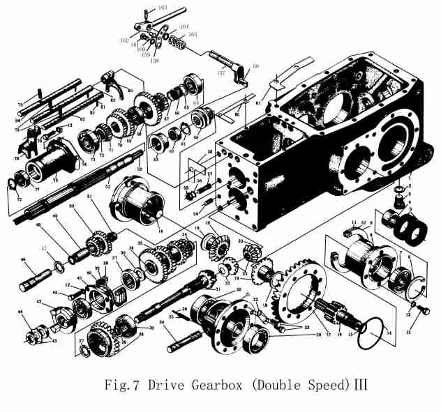

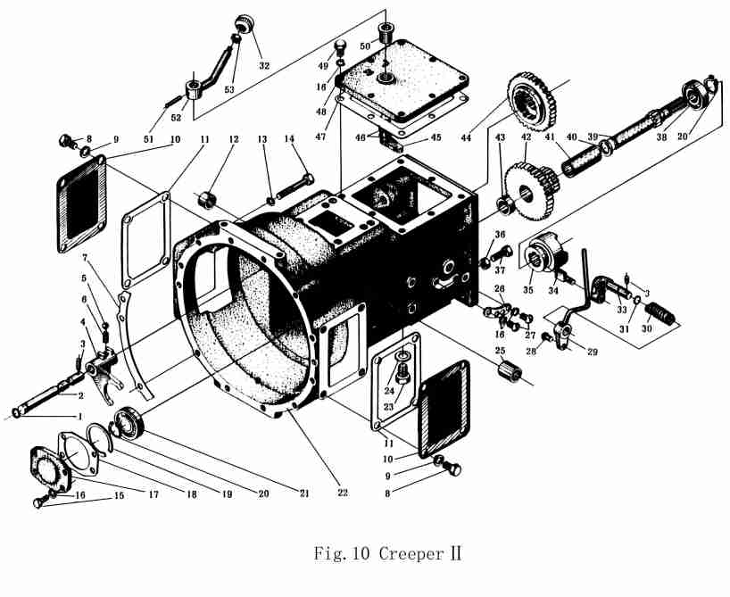

Um, Yes. It does Greg. The 200 series does not use a sliding gear. It is a 3 tooth claw. Part numbers 29-35 in this first pic from Johns site are the 4X4 engagemnent mechanism. Part 35 is the claw itself(rear view) which is slid on its shaft by part 34 and the rest of the lever mechanism. That shaft is directly geared to the front diff via transfer case gears that are always engaged. http://www.johnstractor.homestead.com/files/ClutchHouse.jpg
When you lift the 4X4 lever Part 35 in the above pic slides to the rear and engages with part 42 in this next pic(lower left) that is on the end of the front end of the transmission output shaft and direct coupled to the rear diff.
http://www.johnstractor.homestead.com/files/DriveGear.jpg
I was incorrect earlier, the difflock claws(130,132 in the last pic) have 4 teeth, not 3. The same engagement theory applies though, they are hard coupled to their respective wheels and must be rotated into alignment by wheel movement to engage.
http://www.johnstractor.homestead.com/files/DriveGear3.jpg

I get the feeling that you're basing your convictions solely on trying to interpret a parts manual diagram. I have no idea why you linked to a creeper, the 200 Series 2wd/4wd select lever is one box back - on the right side of the transmission housing. And the transfer case is directly below the transmission housing. Or at least they used to be, back when I owned that pair of 254s. Have you actually performed a hands-on disassembly of this particular shift mechanism yourself Ron?

I know it pretty well as I have been into all of mine except the rear section under the 3PH during my initial inspection and tracking down a unusual noise. I was intrigued by the claw assembly so I looked into it closely.
"the 200 Series 2wd/4wd select lever is behind the gear shift lever - on the transmission housing cover"
I don't know what tractor you are refering to, but the 4X4 engagement lever on my 284 is on the left side of the creeper case, right by my left ankle when seated. You lift it to engage 4X4. You can see the claw and linkages with the creeper case top cover removed and it is just like that in the pics I linked to. In that creeper case pic, part number 39, the shaft that the claw slides on, has a little gear in the middle of it. That gear spins the intermediate gear down in the transfer case...
