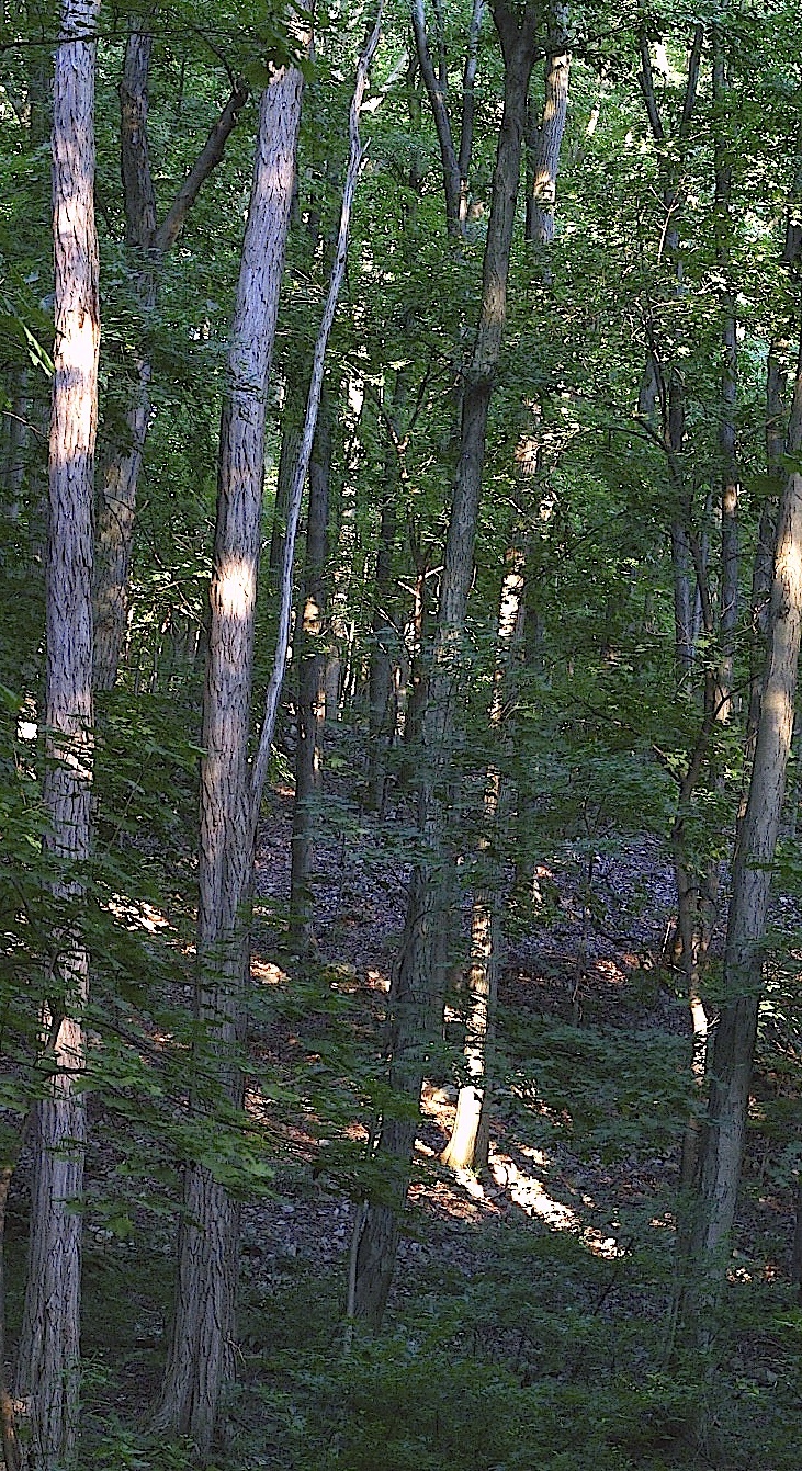

-That's exactly what I am doing! I'm not really "logging", just cleaning up after Irene. The hillside is too steep, too rocky, and too dense for any equipment to get to the downed timber. (I do not own a helicopter:laughing:) Even getting up there with a chainsaw is an adventure!
I hooked on a big (18") oak tree with 60' of one inch rope, 50' of wire rope, and a logging chain on the backhoe, and, as Scotty370 says nudge it down the hill, until I can put a pulley on a tree, and then use the 850 to get it down to the lane, and turn it into firewood.
If that doesn't work, I will have to cut it up in place, and let gravity bring 'er down :thumbsup:
