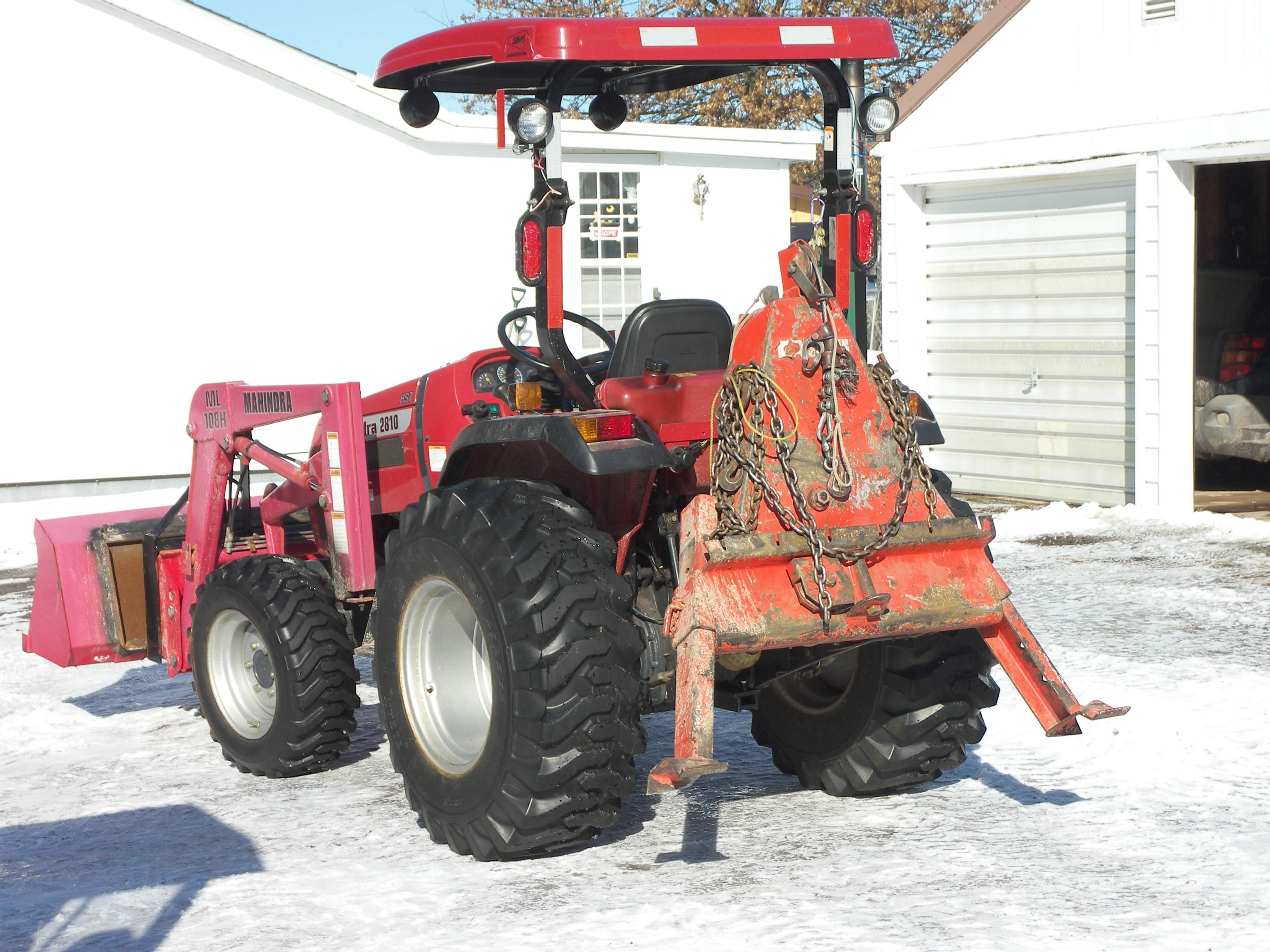

I have a farmi and it was on the back of my 2810HST Mahindra. It worked great but DO STRAIGHT PULLS WITH IT! I found the tractor wasn't quite heavy enough to carry angle pulls and broke the rear end. It was all weldable but be careful. . . John
Your Farmi has legs like the one I saw do you know what your model number is or if parts are a problem? Other say that the blade makes them more stable than the legs, do you think that was part of your trouble?
I worry about the stress on the top link, I damaged it already using the backhoe and it seems most of the pull would be on the toplink.
