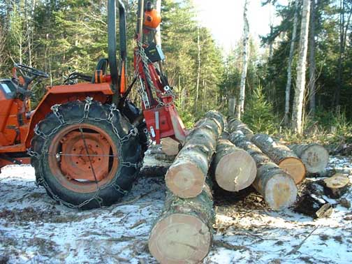

Hi All,
I've been doing a bit of online comparison of Farmi, Fransgard, Tajfun, and Wallenstein logging winches, and am finding it to be exceedingly difficult--like tractors, every model is "the best" in it's arena...
Since everyone checks up on what they bought (and the ones they didn't!) I am hoping that anyone who had one or more of these winches (or other brand?) could give a little feedback on:
1. what you like about your brand?
2. what features on your brand steered you in that direction?
3. what price did you pay & when?
4. what features have you since noticed on other brands & would those differences have swayed you in another direction?
5. which have you found/heard the most rugged? reliable? available?
6. is a ~4 ton model the most appropriate for a 32 hp MFWD mid-frame?
7. what are the pros & cons of PTO vs. hydraulic driven units?
Any thoughts & experiences would be greatly appreciated...

I was in your position awhile back and ended up purchasing a Farmi 501 for the following reasons:
The size matched my tractor - look at the HP requirements on the winches, and match this to your tractor, this will determine what will work best for you - this will also determine the pulling capacity of the winch
Farmi's have been around a long time too, so parts and dealers are available
Farmi's are sturdy, well built, and simple to operate and have a good reputation as being dependable. I like quality and depend on my equipment to work when I need it to.
No problems with my winch so far and really can not comment on a hydraulic winch. I am no pro, nor do I make a living with my winch but I have not regretted my purchase, other than I wished I could have found a used one and saved some $$$
You can also check the forestry forum for good info on winches - www.forestryforum.com/
I looked at and liked the Taijfun and Fransguard and others have good things to say about these as well - My second choice was the Taijfun.

Been logging with a Tajfun 3ton for the last year with no problems being heavier it works as ballast and seems solid.

One other comment, based on my experience. It's been a while since I was shopping, so I'm not sure of the model numbers. My Fransgard is the second level, rated for 25-40HP. My tractor is an L275 Kubota.(27HP) It powers the winch with no problem; too often it'll drag the tractor backwards or lift the front tires off the ground. Yet because of the size of the winch frame the 3PH won't raise it very far off the ground, about 6 inches; this causes a lot of problems on uneven ground. For my tractor, the 2800 would probably work better.
