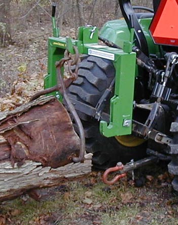

Are you into forging? That would be a good way to build your own.
McMaster-Carr is another source, where I have seen them listed, as well as Forestry Suppliers and Ben Meadows (besides the two others listed).
Size is the big decision. Of course, that makes having an idea what size log you will want to pull. Mine open to 24" and can be used to lift a log bigger, but not pull it. I lift the bigger logs with the tongs enough to get a chain around it for lifting and towing. I hook the tongs into the top hook of my iMatch quick hitch, and it works great. (see attached)
A search on 'logging tongs' will bring up several threads that may make for interesting reading for you.
