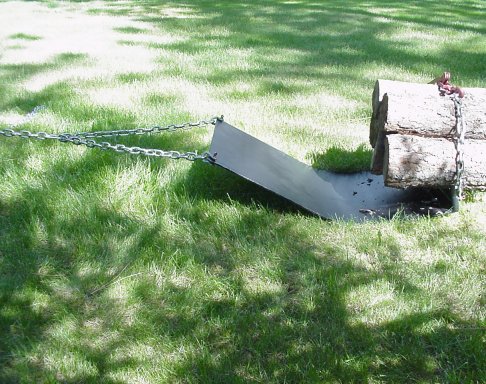

Thats alot of money. I saw what was called a Quadskidder on a web page (montanajack.com). It is a really good idea, but the package was expen$ive. I have chain binders and some steel. It cost me $30 to have a piece of steel cut to 20 x 40 x 1/4. Then bend to a 45 degree angle with a radius. Weld on the angle iron lip and a couple of links of chain and it was done. I used my Honda Foreman and this skidder to bring out cedar and spruce logs from a low area. Worked great, and the tractor would never get back there.

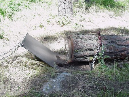

more views of the quad skidder

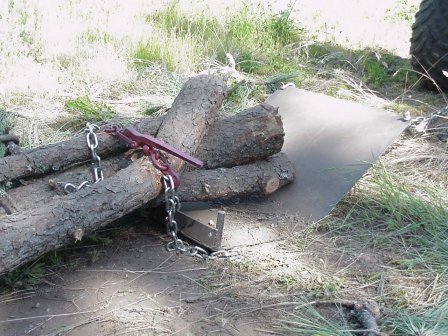

third view

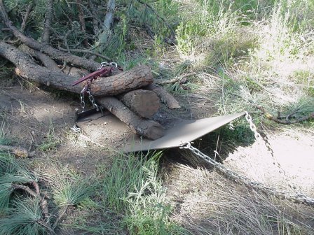

fourth picture

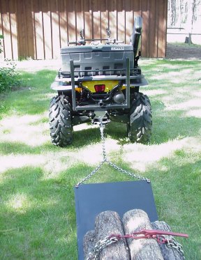

number five...
I used my homemade one again last weekend. I had a Elm tree with several branches come down in a ice storm. Since the tree was slowly dying, and it was near the house, I took it down. Now with the frost just barely out of the ground, and slightly muddy, the skidder plate worked just great. Again.

FYI I printed out a bunch of those pictures of your set up. thanks, I'll get one of those sleds made for me. Is it 1/4 steel? thanks, bw
/ Logging Arch #11
Yes, 1/4 inch works great. Even 3/16 would be strong enough, a little lighter too.
