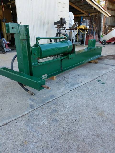

I've been considering getting a log splitter.
I'm a homeowner, and primarily heat with wood (gas furnace back-up, but I prefer a hot roaring fire and it heats the house just how I like it - hot in the living room, cooler in the bedrooms), but where I live I tend to burn perhaps 2 cords per year of mostly oak. I've typically bought wood, but as I've been doing more and more on my land, I've accumulated quite a pile of rounds, which I hand-split for the most part. I can continue hand-splitting, but it takes me a long time and I've other chores I could be doing instead.
So, a couple questions.
First - do log splitters do ok splitting dry/seasoned rounds? Assume oak; live oak and black oak for the most part. The pine that's here I can sneeze and to break up so I'm not concerned.
If they do fine with dry rounds, I'll probably just rent a splitter once or twice a year; the local yard (which takes me about 1h20m round-trip including paperwork) charges $55 for 4 hours (of which I can get maybe 3 hours operating time) or $80 for a full day.
Otherwise, there's a semi-local craigslist ad that has this monster:
Apparently it's a 6" cylinder with an 18" stroke (not sure what the rod is).
My tractor has 9gpm to the implements, which means a ~28sec full cycle time if the rod is 2".
Seller on the phone states I'd probably want to add quick couplers or perhaps replace the hoses; he's asking $400 for the unit.
There's no stand, he said he just drops it to the ground fully. Apparently it's about 7' long.
Should I just get it? I've got implement sickness and wouldn't mind splitting wood an hour here an hour there instead of saving it up for a day's splitting and stacking; does this appear decent?
The paint is new - the implement is old. Things to look for?

I never used a tractor splitter but that one is a beast, Seems like a good enough deal. For me it wouldn't work unless I had another tractor for lifting a pallet to the work table.

That seems like a pretty good price.
A few things to consider about wood splitting with a splitter.
New "store bought" splitters (self contained with a gas motor) that will have no problems with 2-3 cord a year can be had for $1000 and with a little care, should last for ever.
It's awful handy to have your tractor available to "nurse" the splitter duties, ie; hauling rounds to it and split wood away to your stacks.
A vertical/horizontal splitter if my favorite and has little to do with being able to go vertical. That is a nice feature with huge rounds, but the best feature is the wedge is on the ram and when splitting rounds with multiple passes, your not continuously "chasing" your log back for another split
The vertical splitters are usually at a decent working height, working hunched over for hours may not bother your now, but there will be a time.....
consider a comfortable working height.
Good luck with your search, the 3 point splitter you've shown is a pretty "cheap date" and should always be worth that price. The working height is adjustable and there is very little to go wrong with them.

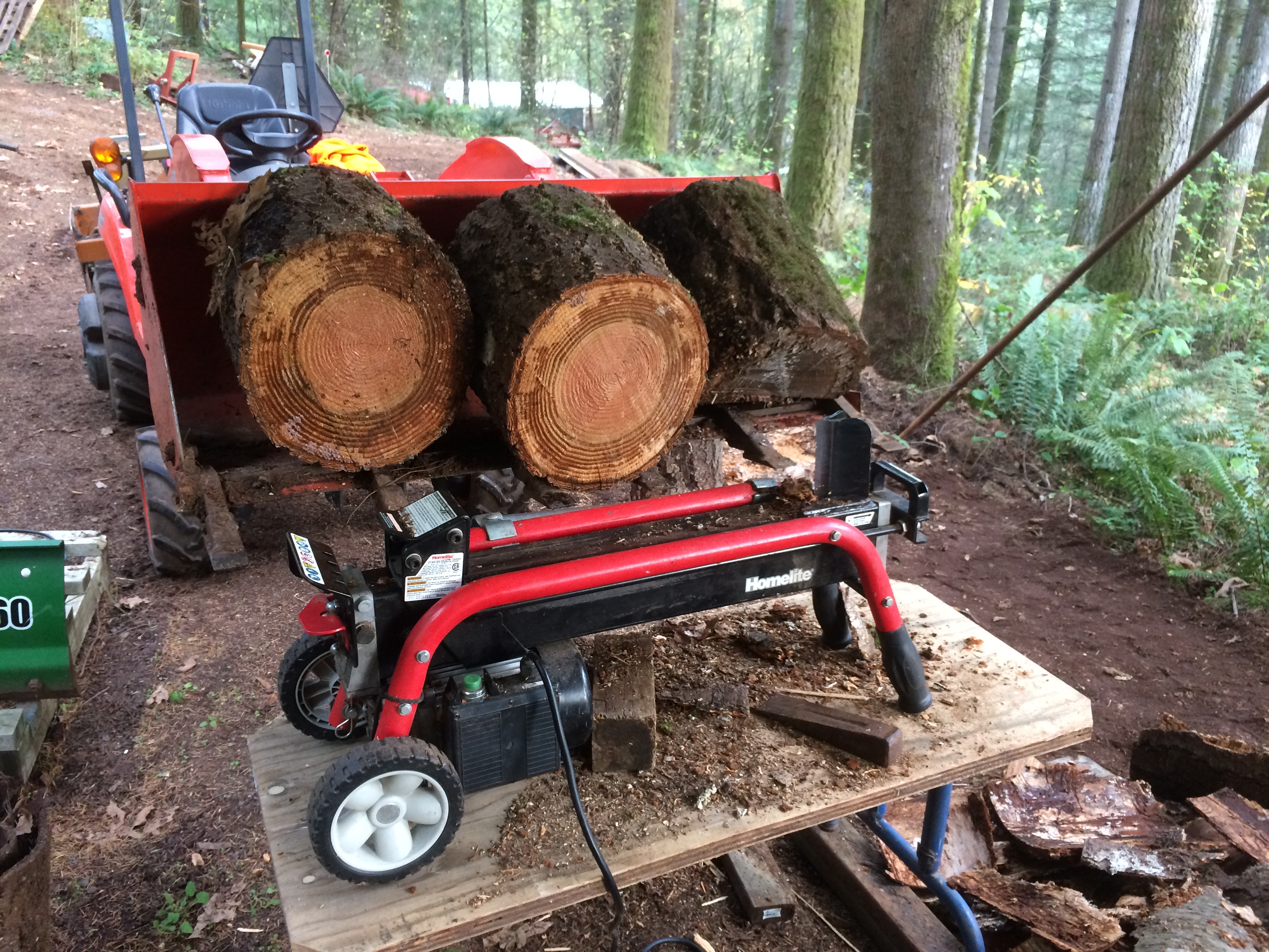

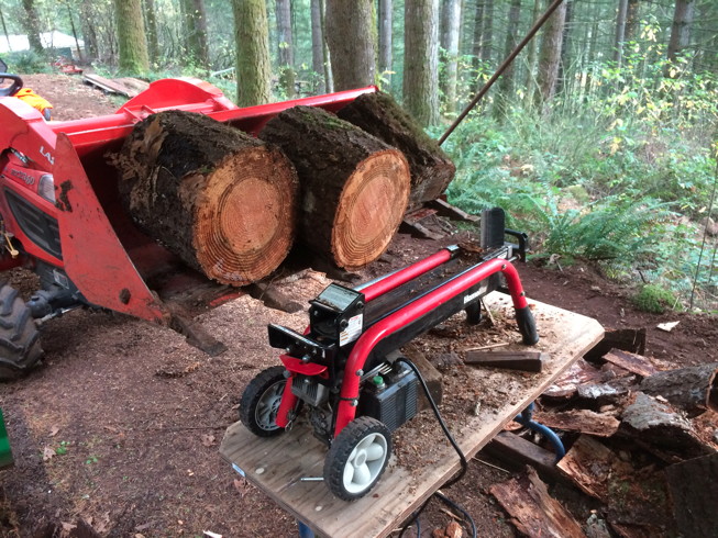

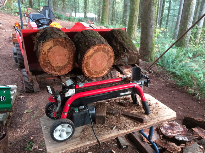

An electric splitter will work far beyond its listed capabilities with easy wood, like this Douglas fir. It is from a log that had been on the ground for several years. The center was still solid. No photos of same sized good wood, but it splits them just as easily. Homelite 5-ton splitter.

That long cycle time will drive you crazy. Stand and look at a log for 30 seconds. Then do it again. Then again... You'll be frustrated beyond belief.
Buy a stand alone unit for all the reasons above. If you do buy a tractor mounted splitter, buy a different one than that. I have a 22 ton unit that will split anything I've thrown at it, including 30" red oak. I rented once and the hassle made it not even close to worth it.

OK, I'm convinced - that 6" cylinder is going to have an intolerable cycle time, I'll hate renting (already dislike it in general) and definitely would prefer having my own, and I'll get something at least 28 tons :)

I'm not so sure your Branson would lift that heavy splitter, sticking waaay out the back like it will...

Excellent call on waiting for a standalone! That 9gpm you are calculating the cycle time with, is assuming full throttle operation which you'd never be at. Realistically, you'd be at a lot longer cycle time.
I had a 3 point mounted splitter and figured it would be the best way to go. It wasn't. I ended up selling it and buying a standalone splitter.
Some guys like their 3 point version but I personally did not.
