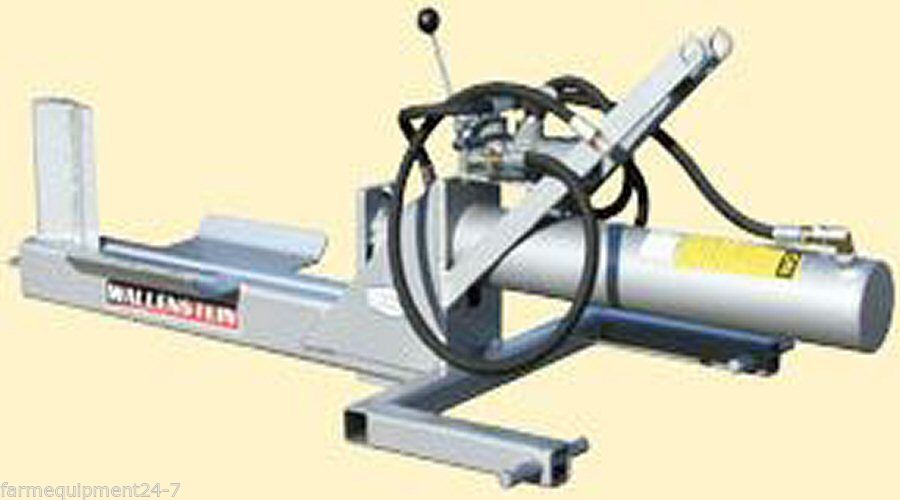

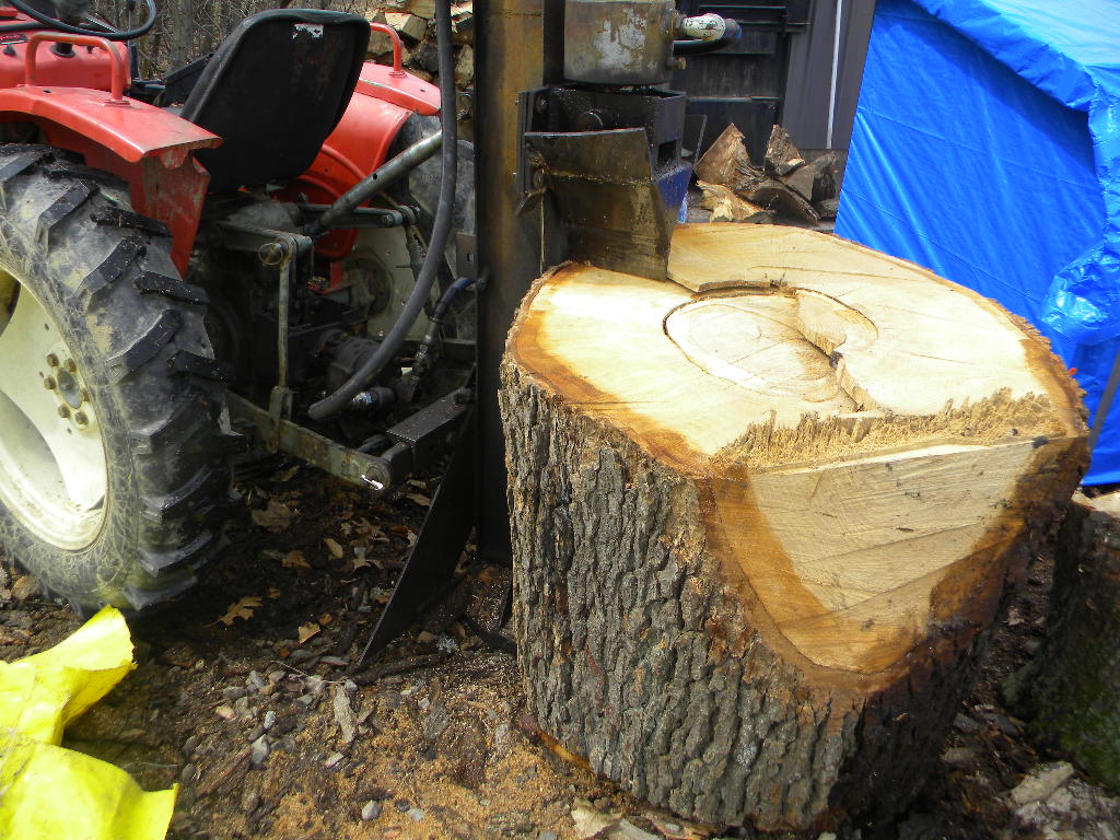

Hello and welcome cmartinga, from another Nrth Ga member,
I think the suggestion was to use a (PTO driven) hyrdaulic pump, This type of pump will produce a variable of pressures, depending on the pto speed setting,
One other thing to look for would be a fully self contained splitter that has the control valve and reservoir built onto it,
This would make it as easy as simply slipping the pump onto the PTO shaft , of course hitching to the 3 pnt's and start splitting, needing Not having to tap into your tractors hydraulic system in order to instal a control valve,
Picture attached of a PTO pump
pictures attached,
