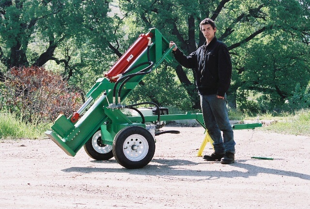

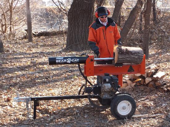

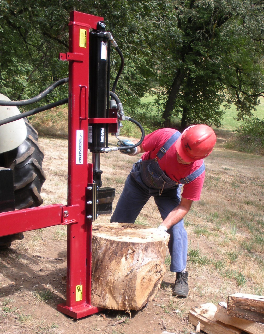

I'm getting too old to split the ironbark by hand anymore so I am looking at buying a petrol or diesel splitter. Ironbark is very hard and burns beautifully and I have an unlimited supply of it on my property. What I would like to hear from anybody with experience is, what tonnage splitter do I need for ironbark dry/green of 12" length and upto 24" round.

Around here , the minimum size you see anymore is 20 ton , with normal being 24 - 28 or even 34 ton models . Cylinder size is usually in the 4" + class , thus good stroke length and size . My 24 ton gas model does both oak and madrone , which are hardwoods . Madrone being the trickier of the 2 . It has this odd habit of getting " Explosive " as it dries in rounds . While most wood just splits when the wedge comes through , you get the occasional madrone piece that starts out splitting normal then " Pops " or " explodes " apart .
Thus the next feature you want is a model that is both Horizontal and Vertical .
I am to the age now that even the small stuff , I just split in the Vertical mode . Keeps me positioned out in front of the splitter instead of next to it . Got tired of the bruises from wood flying apart .
