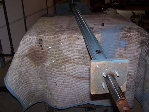

In salvaging out a trailer mounted solar signboard, for various components to use in current and future projects, I have a cylinder that is labeled "ROTA-CYL Corp. Schwenksville PA. Model Number BJ 11-20-SOLA, spec's are 2" bore, 58 3/16" stroke, serial number S 50324." (YES, nearly 5 foot stroke).
The shaft is 1 3/8" diameter.
This was originally a one way cylinder (raise the sign, with gravity return to down position), however the top of the cylinder housing has a threaded plug and I believe it could be a two way cylinder with additional hose, proper valving et cetera.
Shortening this cylinder to an appropriate length appears as though it would be a relatively easy task, as the cylinder end caps are held in place by 4 threaded rods running the entire length of the cylinder. I would want the stroke to be approx. 32", for firewood for my outdoor furnace.

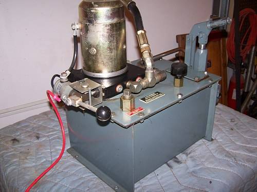

I also have the 12 volt electric pump and approx. 4-5 gallon reservoir with it's one way valve off of the trailer. I'll probably utilize the reservoir.

1) Can I assume the "20" in the model number may indicate a 20 ton cylinder? And might the 11 indicate 11 gpm--or reverse?
2)What gpm pump would be best for moderately rapid actuation?
3)What size gas engine would be appropriate for properly sized pump.

An 11gpm double stage pump wants 5hp min gas engine or 2hp elecetric motor, which is how I run mine with a 4" cylinder. Pretty standard for small splitters.
I don't think a 2" bore cyl is going to do it.
With a 2" cylinder the pump will be in low speed high pressure most of the time. High pressure is what the the relief valve is set at ,usually 2250 psi .
The 2 inch will run faster but the available force is 25% of the 4".
It's a balancing act between pressure and speed. I have never seen a spitter with a 2" cylinder. I suspect you would need 10,000 psi at the relief valve,

Just my opinion, but I feel that a 2" cylinder is too small for a log splitter. I know you would like to use the one you have but I don't think that you will ever be happy with it. Look for a 4" cylinder minimum. I think that will work out much better for you.

I don't believe it is worth the effort to use what you have. A 2 in bore with 1 and 3/8 shaft at 2500 psi will only push 7,864 lbs, and at 3000 psi, it will push 9,425 lbs.
You would be better off using something like this, min of 2 in shaft. You could go with a shorter cylinder if you want shorter firewood.

4inch minimum. with 12v electric it won't be fast and you will need a few batteries charging while you are using one to split. With the time and effort to build one, you just as well make one that will do the job. You will be happy you did.

While I believe the rod size is fine for the power you will have, the 2" piston will only give you @ 4 tons of splitting force. Depending on you wood that may leave you a number or knarly blocks you can't split.
On the other hand I have a 4" piston, 1.5" rod on my splitter cylinder and find The pressure rarely gets to 1000 psi b4 the block splits and I can shear a 6" cross grain at @ 1500 psi. It's way over powered, which just results in slower cycle times. Either a 3" or a 3.5" would work faster for me with enough power.
