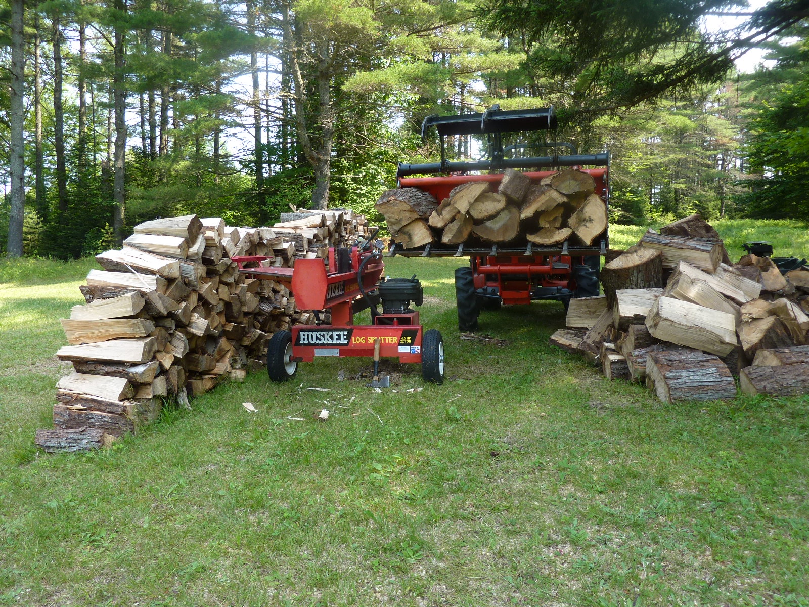

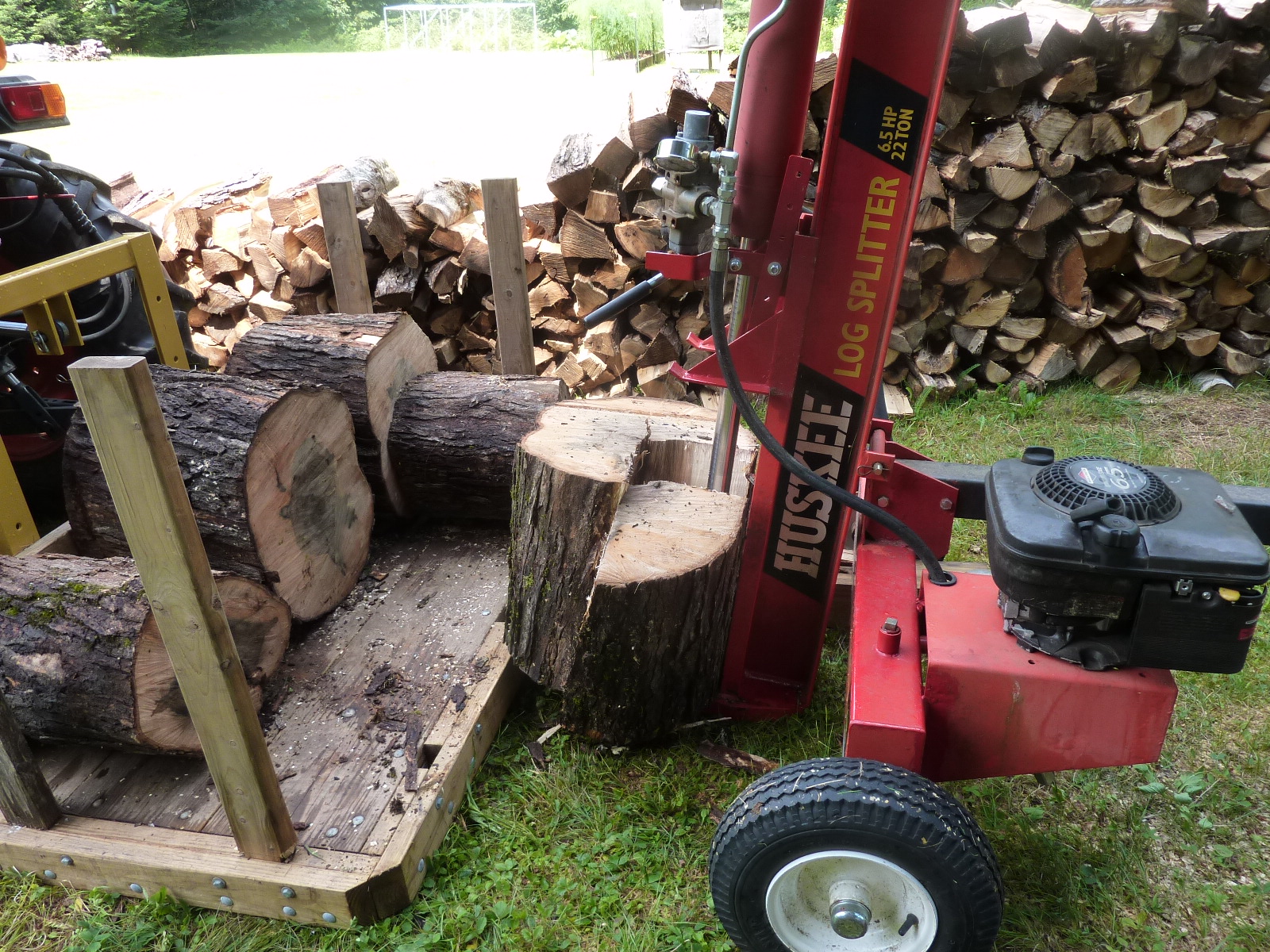

/ Log Splitter recomendation #7
I agree, stand alone is the way to go... doesn't tie up the tractor, less hours on the tractor, and yes lots of times I'll split and throw the wood in the bucket to move it..
