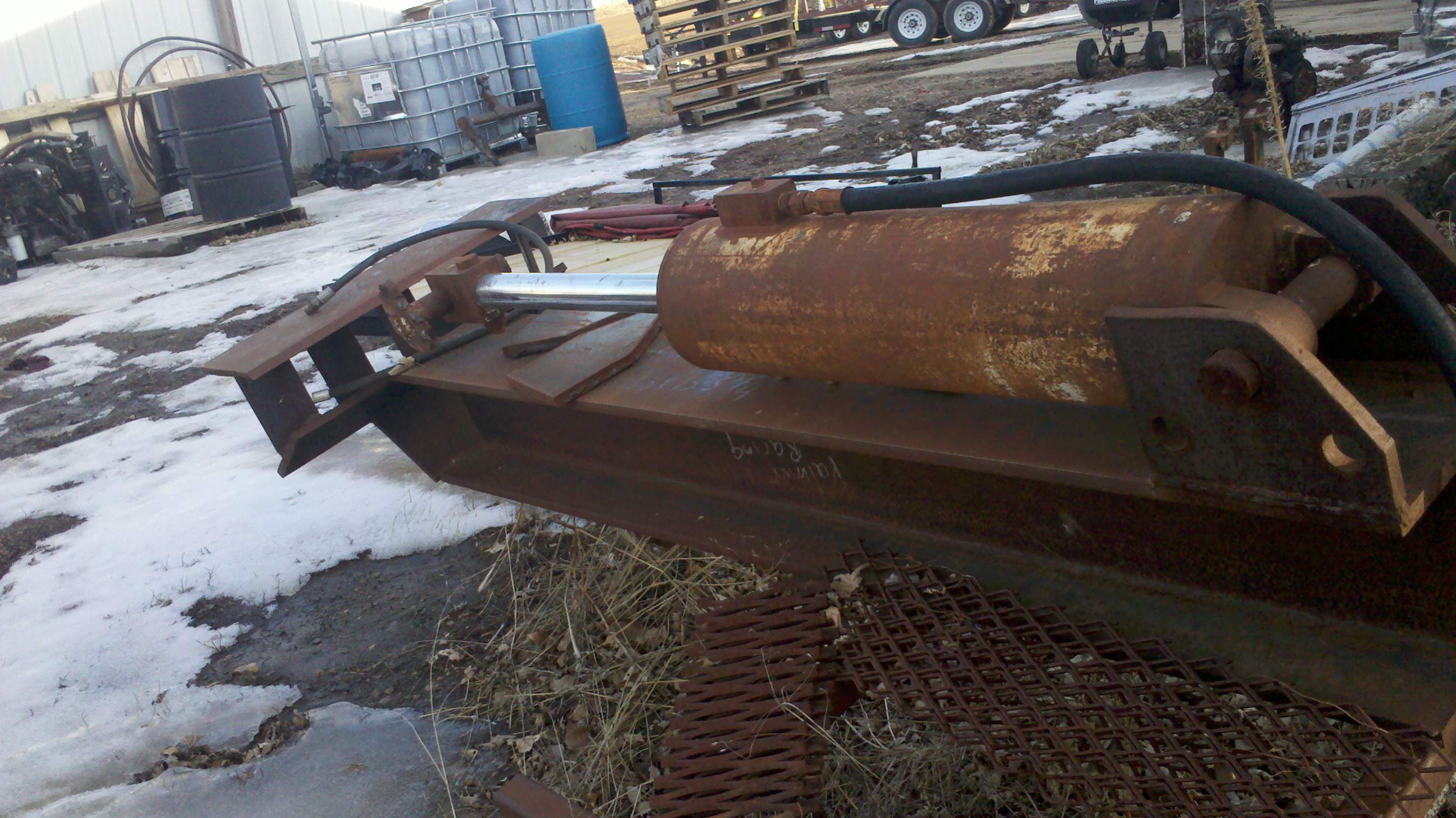

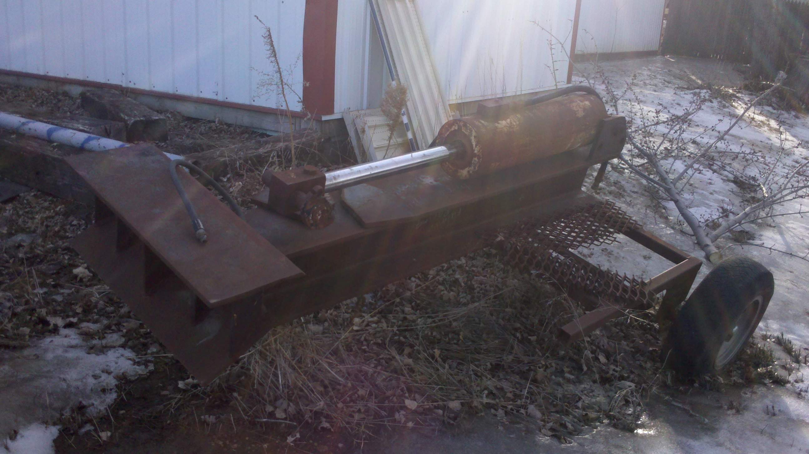

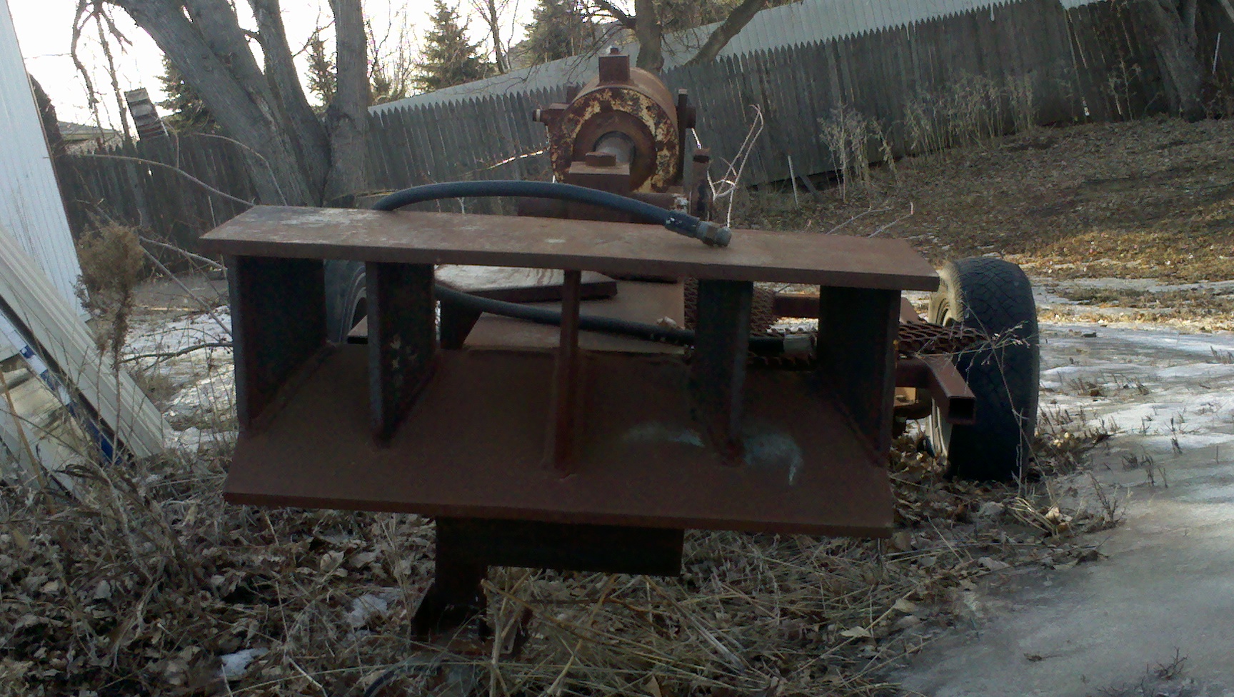

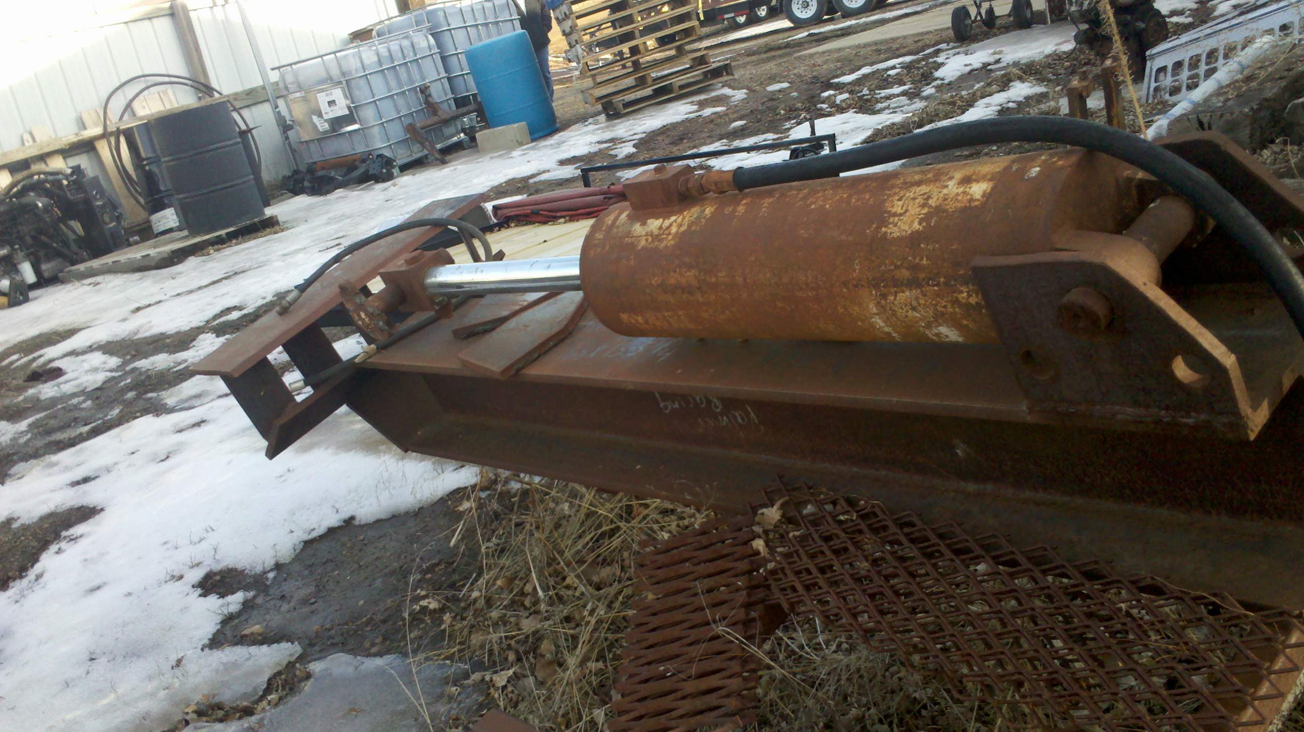

I finally remember to take some pictures of splitter most if it is tacked up lots to do but need to get after it.
so for a valve to run the main cylinder i need at least 30 gpm I am thinking
and need an additional control of some kind that goes on the do3 mounting plate to control pressure compensation?
I talked to the carrier guy that i received the kubota from and he says we can make a little over 100 hp with pump mod and turbo that looks like it will be needed
