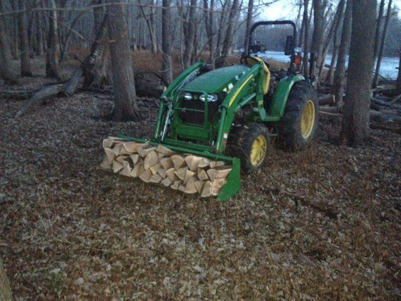

I picked-up a 3-Point Log Splitter. The hoses are too short and the connectors are wrong for my tractor. The existing hoses are 1/2 inch. I am wondering if I can replace the hoses with 3/8" diameter hose? My output is 10 gpm. Also, I have the correct QD fittings for the 3/8 hose. All my other attachments use 3/8" hose size.

#9
All hooked-up and operational. Everybody's help is appreciated!

   / Log Splitter: Hose Diameter #10
Is that the mighty rock river behind you?
