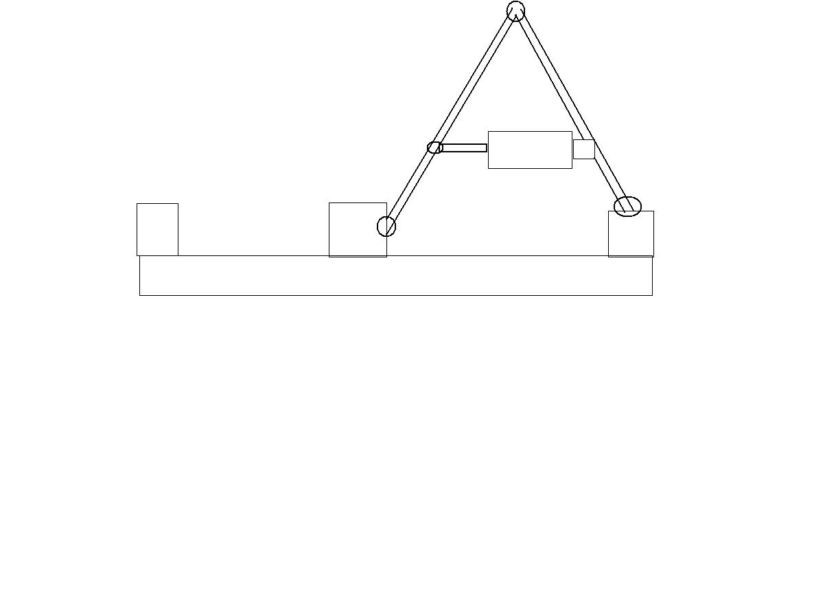

I have two 7" cylinders to build log splitters, but the stroke is somewhat short (15-18"). Does anyone have experience in building a splitter that works like a hinge or scissor action? Any other ideas out there? The cycle is slow, about 1 second per inch with my tractor hyd. but I am fine with that, and could possibly build a 4 or 6 way wedge.

I had a similar thought, but at that slow rate of speed, backing up for any piece that doesnt split at 18" could get a bit more time consuming. I thought if I hinged it somehow I could get longer pieces and increase the rate. I just havent thought of the correct design to get the 2 ends notto move in an arch (or maybe that doesn't matter on the wedge end??) Thanks for the thoughts.
   / Log splitter design for short stroke cylinder #4
Kind of rough but this basic geometry may give you what you want. There will be a large bending force on the links so they will need strength even greater than the main I-beam.

Looks manageable. I had kept imagining the pivot in the center, thus the arch. Thanks for straightening me out.

Instead of making a lever why not make a more agressive splitting wedge? the first couple of inches could be typical but then have it flare out at a steeper angle to finish the job using less stroke.
The ram will still be slow but the splitting action will probably take the same time to complete - you certainly have enough force available with that cylinder.
You could also run two splitting heads side-by-side;)
   / Log splitter design for short stroke cylinder #7
Why not have one cylinder push the wedge and the other push the stop? Or even have the stop on one end fixed with one cylinder pushing a two way wedge and the other stop on the other end attached to the cylinder making it adjustable:eek:. That way you could split up to 36" or split 16" pieces on either side. --Just a thought
   / Log splitter design for short stroke cylinder #8
Or sell the two 7'' cylinders that you have and purchase an appropriate splitter cylinder... I forsee nothing but trouble down this path.
Mike
   / Log splitter design for short stroke cylinder #9
I'd try to build one that had two wedges, no stop. Instead of splitting toward one end I'd split from both ends to the middel.
   / Log splitter design for short stroke cylinder #10
This wouldn't work so well on "stringy", or very green wood, where the initial couple inches of travel will split it, but it is still held together with a lot of "strings" of wood (too many to just pull apart by hand).
