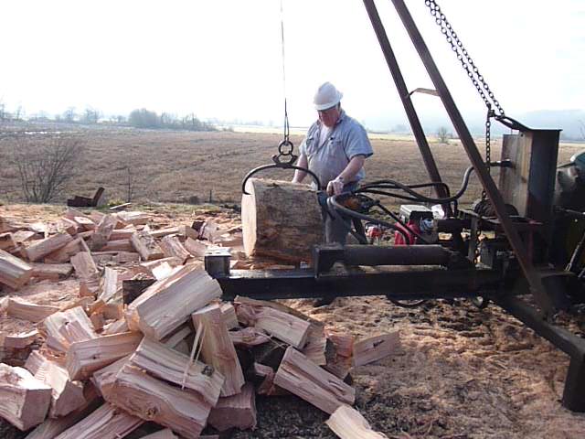

I personally would stay away from those multiple wedges of more than 4. Reason being, I pushed mine right off the end breaking my I beam in the process. Mine is a 3way and it works great for those large rounds. I realize my splitter is more than most would ever need, but I do incounter a lot of wood up to 4ft here in the nw.
For lifting rounds I have seen the hyd lifts and the verticle splitters, but you still have to wrestle the round around as you split.
This has worked very well for me. As I only split the bottom of the round by taking two pieces off the block while the rest stays hanging. The main block usually doesn't split, and you just lower or rotate using the line. There is absoulutely no back lifting, I love it, and you can stand up straight, to me that is a big deal. Splitting a cord or more an hour by myself without breaking a sweat is nice.
For the small splitters most folks are using, I would recommend welding on a lift using a boat winch for lifting those big blocks. By welding say a 4inch I beam from the end of the splitter up and out to center of the rail between the ram and knife so you can reach out with a cable and pick up a block I would think it would be a great help.
I am sure some have seen this, but it works so well I have to share it.
