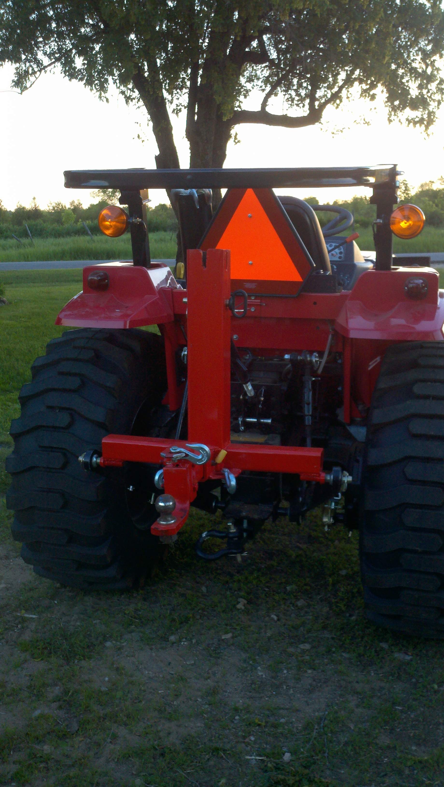

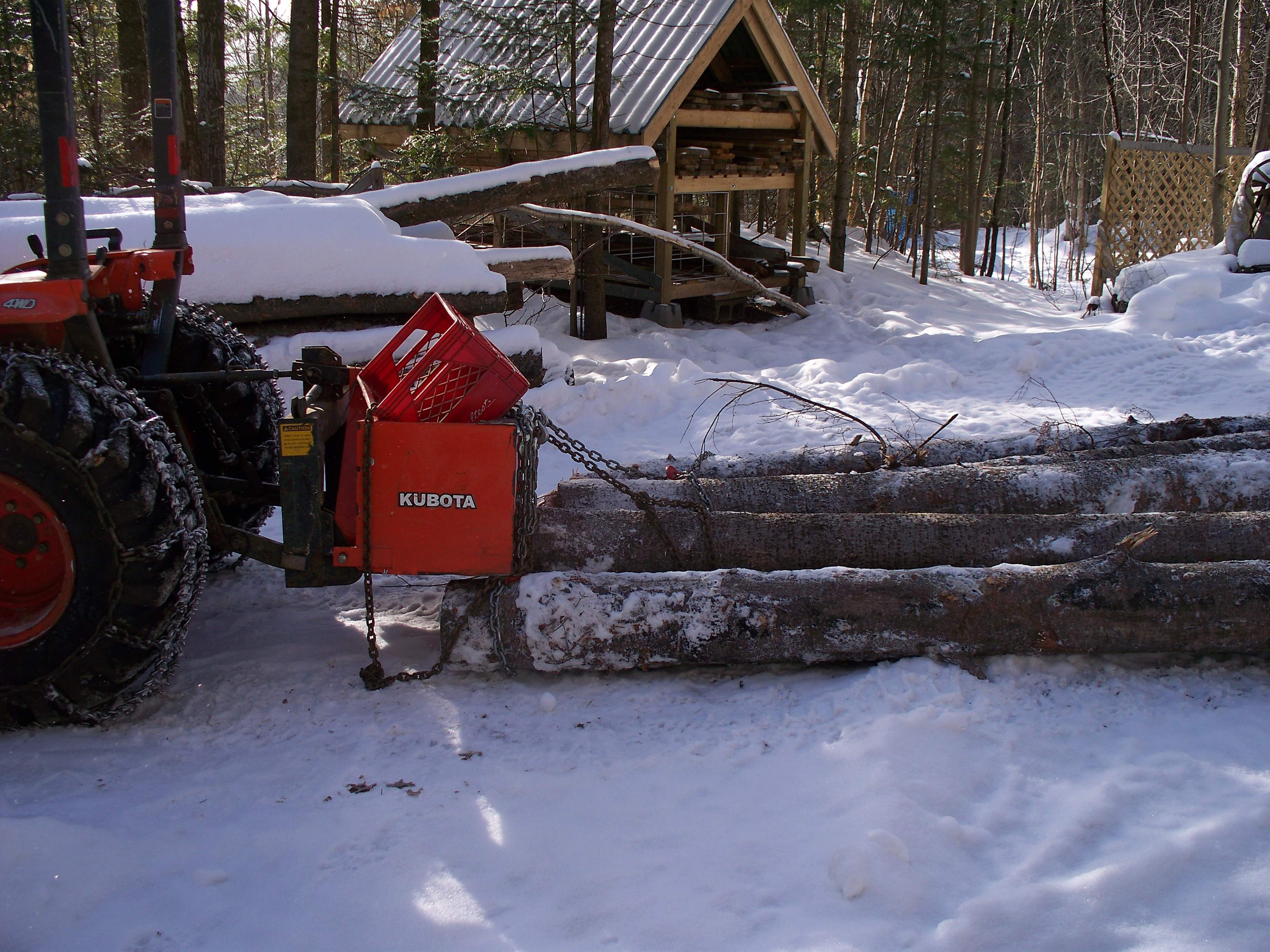

Well, the photo below shows what I plan on using on my Kubota:
It's a 3-point hitch receiver with a welded on chain hook and extra-heavy construction. I will run a choker chain around the log and over the chain hook to lift the log butt off the ground. There will be another shorter chain that hooks to the choker (on the bottom) and goes to the tractor drawbar to handle the pulling load. That way, the majority of the pulling load is down low on the tractor frame, which is safer and more efficient. Really, all the 3-point is doing at that point is lifting the log butt off the ground. Tension in the lower drawbar chain does the pulling.
I looked at a lot of hitch receivers, and this was the best for overall towing and skidding. It's made in USA by a small company in Michigan:
DRJ 3-point Hitch/Skidder
They will paint it whatever color you want. Comes with or without chain hook, and costs $115-135.

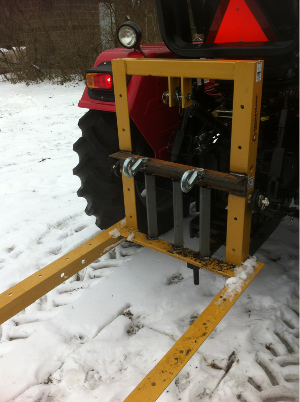

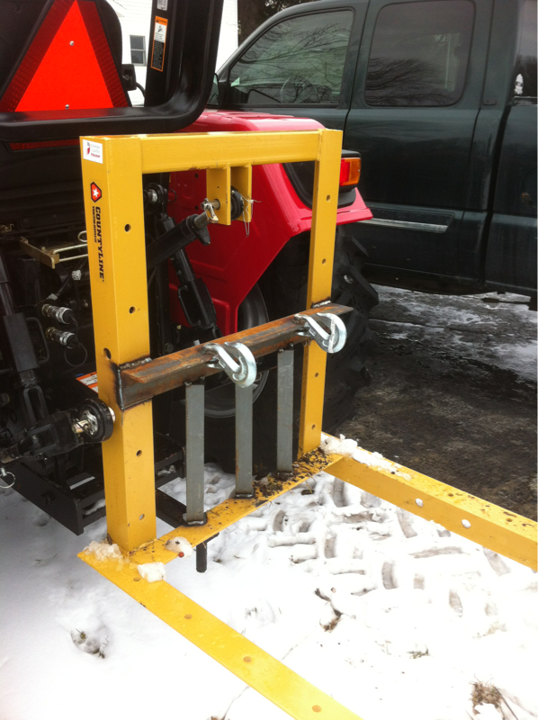

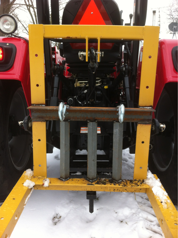

Finished my skidder.... Just kinda shot from the hip. I put another piece of steel across the width to attach hooks to, then welded three pieces of angle iron vertical to prevent the log from swinging forward once it's lifted keeping it from hitting anything. The two "arms" that are at 90 degrees actually help steer the log once it's lifted. I need to prime and paint it, but I used it today and it worked as planned. Money invested 119.00 😊
Be safe!!

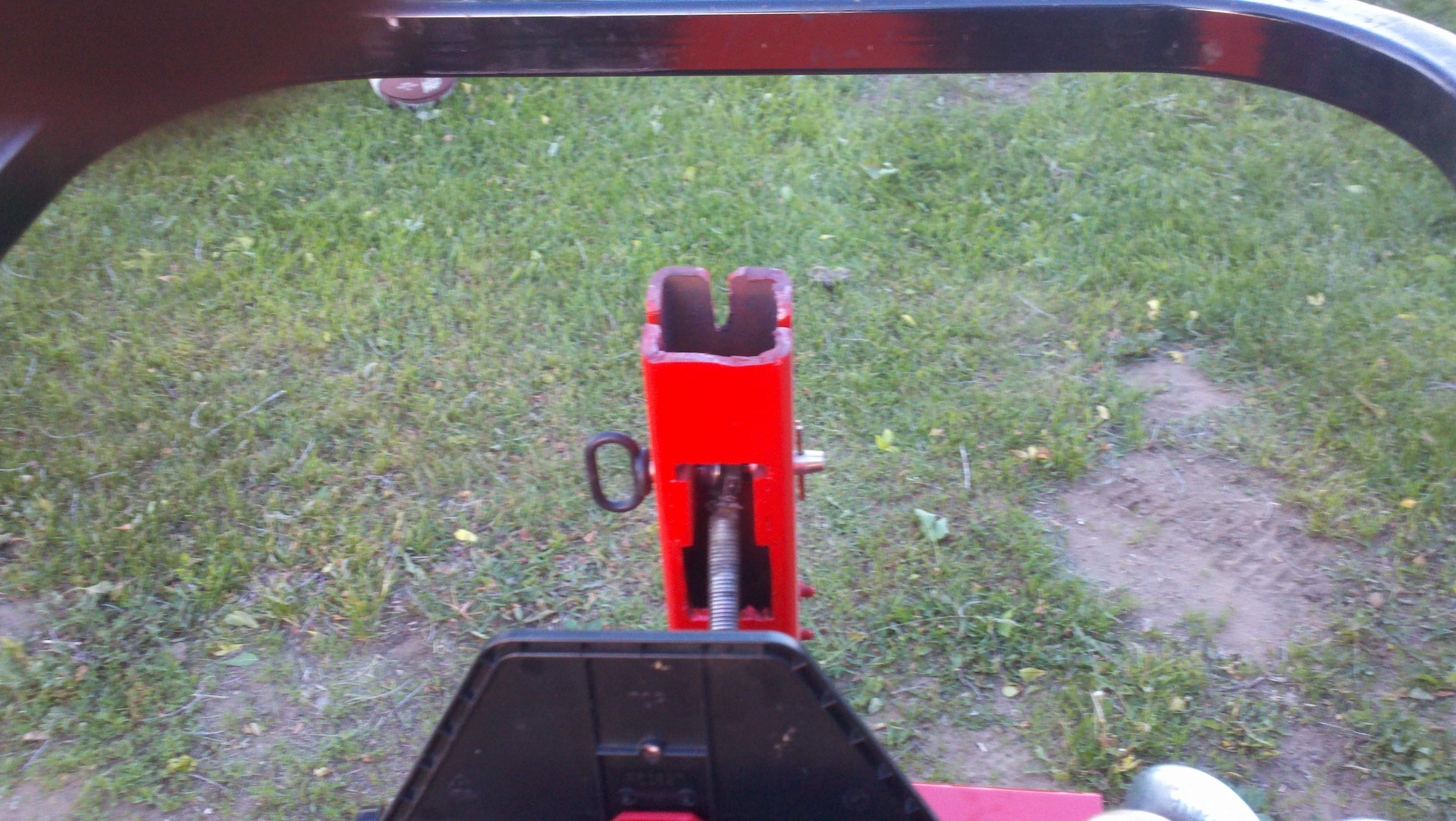

Hi I bought a receiver hitch like shown in picture. Then I added the 2" receiver minus the ball, slipped a skidding tong ring over the hitch, stuck a large, long 8n bolt up through the hole that the ball would have gone into. An adjustable reciver works good for longer tongs. I broke my first tong making a to sharp a turn, but bought a better tong and am careful on sharp turns. I don't even have to exit tractor, just lower 3pt. hitch and tong onto log, tong automaticly spreads. When you raise 3pt. log raises up ready for transport, wala. Hope this is clear I have no pictures. I have used mine for years. Cheap, efficient, and fast. Jim
Be safe!!
"Z"
That looks real good -- nice work!
