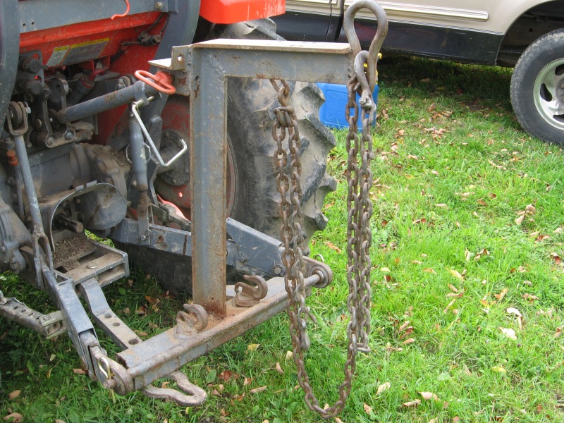

This is my log hauling method. It keeps the end of the log off the ground so that you don't catch it on stumps and such. I welded it together out of steel I had laying around. I use a 10 ft' chain with a choaker hook .

Toadhill, I like that idea. Very nice. I usually just drag them with a chain also.
