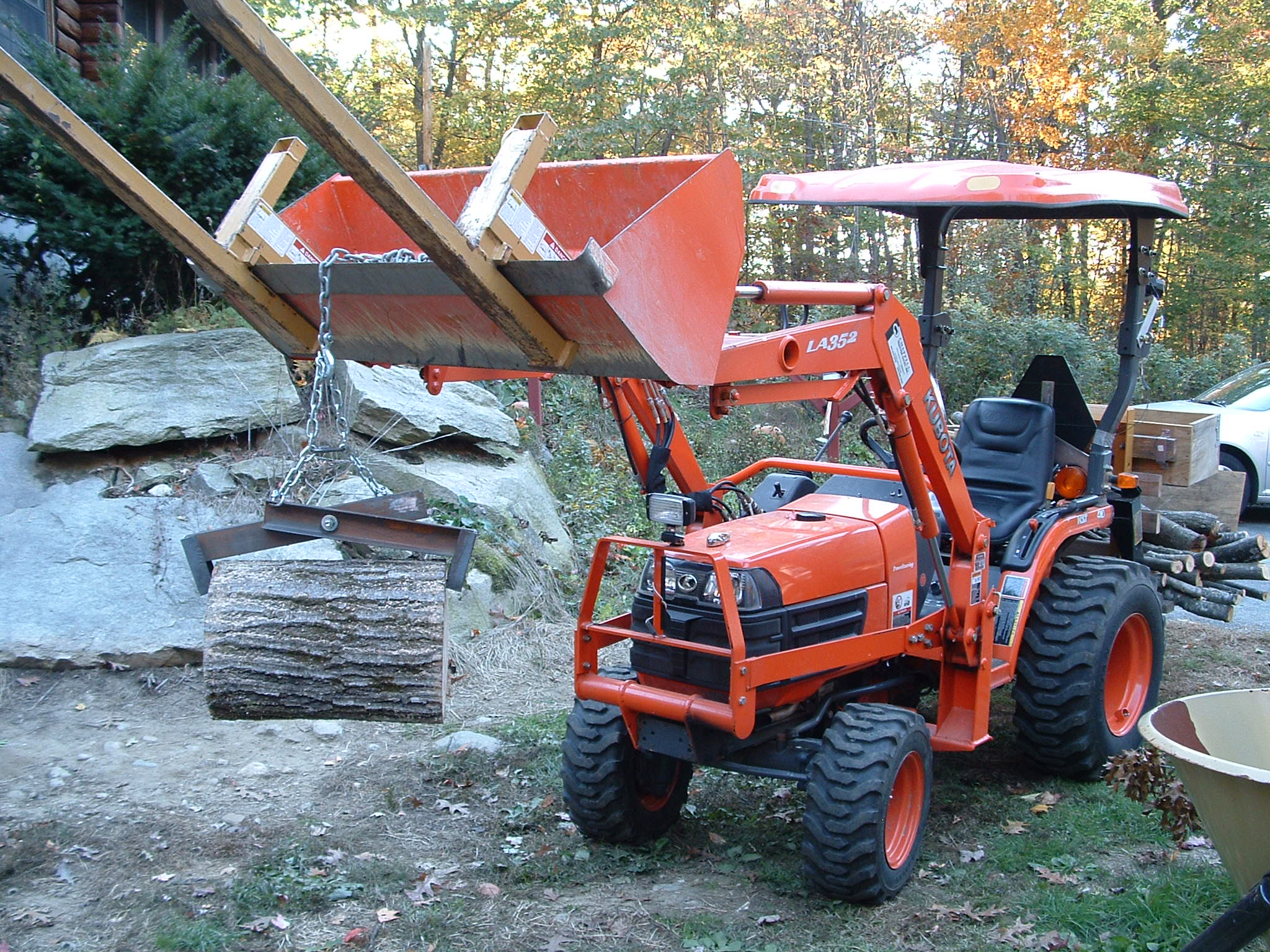

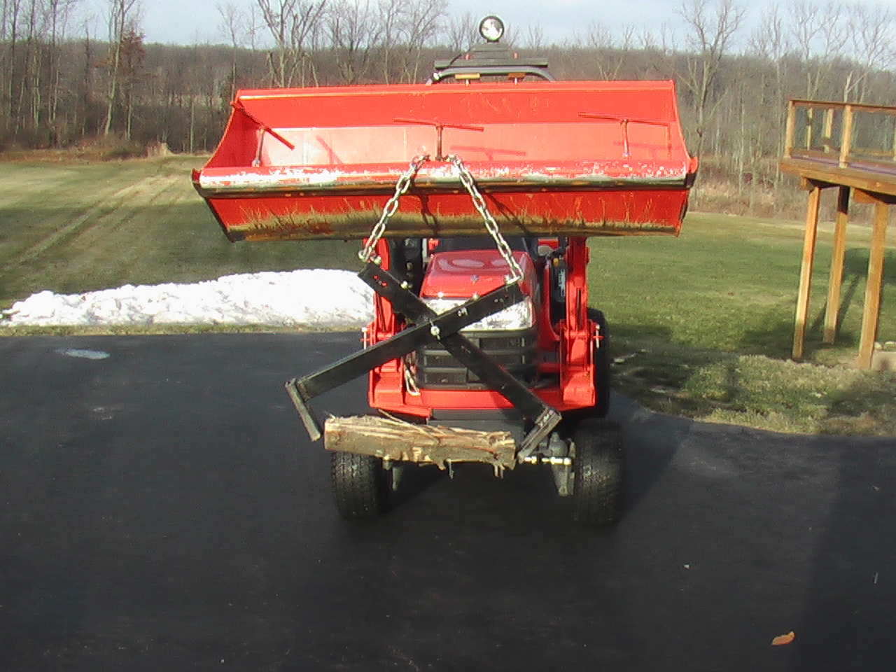

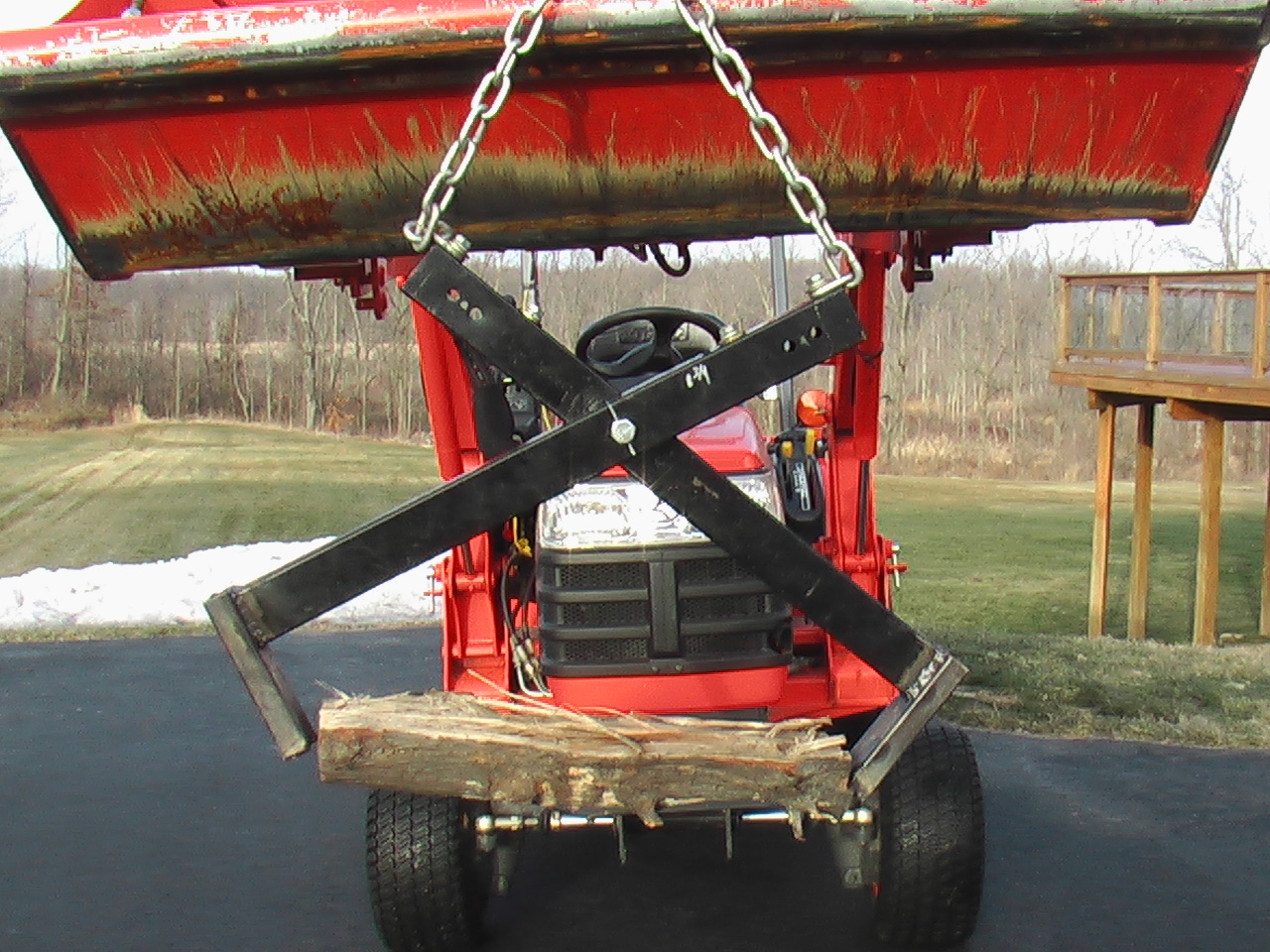

I found this idea somewhere on the web a while ago. I looked and looked to find the post again to give the proper credit but I just can not find the post. The feller I copied this idea from used 3" channel.
Well, I used what I had on hand and that was some 1/8" wall tube steel from an old Reese tow bar that was just taking up space in the garage. Chain is also from the tow bar.
I welded some small nails on the bottom of the tongs to help with grip. I have not had a chance to really use these yet as all my wood is split for the winter so the pictures are just "poser" shots with an already split piece of wood. I look forward to these saving my back next spring.
The pipe over the cutting edge is only for clearing snow. It's replaced with a toothbar in the spring and the chain will hang from the teeth.

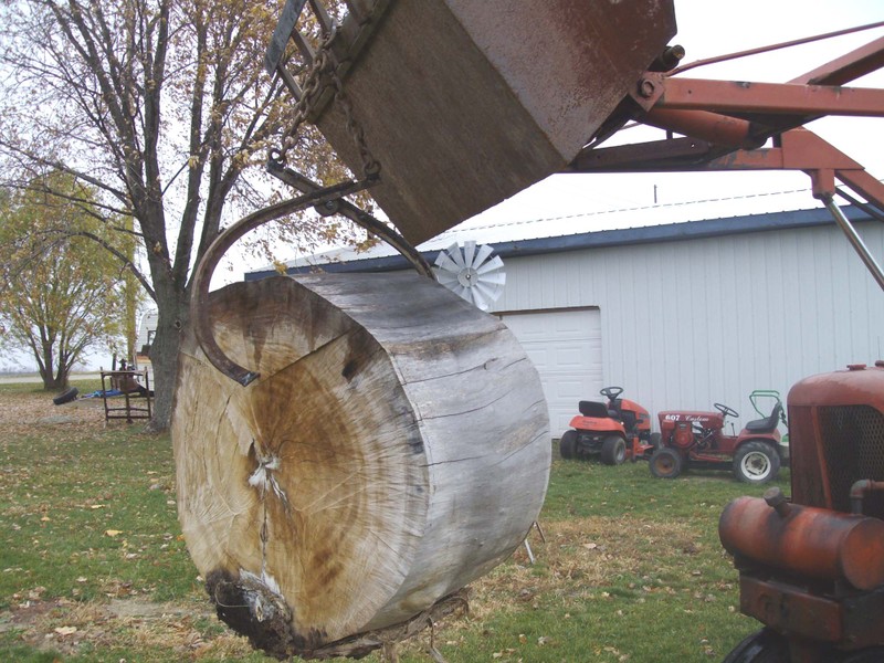

Made these out of some 3/8 X 1 inch flat stock. Forged the hook part then welded another strip on the back side to form a "T" shape. Couple of grade 8 bolts make up the teeth. Sad thing though...after I got them all done,I realized I use the tractor to run the splitter!!! Had to build another power unit.
The flat stock over the bucket teeth is for moving snow. I'll grind off the tack welds in the spring.LOL
