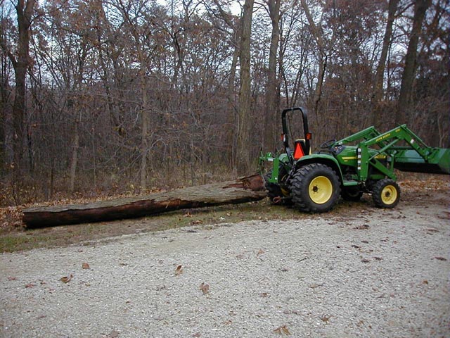

Nothing in your Bio, so don't know about whom I am sending this to, but will assume you have a CUT that has a 3pt.
The pic shows how I pull logs up out of the woods. With the FEL on there is good counter weight to keep the end of the log off the ground (cannot dig in) and good traction on the tires from the weight of the log. The I-match hitch has a hook that holds the ring on the logging tongs.
