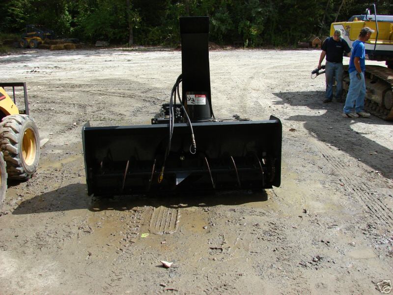

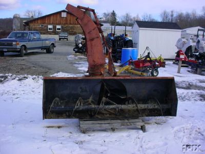

Reversing the direction SEEMS sensible until you look close. The shaft going forward needs to be about 12" below the pto centerline. That means two 12" diameter gears or three 6"+ gears - either way it's an expensive gearbox. A 2-row roller chain is much cheaper to make. Erskine uses 3 sprockets, one used as a tensioner only and there is no direction change.
If you look at the other end of a turning shaft, its going the other way.
The impellers on Erskine front-mount-rear-drive and on their rear-pull units turn CCW with their chutes mounted to the right. On their rear-mount back-up units the impeller turns CW with chute on the left. (Pics below)
I'm pretty sure Erskine makes their own back-to-front drive setup. The reason I think so is it has so much "family resemblance" to the rest of the blower - thick steel, heavy welds, same fasteners, etc. Actually the whole thing is similarly over-designed. And it has a low-production-quantity look to it. There is no nameplate on the chain box. They may buy them - but from a local machine shop.
Lorenz has a back-to-front kit but it's quite different up front, using a hydraulic cylinder to tilt the blower head up and down.
There was another back-to-front kit years ago (can't think of the brand) It used an exposed chain drive with 3 sprockets that changed direction. It was very light-duty - more for garden tractors.
I've read at TBN that Pronovost makes a kit too - but I didn't find it on their website.
Pic on the left is rear-mount back-up. The other is a front-mount Erskine. The impellers go in different directions.

I would have to guess that since almost all PTOs rotate the same direction that you shouldn't have anything to worry about as far as the impeller turning the wrong direction. Also must blowers I've seen use mostly stock parts so rebuilding one shouldn't be too hard, probably not too expensive either. Does it have a gear box for the PTO and a second gearbox at the impeller? I would think the only issue could be if it came off of a tractor that had a different PTO speed than 540.

I had one of those front rigs.
The rear was 3 sprockets, HD chain long ladder underslung, and short PTO shaft up front.
It used standard Bervac blower (500 RPM).
The rear sprockets caused the reversal to occur so that the blower would be standard rotation..
If gears were used the front would turn backwards.
