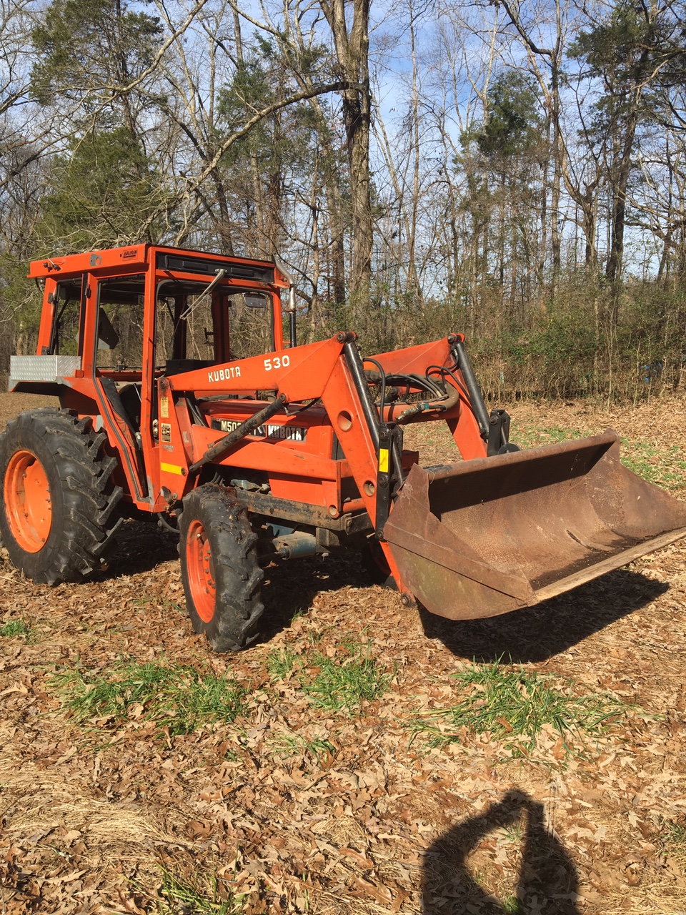

My M5030DT is built like a tank. Has front autolocking differential. With hilly East Tennessee makes a huge difference.
Hillside mowing, turning uphill and loader operations are greatly enhanced and unnoticed until you try the same with a tractor without it. L3800 and M59 don’t have it. Not sure what tractors have the locking front diff now and didn’t get much help from the dealer. Was hoping the M59 could replace the M5030. The older tractor is a real puller. I know tires make difference.

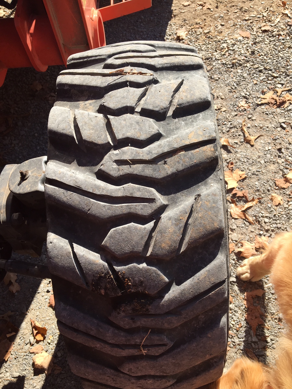

Grooving the front R4 tires of M59 helped traction.
Maybe I need to quit climbing mountains.
