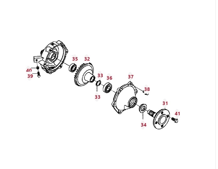

Massey ferguson gc1705
The front left wheel is stuck on my massey ferguson gc1705. Can someone help me with this please?
   / Locked wheel #2
Is it stuck in the mud, stuck on the hub, stuck and won't turn, stuck and won't roll. How exactly is your wheel stuck? The more info you provide the better your chance of getting a solution to your problem. IE, 4 WD, year model, etc. Tell us exactly what's happening.
Welcome to TBN.
   / Locked wheel #4
I believe the 1705 is front wheel assist so if wheel does not turn would suspect gears or axle bearings are bad on that side.
Link below is pretty good break down of how to fix front axle seal, but it shows you all the parts and such... Yes it is for a 2310 but its identical to the 17XX series....
I presently am in need to replace seal (#16) in right wheel assembly so I found this and it pretty well describes the internals of the front axle assembly....
Also MF parts book...
