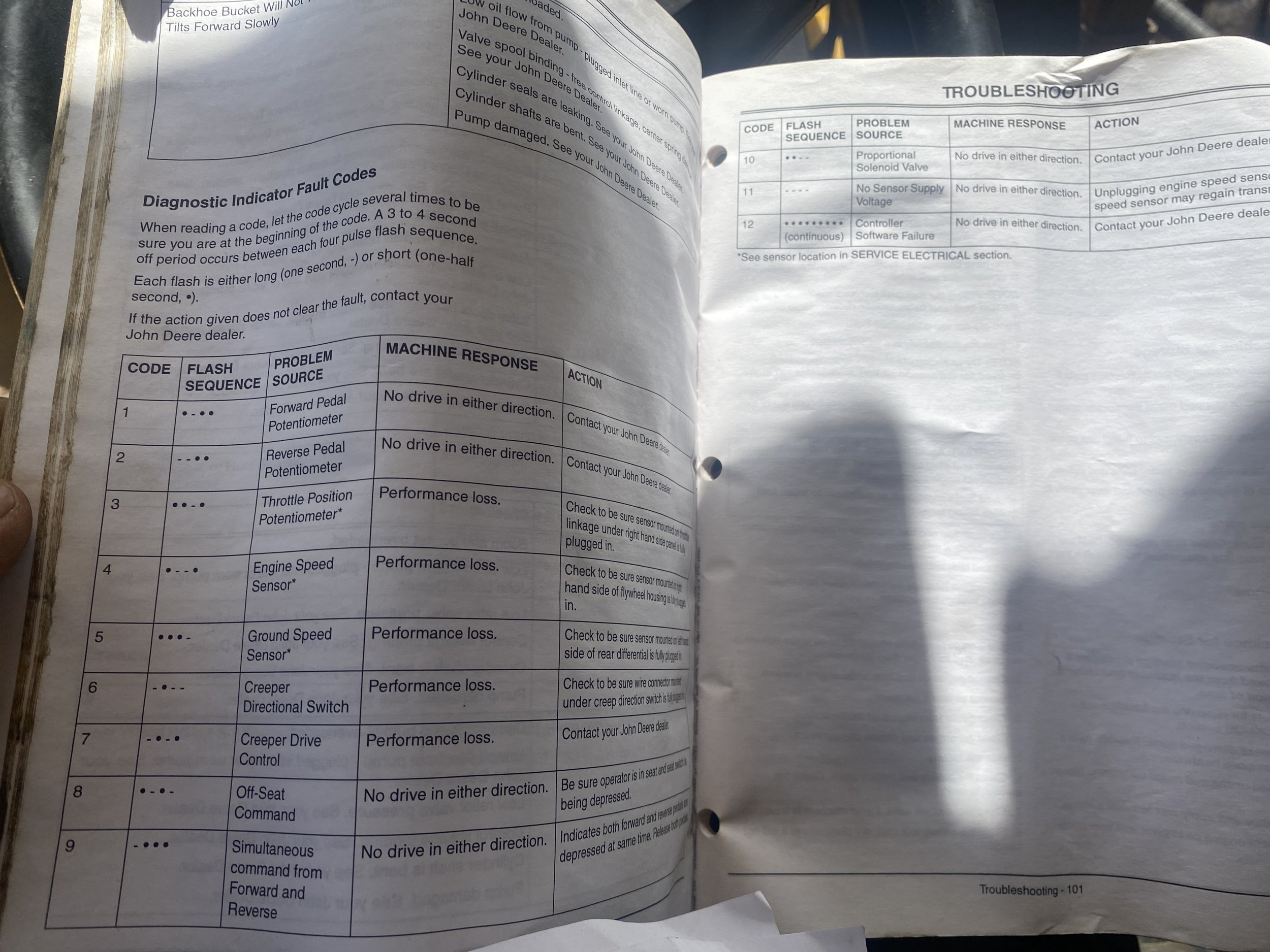

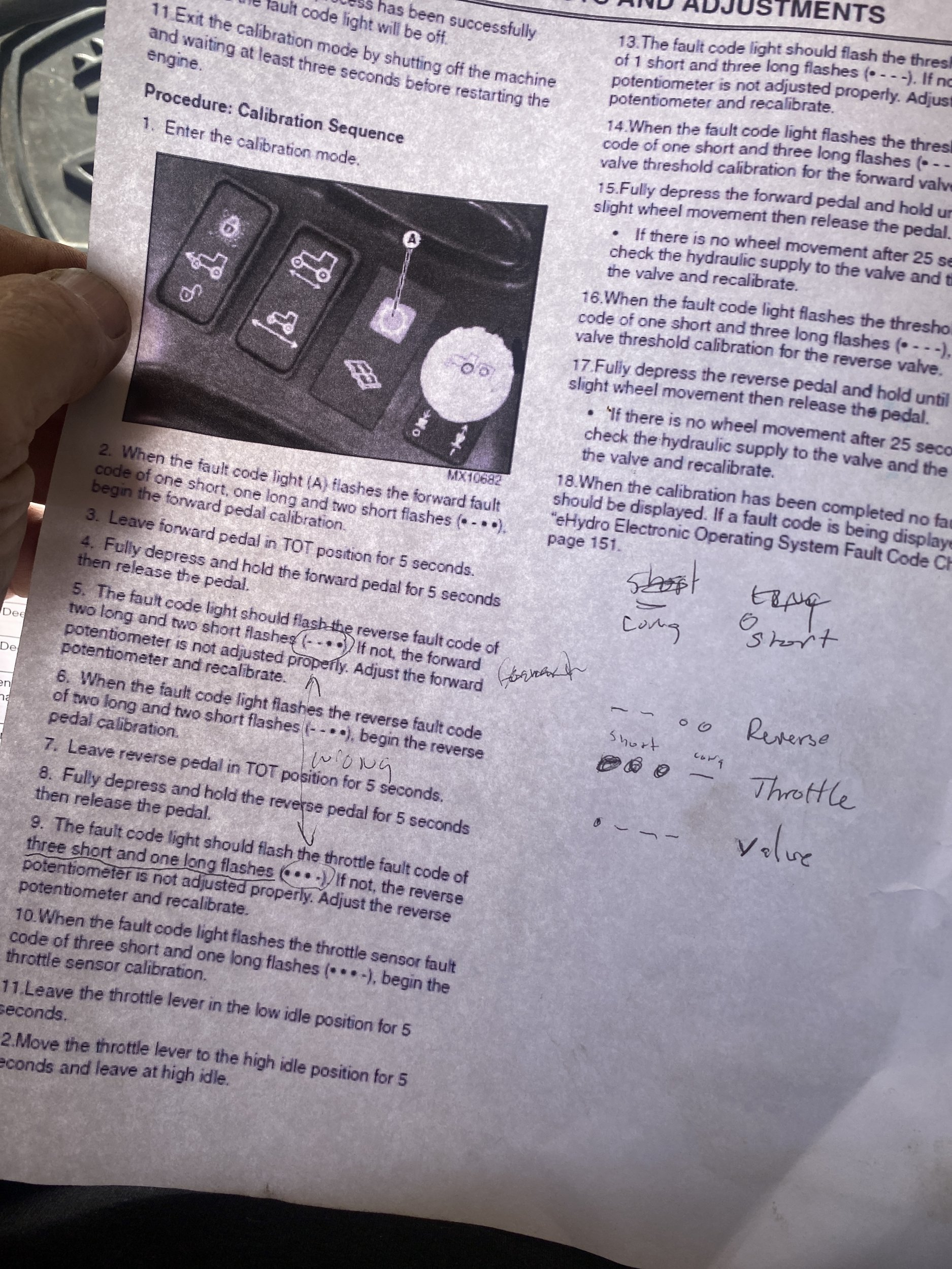

So. Where is the proportional solenoid valve located
   / location of Proportional drive solenoid 110 tlb JD #5
Reset procedure without computer
