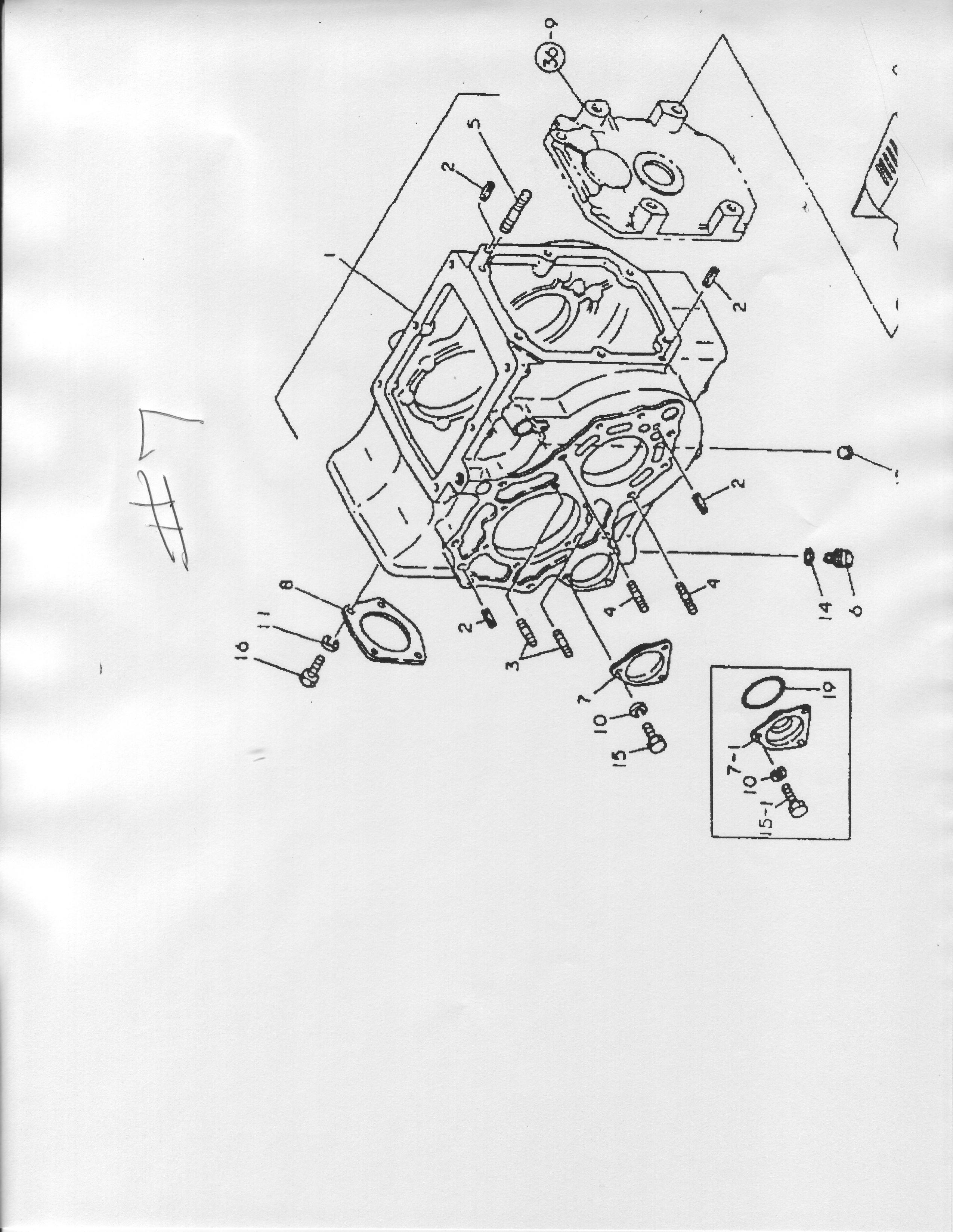

I have look and I can not find the location for the hydraulic screen for my YM 1601D. Maybe I am missing something. Does it have the circular plate with 3hold down bolts? Can anyone tell me where it is.

I don't have your mod. But, If it's like the rest . Look under the pto_Or, follow the suction line from your pump

Look below the left brake housing, toward the front of tractor.

Check # 7

Frank did you ever find the screen. I have same tractor and have removed the three bolts for the hard line on the tranny but cant find the screen. A guy told me to remove right rear tire to have room ,but I removed the screws with the tire on just need to clean that darn filter but can't find it. PS I really I'm pretty blind but come on it day light wheres the screen hinding at?????
   / Location of Hydraulic Screen - YM1601D #7
OH OK I FOUND:thumbsup: it yeppie. Oh my gosh yep it was plugged up with a lot of fines(dirt) Well got it pretty clean with gas carb cleaner more gas and air. I'll replace it on next service as it looks like it should be cleaned better. OK so clean hydrol filter,fresh 303 new engine oil filter, fuel filter ,air filter and eng. oil also replaced the four o-rings for the fel levers.:confused2: Happy happy Yanmar. I hope when I get it back together. Say alittle pray that theirs no oil leaks as I had not ordered gaskets:mad:. DB
