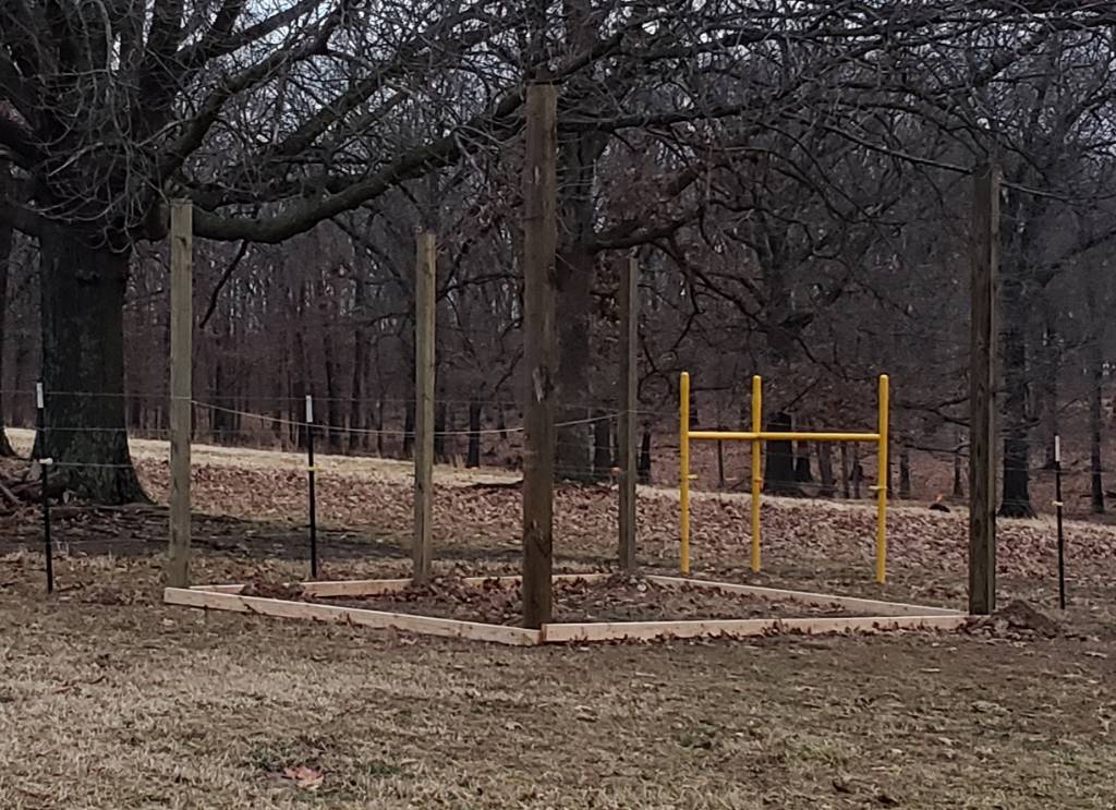

Am building a 10' x 15' loafing shed in my new paddock. It will be a three sided (front will be open) structure, 6' high in back, 8' high in front, wainscotting on the lower 33", and metal siding the remainder and roof. Rear posts are 4" x 4"and front posts are 4" x 6". Yesterday was Day One and spent the morning laying out the lines and digging the post holes using the tractor and PHD. Then went and picked up the posts and a few other supplies. Today was Day Two and got the posts set in place with concrete. Will take some pictures at each stage and post.
Really happy to have a tractor....sure has made it much easier and quicker to do this project.

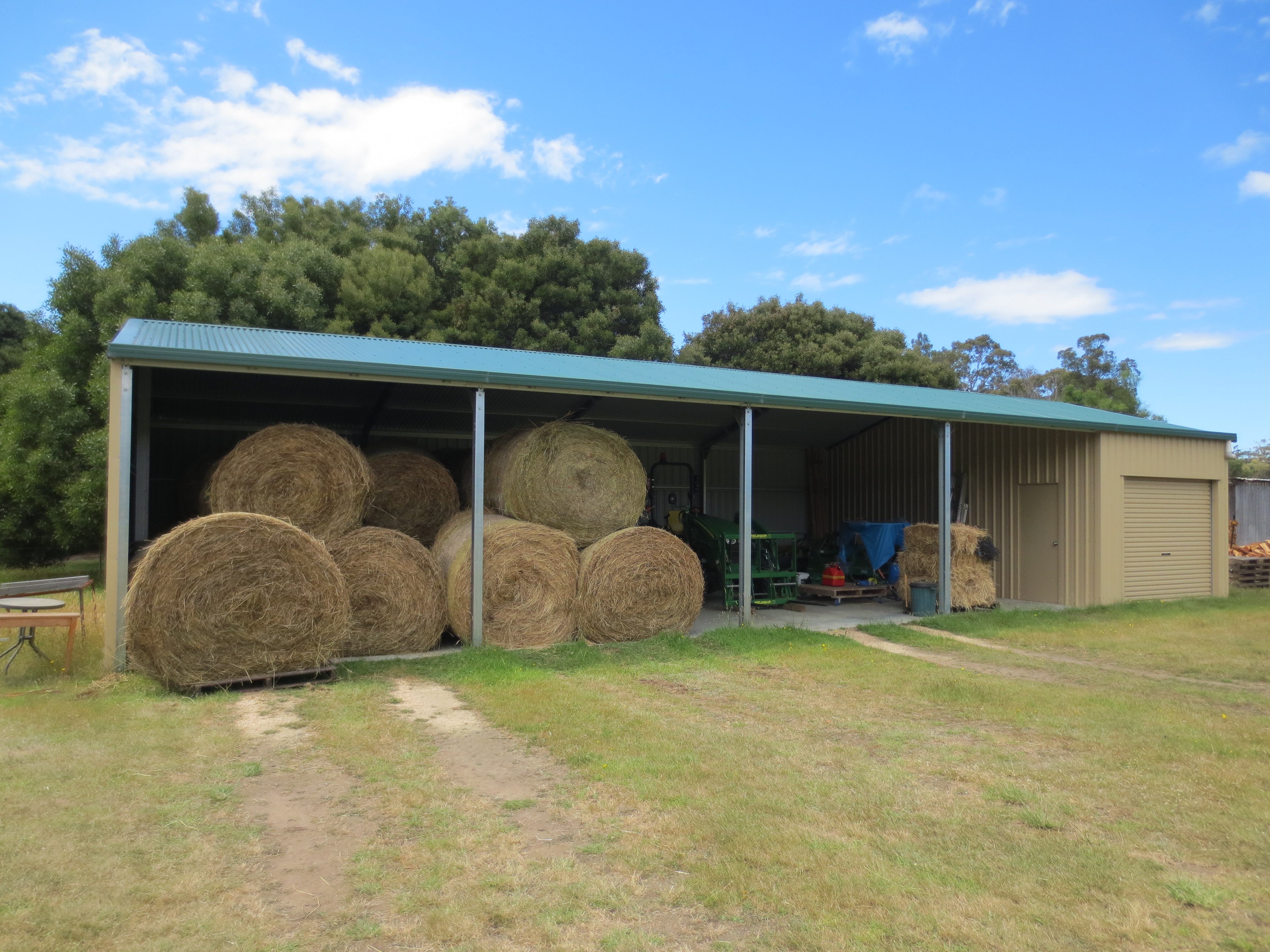

A "loafing shed"... never heard the term before but a quick Google shows a three sided shed, single to several bays. Everything from a run-in shelter for livestock (horses) to a tack room + stable.
Ok fine.
Here's my 5-bay shed (concrete floor):

Wagtail, very nice. Around here, that would be described more as an equipment shed.
BTW, looks like you have room for some more equipment. ;) :thumbsup:

Here's a couple of pictures of Days 1 &2 work. Next step will be to put the wainscoting on to give it more structural strength and the I will cut the corner posts down to size and install the front ridge beam. Hope to get that done this weekend.20190107_083830.jpeg20190107_083805.jpeg

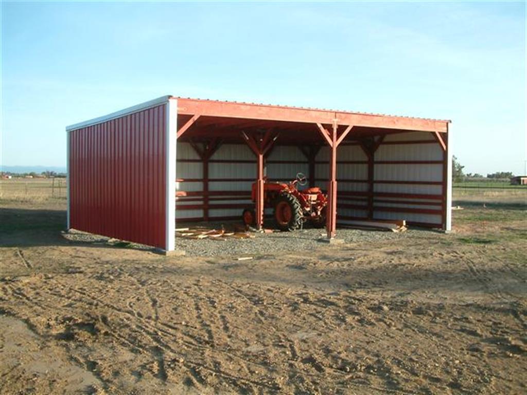

I built one of those sheds in 2010. It's 20 x 28 ft with 12 ft front height and 11 ft rear height. Metal sides and roof.
Good luck
