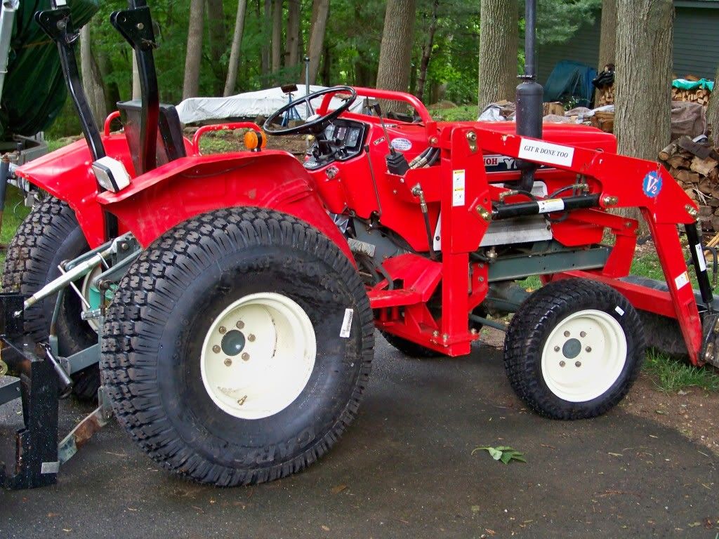

Finally got my tires and rims....just installed. I haven't tried them out to see how well they do on uneven terrain but ran them over the lawn while it was soft and wet. It was also raining - no problems, no ripping it up.
BEFORE:
AFTER]Yanmar 2020D - Public pictures by divedivediver - Photobucket[/url]
   / Loading Turf tires #7
Those sure look nice! Did you ballast them? What did you use, and how much? Let us know how you compare them for loader work, pulling ability, and so forth.
   / Loading Turf tires #8
My mouth sort of drools. Can you tell any difference with your ground speed in gears. My understanding the turfs are just a little bit smaller diameter. Just wanting first hand info whether you can tell any difference.
   / Loading Turf tires #9
Looks very, very nice. I'll have to add those to my wish list. :thumbsup:
So far I cannot tell any difference on ground speed - but I am probably not the guy to ask since I do not mow or use the tractor at consistent speeds. I did have them ballasted with 31 gallons each of rim guard. each tire/rim weighs in at 460#. I have to add that I was pretty concerned about how hard it would be to install a loaded tire onto the tractor. Even with the tires flat on the ground I could lift them vertical and roll them into place...with a little finnagling - I got each of the rears on in about 5-10 mins. Very easy for a guy who weighs in at 170 lbs.
They are a little shorter then my rice tires. I measured a before an after for ground clearance and it dropped about 1 inch. I was glad that it wasn't more as I use this tractor over rockly uneven terrain.
Also - these are 13.6 X 16 (rear) and 25 8.50 X 14 (fronts).
Next step is buying some chains for added traction in the sloppy parts of my property and for the snow....Any suggestyions on where to get chains? 2 link or 4?
