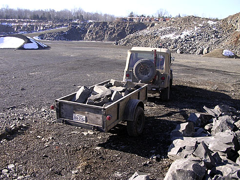

LMTC the trailer is a box, end gates are hinged on the bottom, I have to slide it in from the back.
Goaliedad thanks for the shared experience. If I take baby steps I am sure I will get it done.
