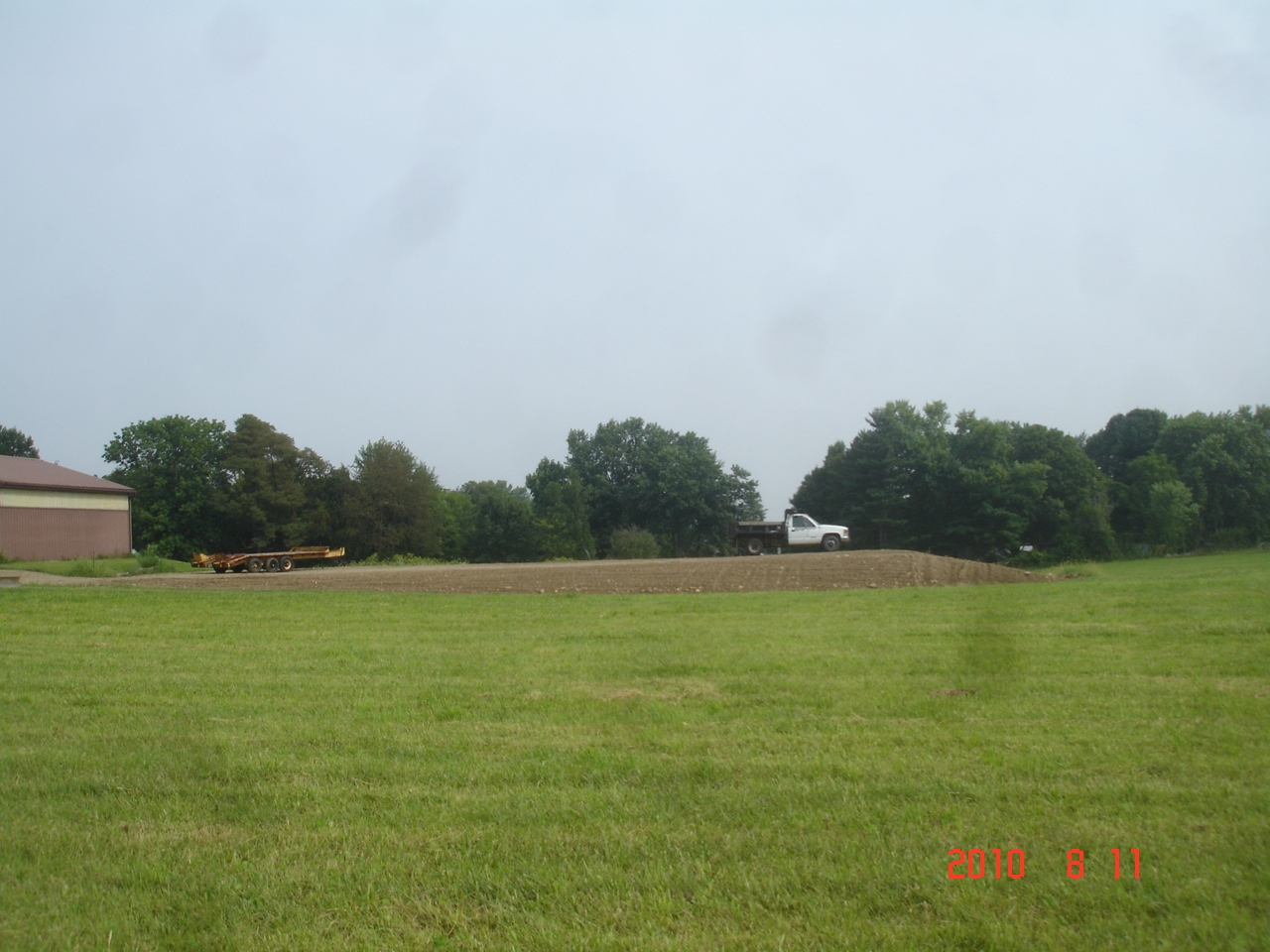

On the other hand, I've included a picture of a pad I built for my new horsebarn. You're looking at approx. 700 loads/2800 tons of bank run material, hauled on that little Chevy dump truck sitting there. I hauled another 35 loads to level up a pad for a new shop.
Material was $1.00 per ton, and took right at $4.00 worth of gas to make the 4 mile round trip. I could load all day on less than 10 gallons of gas in my old backhoe. I calculated it up to be right at $2.50 per ton hauled.
It took 61 days, to load, haul spread, and compact that approx. 3,000 tons of fill. I'm retired, so that was a huge help. My time, versus paying someone else to do it came in to play.
I sold the backhoe, for right at what I had in it, so that helped a bunch too, on the over all cost. In my particular case, it was well worth it, to do it myself.
