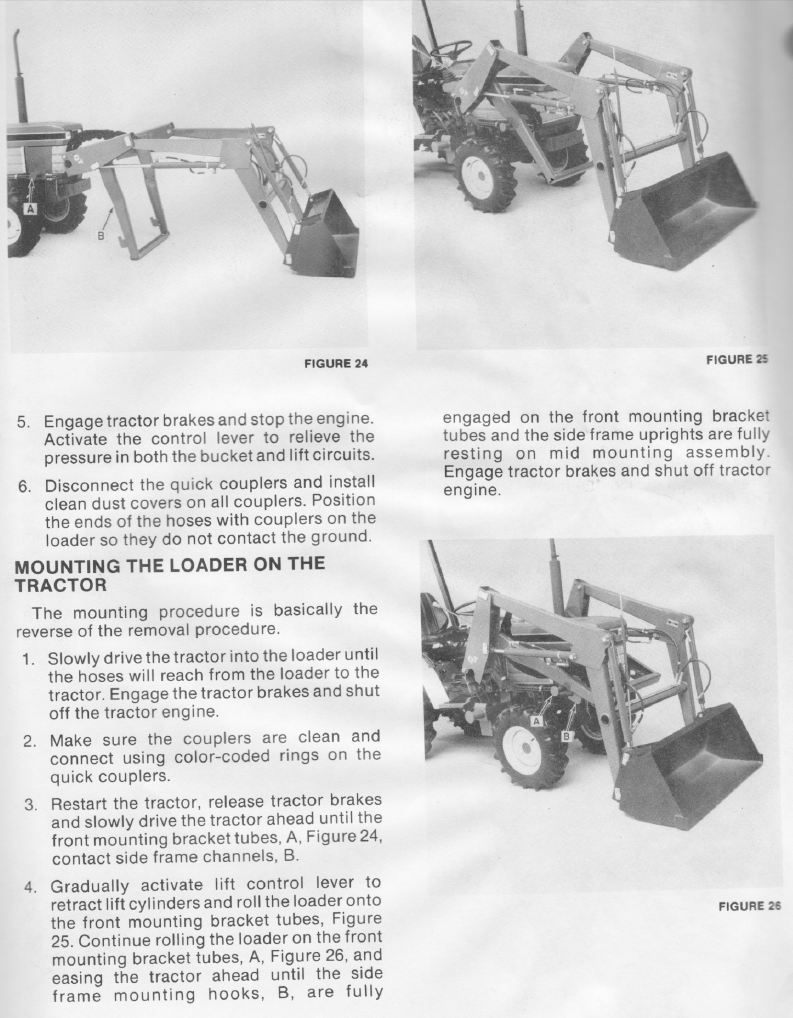

7108 ford front end loader removal-looks straight forward,just wondering if theres a porven easy way to remove. Looks like there is a bolt on both sides of the bottom bracket,remove then flaps lay flat,do I leave bucket flat or what is best position ? Does it require weight in the bucket ?
   / Loader removal and re install #2
the only thing i do is shut the engine off and release my valve pressure by rotating the joy stick in all directions a couple of times. if you don't do this putting the quick disconnects back on are a real pup. if you leave the loader in the sun, it may build up pressure and make the quick disconnects tough also. other that that put it where you want it release the pins and roll the bucket, should lift right off and opposite when putting back on. hoses come off last. piece of cake after the first time.
   / Loader removal and re install #3
I took my 7108 loader off for the first time this weekend and it went pretty easy. I have a manual which is pretty good, if you don't it's pretty straight forward...
pull any pins and bolt and let the flap drop down that holds the loader to the rear supports.
Take off any straps securing your loader lines.
Leave tractor in neutral and start to extend the loader. You'll see it pull away from the rear supports and then start to back up slowly while continuing to extend the main ram of the loader. The front hooks will disengage and at the same time a sort of stand comes down from it's position just below the grill.
Key is the manual says to fully extend the loader, and by doing that the stand comes all the way down and pulls the loader off the front tractor mounts. Let the loader push the tractor back as much as you can since you don't want to pull away from the loader before the support is down.
Overall pretty slick system and pleased with how easy it comes off.

Place the bottom of the bucket flat on the ground. The "kickstand" should be part of the loader.

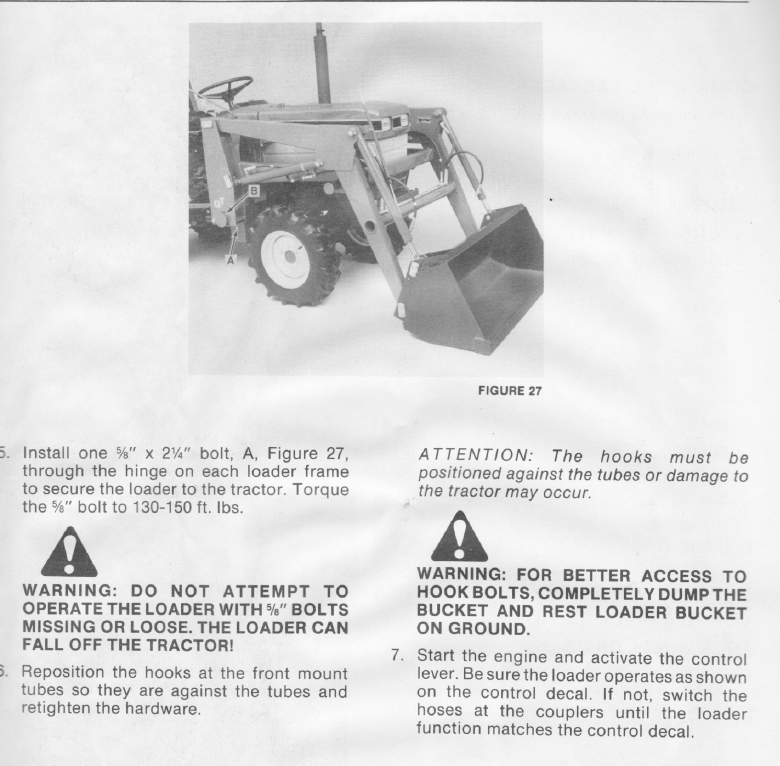

I know this is an old post but thought the info should be available to others here
