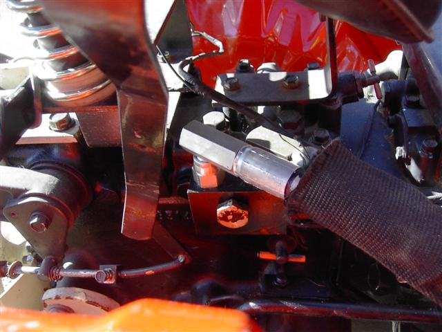

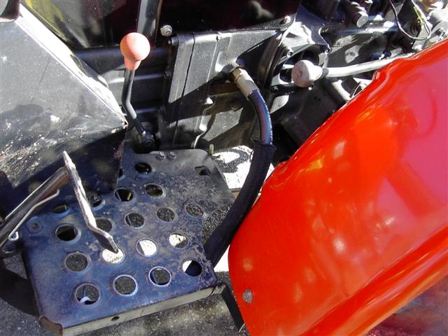

I would send you to Koyker first. Several dealers who post here regularly, sell Koyker. When i was looking for a loader, i found very few who made mounts for Yannies. I ended up finding a used Yanmar loader, but i did get reasonable quotes from a couple dealers who frequent this forum...... just happened across the used loader before i bought new.
   / Loader question #8
Ductape,
Did you ever get that rusty old loader cleaned up and painted?:D I remember the pictures when you bought and installed it. You had a load of firewood.
Did you connect to the hydraulics in the standard method of cutting the line or did you connect to a block under the seat? I am trying to remember?:confused: I am thinking about a loader too and have a 1510D.
Mike in Warsaw
   / Loader question #9
Mike,
I have not painted it yet.... spring has barely sprung here though. I still hope to do it before too long. I need to get some bucket hooks welded on first though. I did not cut the hydraulic pressure line. I tied into the hydraulic block under the seat. It was very easy once i got my hands on a copy of the factory manual. The hardest part was finding the correct pipe plug to install, no one locally had one in stock. If you want.... PM me and i may be able to scan and email you the pages, or i'd even mail you a hard copy if need be. Another TBN member did just that for me.... from the UK no less. I suspect you will need metric hardware, where mine was SAE, but i'm sure the process is the same.
Scott
   / Loader question #10
Looks something like this.
