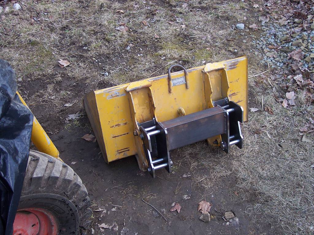

i was just wondering if anybody has made their own version of a quick attach for their loader, i am looking for some ideas, preferably on smaller tractors, pics would help, thank you
   / loader QA #2

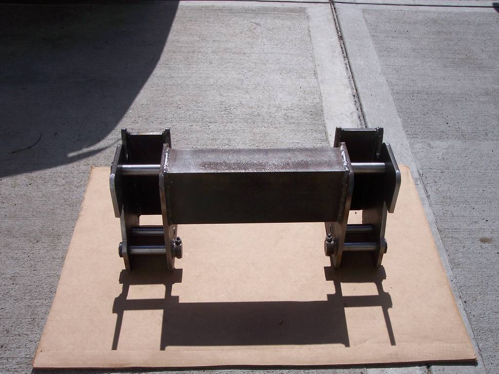

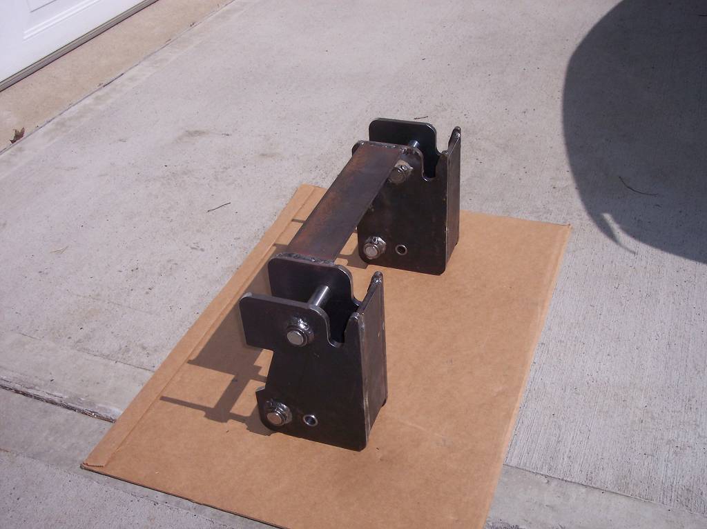

I wanted a quick attach for a uni-hoe (micro-hoe, bucket curl only) I was building for my small skidkoader (Case 1816). I didn't want to modify the original loader bucket. I found a plan on machine builders network and built it to fit my loader. I bought a service manual for the Case last week and it turns out that Case made a "Tool-Tach" and from the drawings it looks a lot like what I built. It isn't exactly a quick attach, more like a half fast attach, but it should be good enough for use around the house.
It was hard to keep the holes lined up when welding.

thanks for the replies, andymill, how did you cut the slots for the pins on the bucket to slip into?
   / loader QA #5
I tacked all four plates (3/8" thick) together, then drilled all holes. I used a vertical bandsaw to cut from the edge of the plates to the hole for the slot. then I ground the tack welds off with a cutoff wheel and dressed the ends with a flap disk on a 4 1/2" angle grinder.

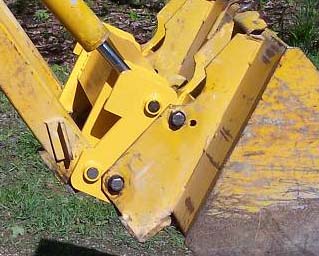

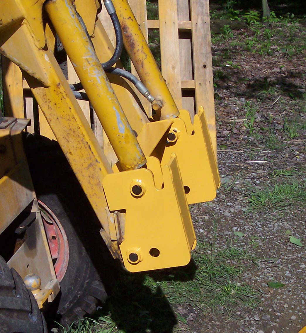

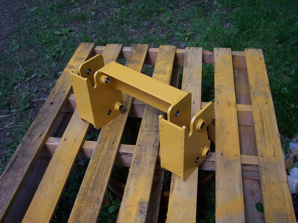

I was checking the fit of the QA yesterday and found a clearance problem. The lower bucket pin hits the bottom corner of the loader arm when dumping. I only moved the bucket forward two inches with the QA so there is only 1 1/8" between the pins (7/8" pins).
I may be able to grind the lower corners of the loader arms but I want to study it a little to make sure I don't weaken it.
