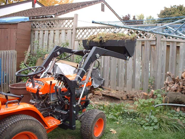

I have pretty much finished building my loader. I am surprised how well it ended up working not knowing how well the stock Hydralic pump would work. I am new to this list and will try and post some pictures. Cost about $1,200 Cdn to build the loader. Dave D.

Excellent work. That looks like a factory built loader. Did you use CADPlans.com plans or was this a design of your own?
   / Loader Project
I did not have any particular plans. Just looked at a whole bunch of loaders, including the Kubota BX22 which has a single bucket cylinder. I did not quite position the bucket cylinder correctly and had to weld in some tabs to prevent too much of an angle on the bucket. Some day I will remount the top end of the cylinder so I can dump at max lift. I also worked real hard to keep the belly mower so was unable to go to the rear with the sub frame, instead bracing the vertical supports to the front frame extension.
Thanks for the comments. Dave D.

I was glad to see that you re-inforced the elbow joint of the booms. I see so many people building loaders for the grey markets and they don't put any re-inforcement there. Their's look like they could snap at any moment.
