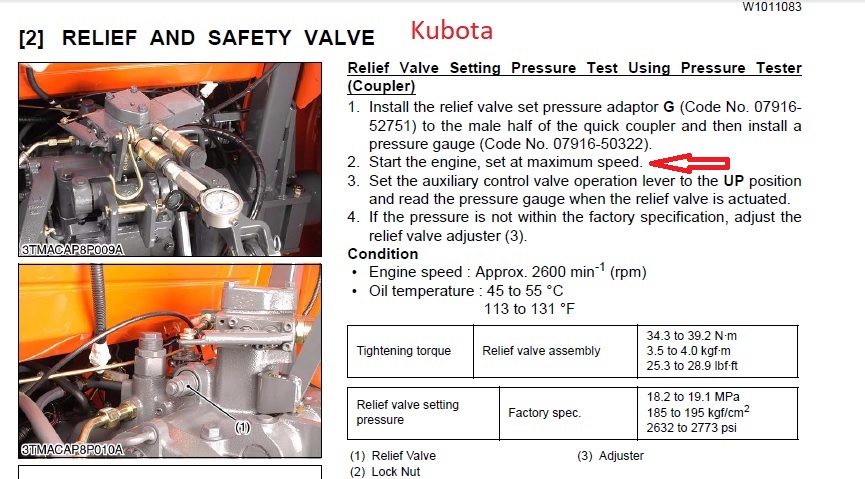

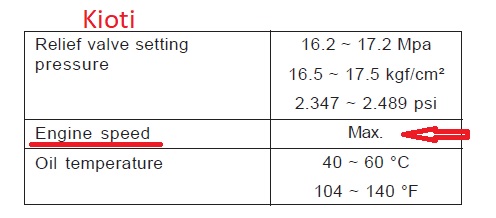

You do NOT need the loader to be operating to see the relief valve setting.
Plug in the gauge, rpm's at max and send pressure to the gauge for a couple of seconds only.
I have attached Kubota and Kioti's test procedure for rear remotes to reassure you you do not need the loader to move to see the pressure setting.
Dave M7040
Dave M7040
Thanks Dave, that was very helpful. I appreciate it.
