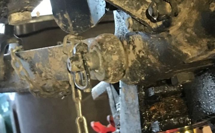

Would seem like the most obvious place to connect at the rear would be where the lower 3PH arms attach to the tractor. But you've probably already checked that?
Edit: This video shows a koyker loader on a FarmPro with the straps mounted but can't tell where they attach at the rear:

I did take a look. The bars aren’t long enough to reach and the holes in the bars are smaller than the pins. Thanks for the video.

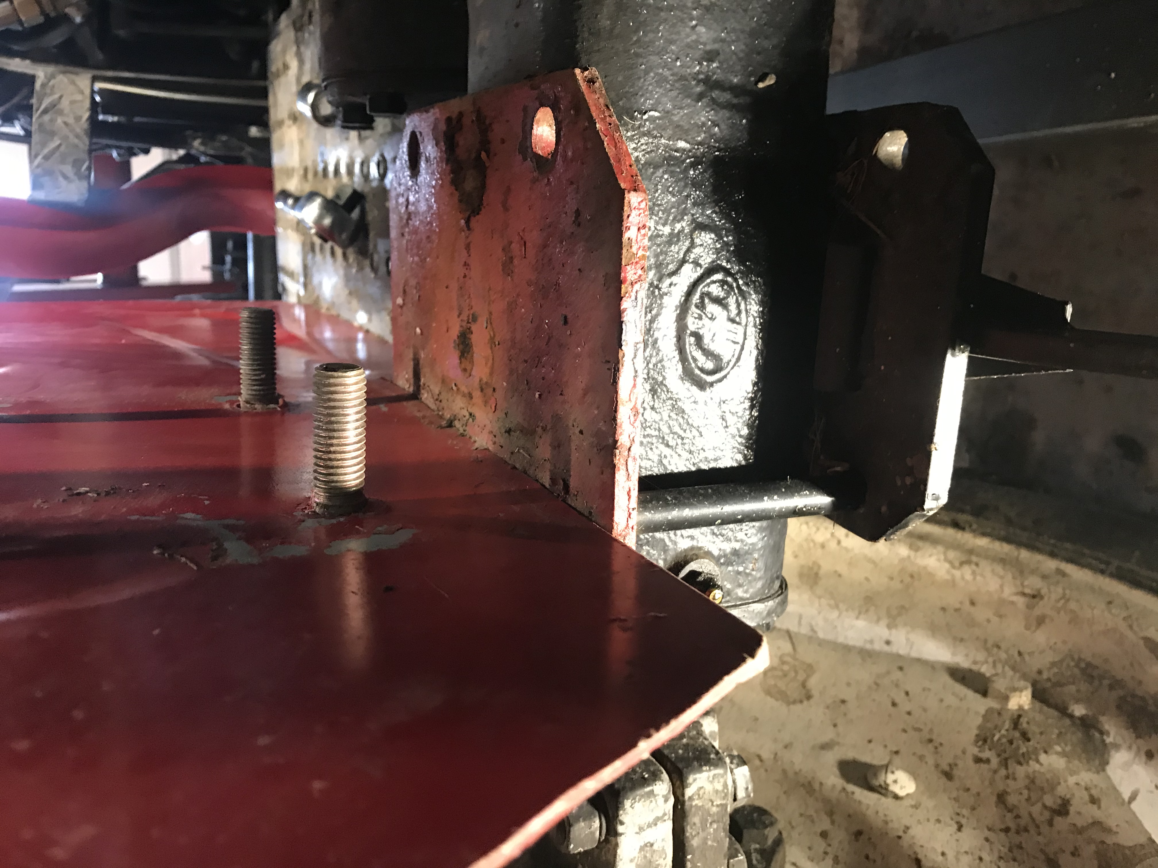

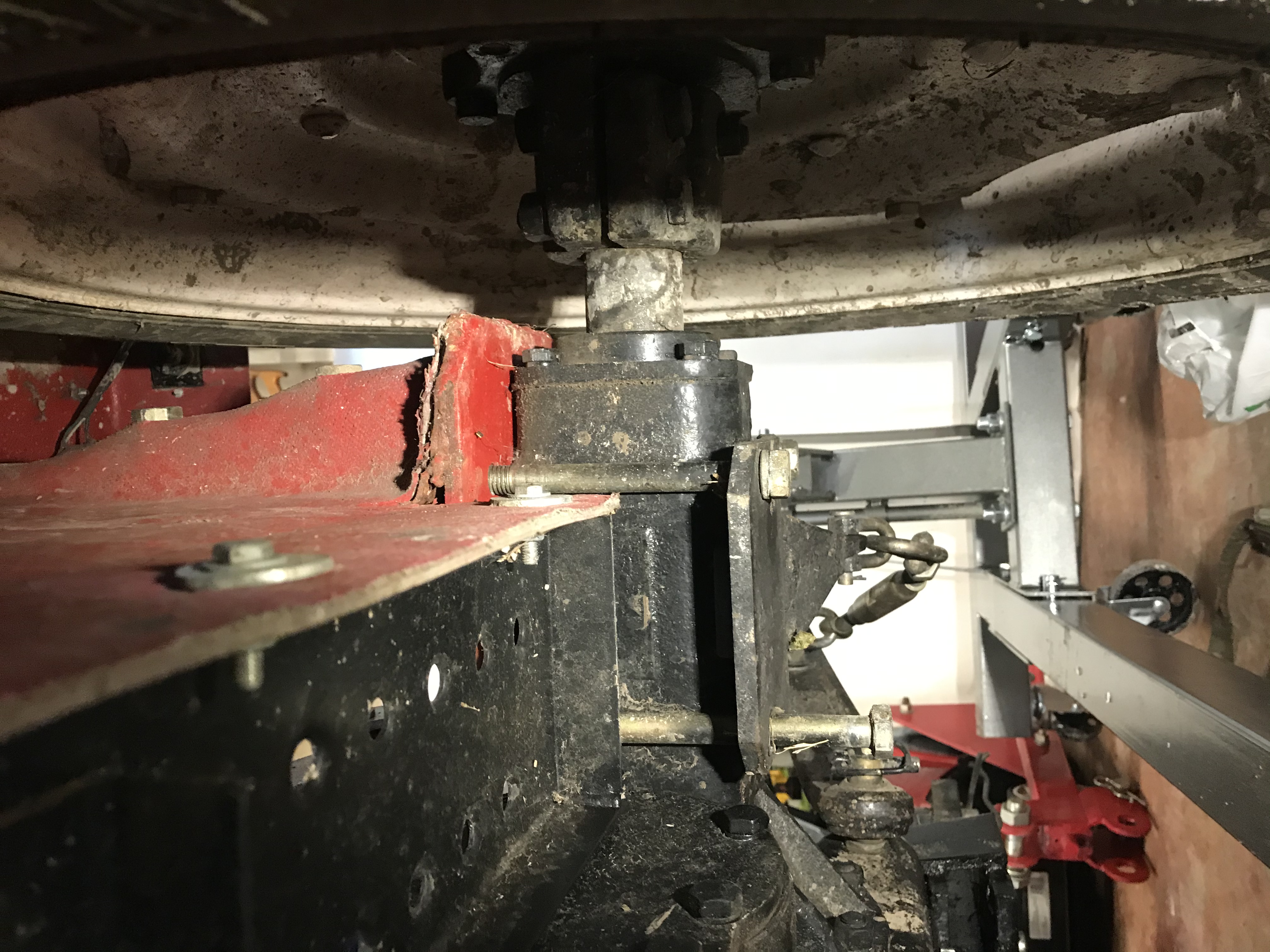

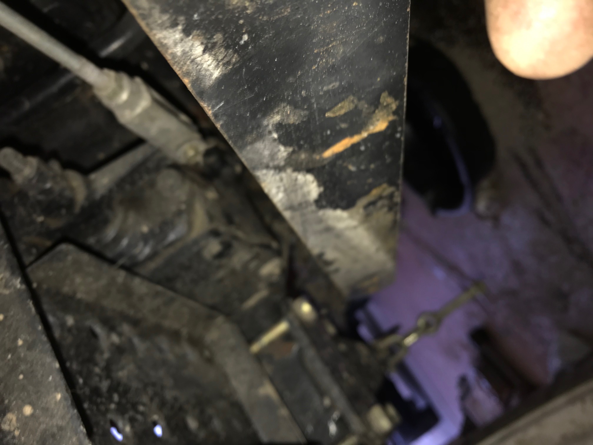

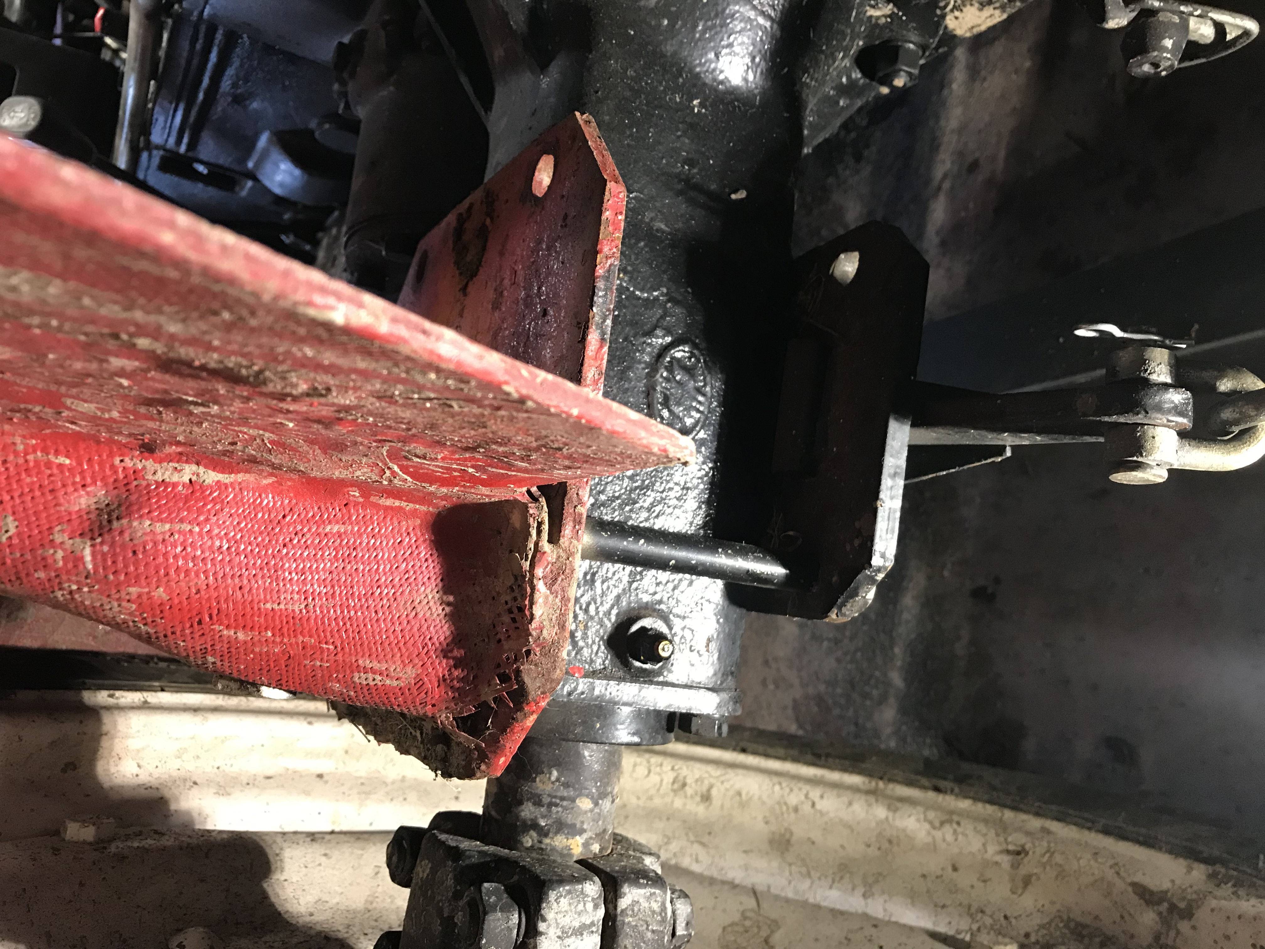

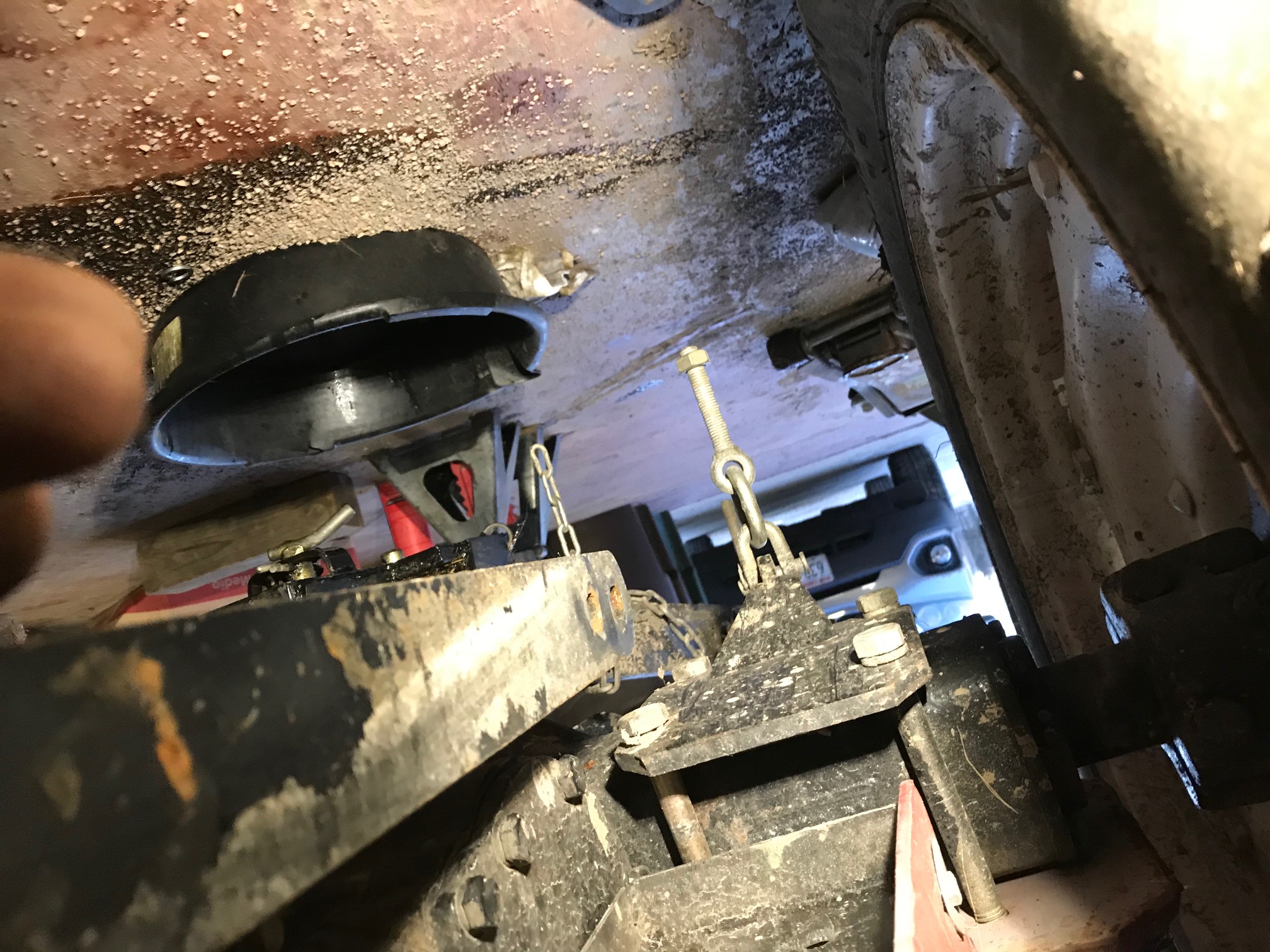

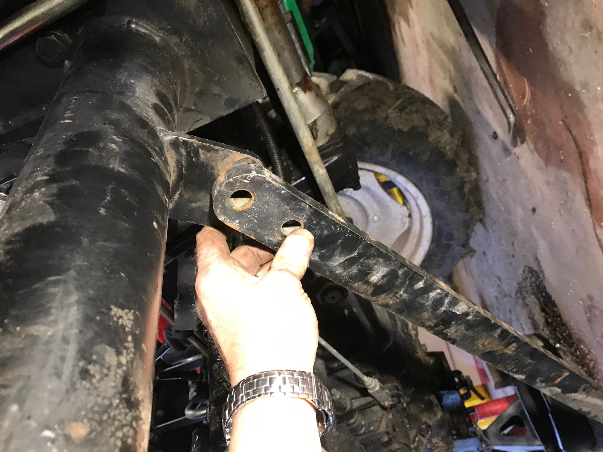

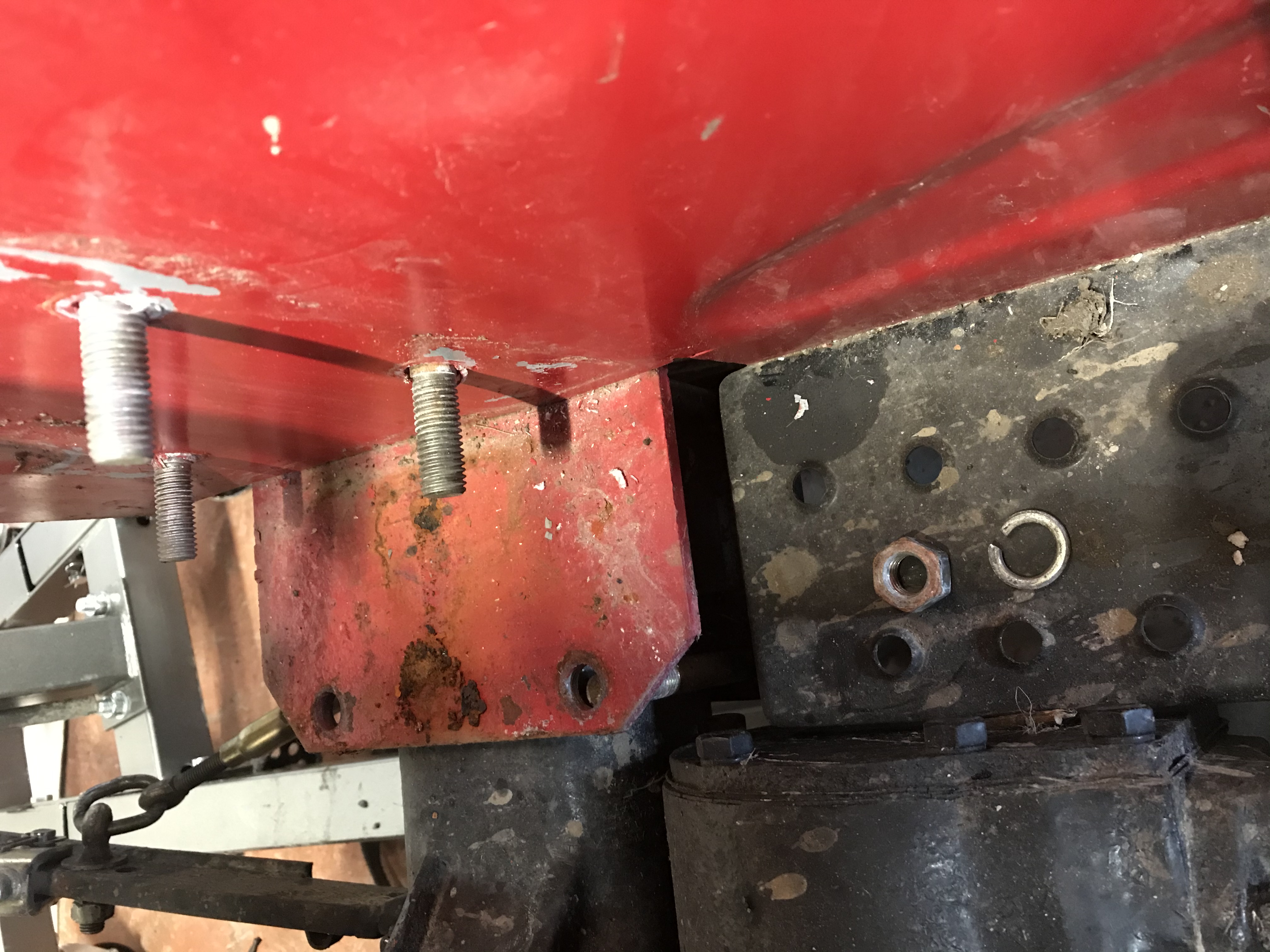

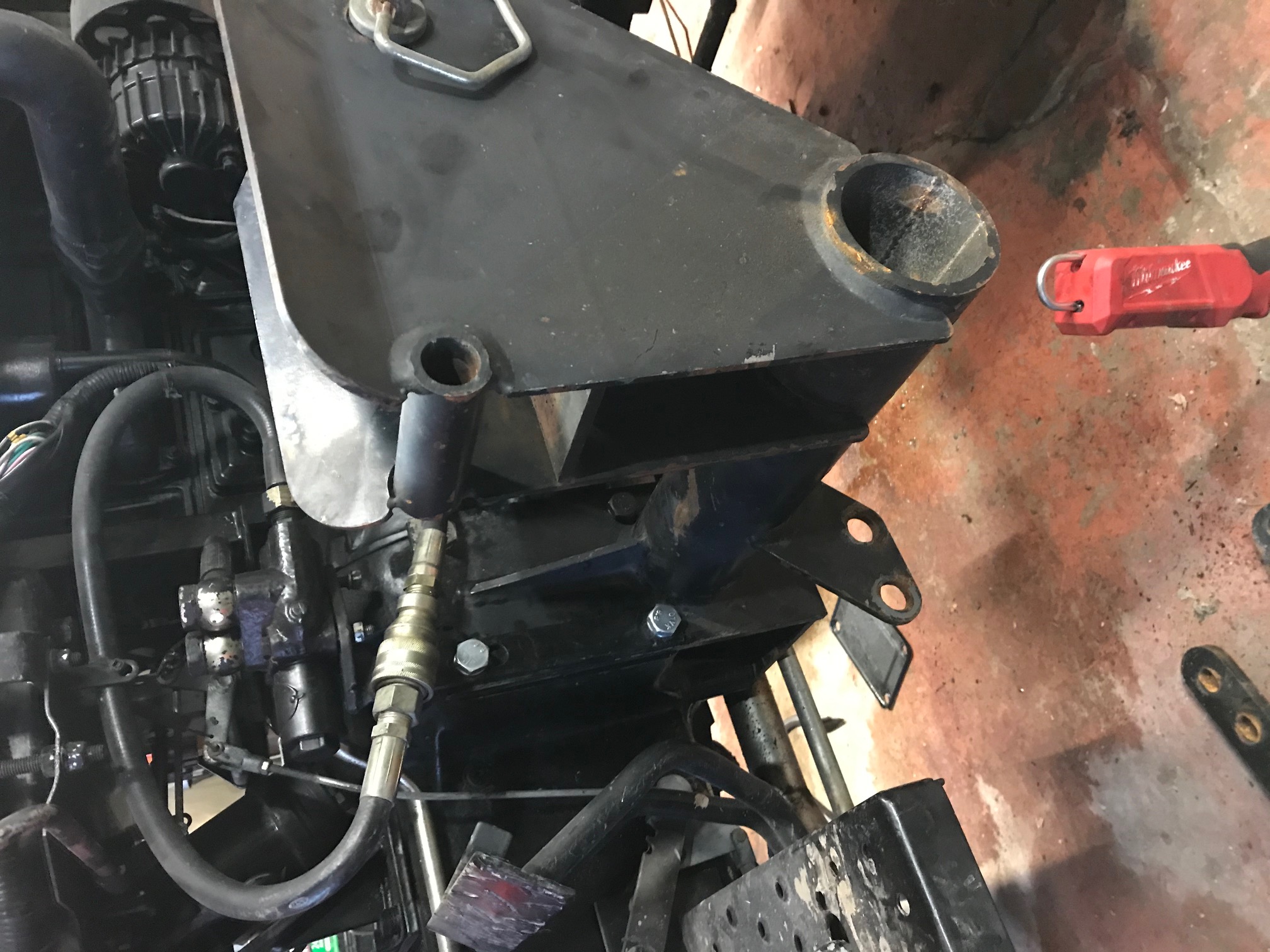

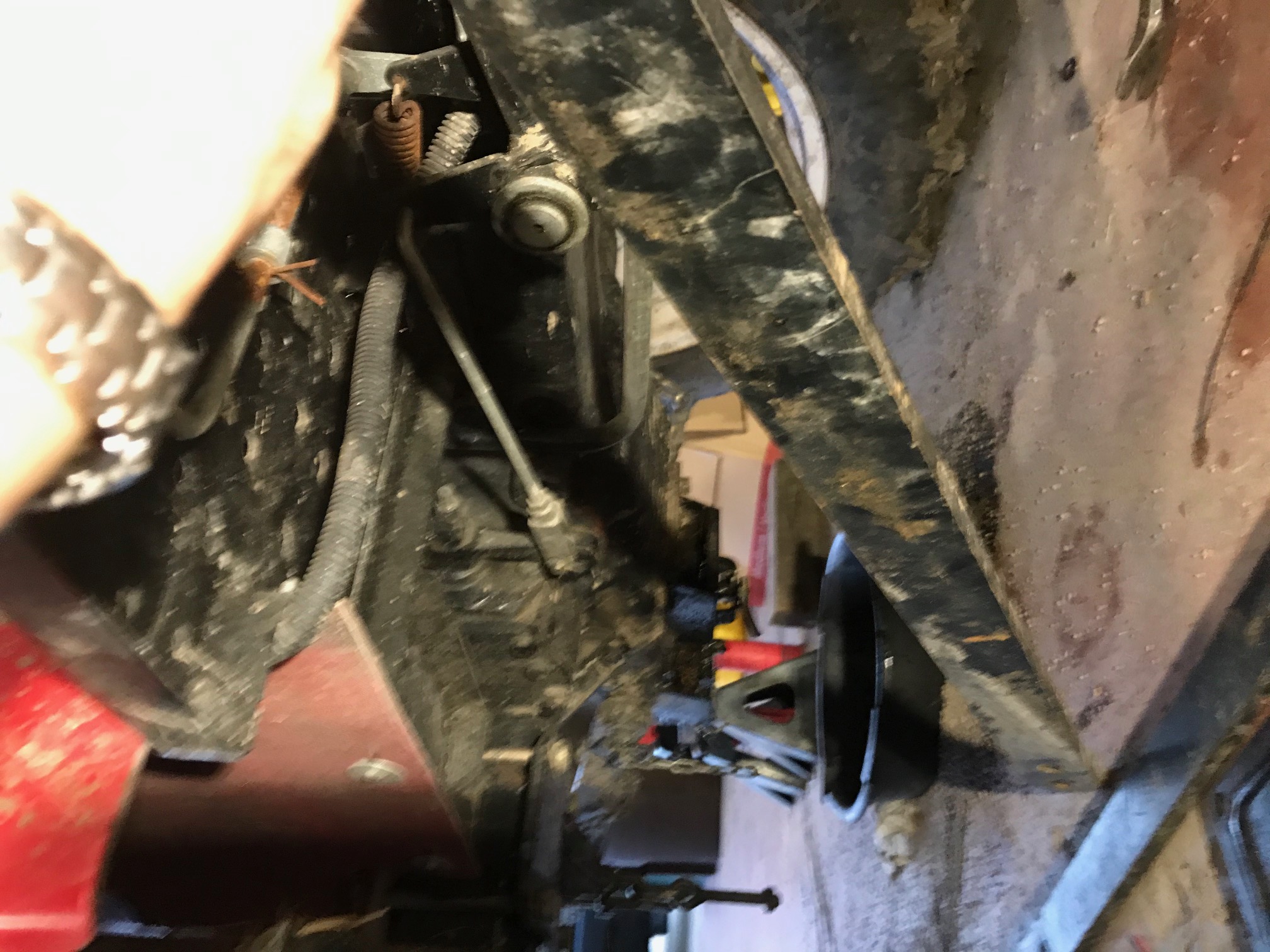

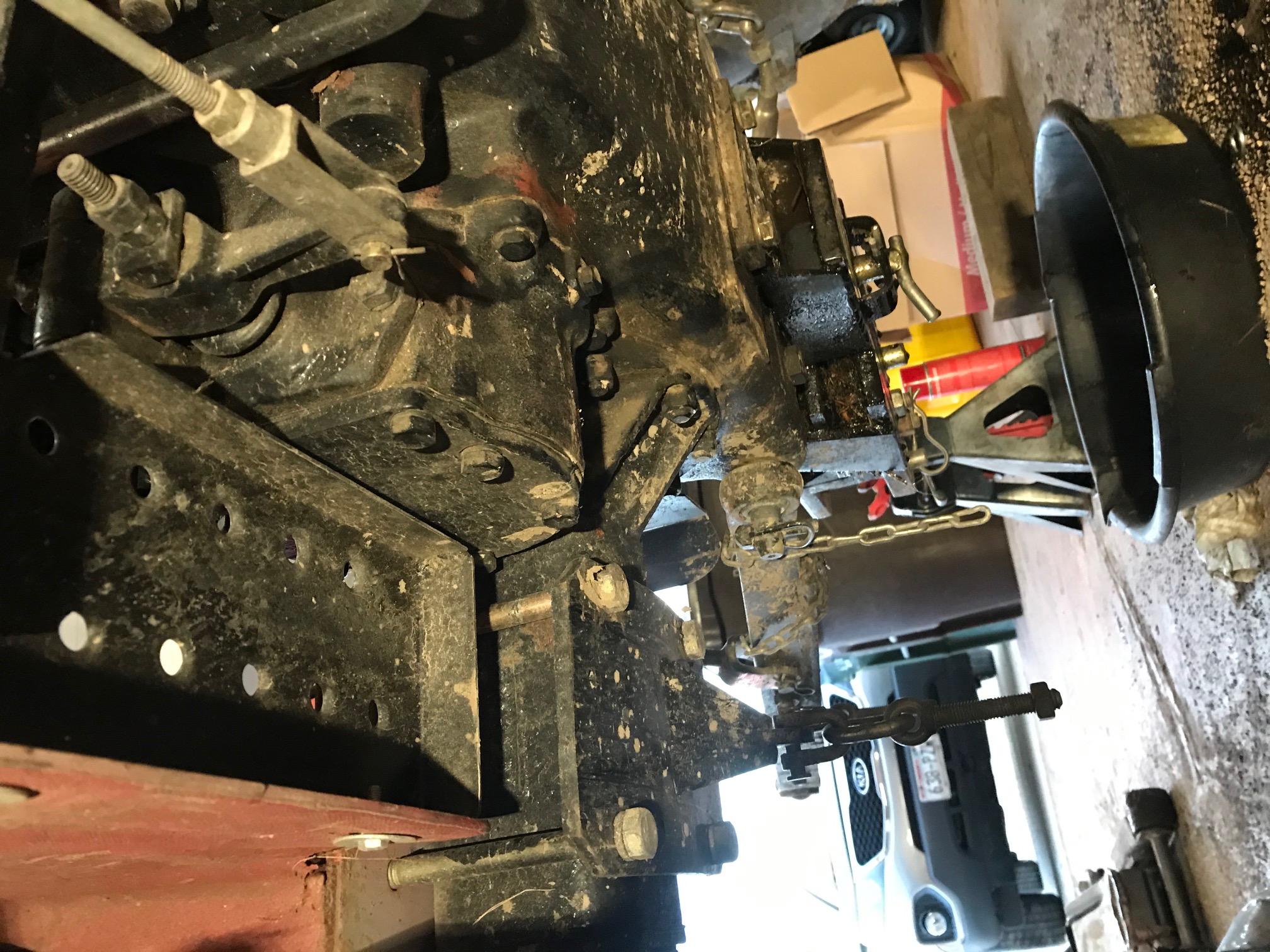

I finally received the axle brackets I need but before I wreck something, has anyone removed these brackets before? I thought I could take off the rops and expose the 2 outer bolts but no dice. The fender covers them up. Is the fender separate from the upper axle plate and can I just pry them apart?1564C94E-E956-4130-B12F-F1C06D5648E4.jpegAC2BC9A7-6580-40BE-92C5-3748452DFEC9.jpeg87602287-364F-4EB2-8C45-37343615E36D.jpegE7E10AB5-3482-4395-8A6A-B1CA4388CC27.jpegC544A01A-F9EB-4C2B-BBF3-8BEC2BBC3286.jpeg8336962F-88D8-494A-8FCF-046D6AB5C758.jpeg1564C94E-E956-4130-B12F-F1C06D5648E4.jpegAC2BC9A7-6580-40BE-92C5-3748452DFEC9.jpeg87602287-364F-4EB2-8C45-37343615E36D.jpegE7E10AB5-3482-4395-8A6A-B1CA4388CC27.jpegC544A01A-F9EB-4C2B-BBF3-8BEC2BBC3286.jpeg8336962F-88D8-494A-8FCF-046D6AB5C758.jpeg
   / Loader mounting question Jinma / Farm Pro 2524 #9
I wouldn't try to pry the fender from the red plate. It appears that there is fiberglass involved. On my 284 this was all one piece with the fender when it came out of the crate.
The bolts that hold the black plate to the fender plate (and ROPS) have two that are threaded into the fender plate. These are installed with the bold heads down, no nut on the top side as it is a hidden location. There may be a nut welded inside or the plate itself may be threaded, I don't remember. The other two use nuts and lockwashers with the bolts being installed with the head up and the nuts on the bottom.
You should be able to just unscrew the upward facing bolts and drop the black plate off, no need to remove the fender or ROPS.
