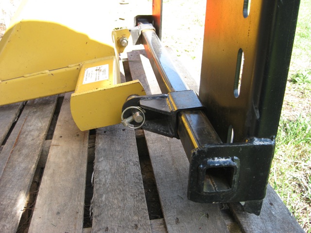

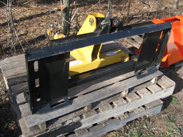

A few years back I too was looking for a way to attach 3pt equipment to my loader. Since I have more then one attachment I wanted to use and the pins on the equipment are spaced differently, I needed one that was adjustable. This is what I came up with. I took the plans to a local fabricator who eagerly made one up for me at his cost, and now sells them locally here. It is all welded up on a quick tach plate so it fits most later model tractors/skid loaders. The pin holess can be adjusted to any width. I have had very good luck with it. I use it all the time with my boom crane and boom pole. It is strong enough to lift anything my tractor is capable of lifting. It is probably not the best picture of it. If interested I can get some more close up's.

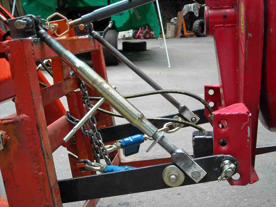

That's a great idea. I would like to see close-ups, too. It looks like you
have some square tubing with a bracket welded to slide on the outside of it.
My FEL 3-pt hitch just uses arms, links, and sway chains, just like on the
back of a tractor.

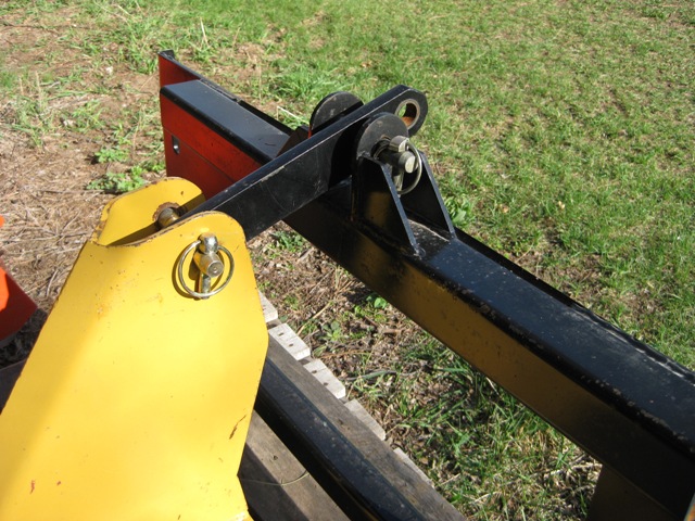

Here's some close ups. It started out as a regular quick tach adaptor plate available everywhere. Some square tubing and some plate material. And an accomplished welder and this is what I ended up with. The only thing I would change is that the top link hitch assembly, I would have welded to the front of the square tubing. This would put it closer in-line with the lower links. But other than that it has worked great. We were both a little concerned about side ways slipping, since there is no way to pint the lower links at any given width. But it has not been an issue. Once you get the weight of the implement on hitch, it pretty much stays put. Let me know if you would like any other views.
