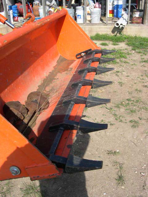

Here's what I did... There are 5 chain hooks. One in the middle (orange) and one on each side (silver) that are catch hooks. There are also two slip hooks (silver), one on each side. I positioned them back away from the loader edge so I can place items "flat" on the loader without hook interference.
also, you see my tooth bar.

Hey, that's nice - I hadn't thought about a toothbar - And good idea to keep the hooks back a bit so as not to interfere with keeping something flat!

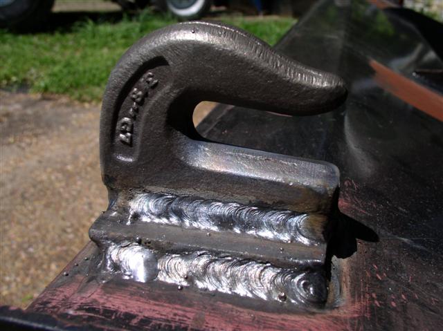

If you add hooks just make sure you tie the hooks into a structural element more than just the bucket skin. I used a base plate too tie into the front tube and put the bent down skin in tension vs. peel. A bent strap arrangement would have been better.

Wow, that is a really nice weld.
I'm not sure what you mean by a bent strap arangment.
Are you saying to use a bent strap rather than a hook or are you saying something else?
   / Loader Modifications #6
Rather than a plate under the hook like in my pic I could have used a longer plate more of a strap. This will help tie into the bucket end plate.

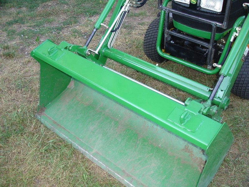

I added buckets hooks to mine.
I didn't like the ball on bucket ideal because I could not see it on mine. I added a HF quick hitch. I built a frame for my tow bar and painted JD green. Ended costing me a hair over 100 bucks.

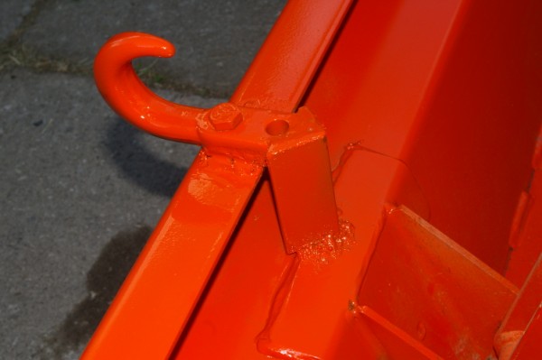

I used angle iron to give mine strength..
